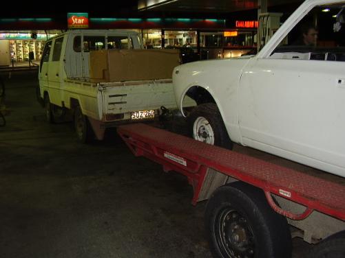

heres a pic (not a very good one though) of the vehicle in question.... did two trips to canberra (with a few engine issues) successfully towing that trailer to bring two cars back....
went up lidster hill on the cargo road in 2nd gear as I wasn't flogging it hard (scared of it overheating at the time)
