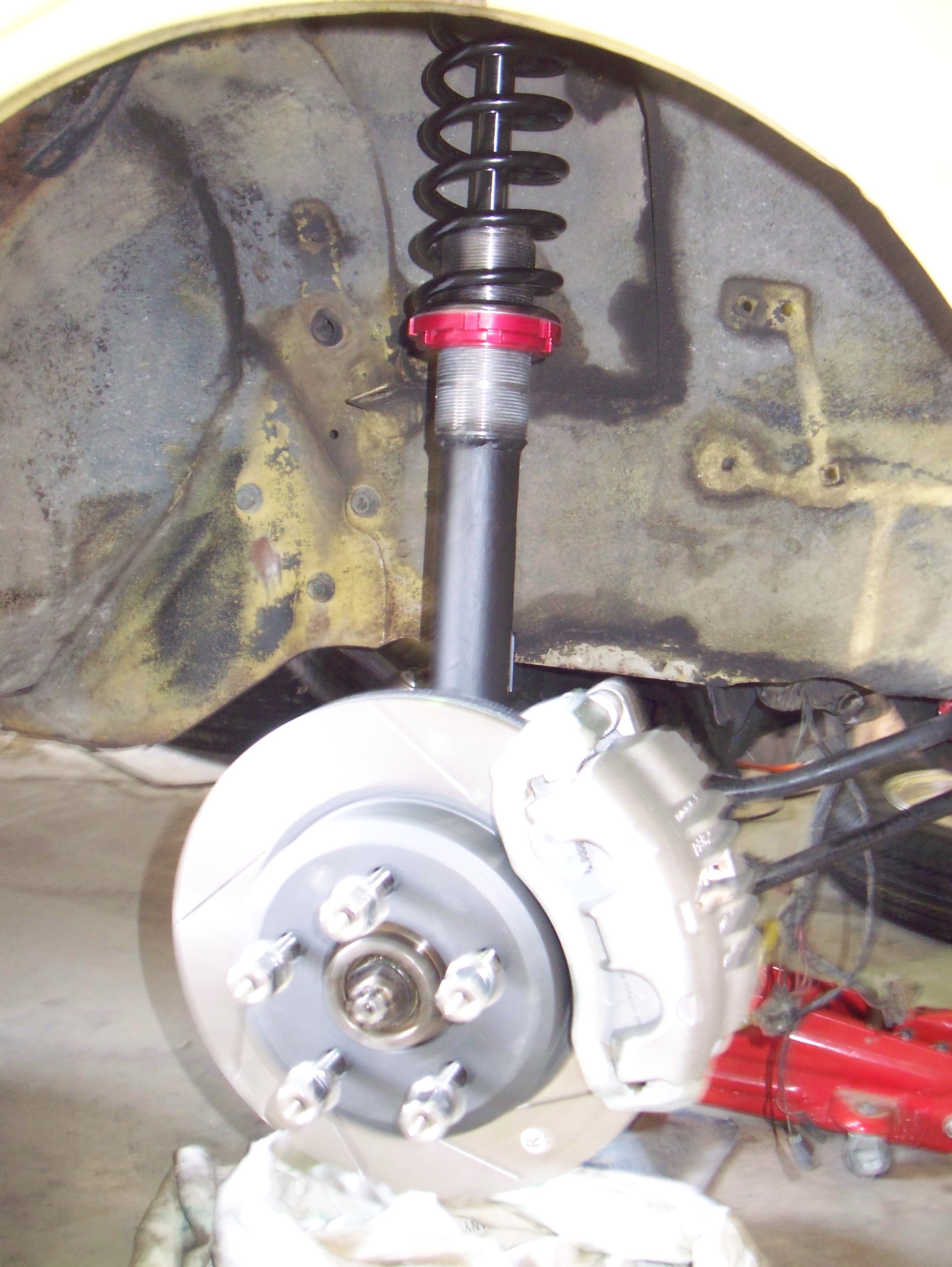

September 12, 201016 yr comment_468020 if you want to go that bit extra, heres a pic of my brakes + struts....hopper stoppers brake conversion and otomoto sleeve kit onto the standard ke26 struts Edited September 12, 201016 yr by sikke20 Report
