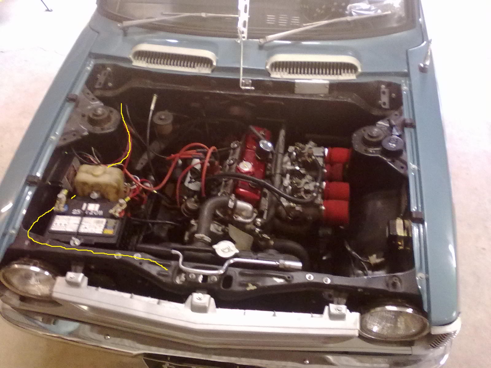

Can any one post a pic of how their bonnet cable run's in a KE2#?
I wish to install one in my TE21 on the right hand side of the car.
I don't know were it passes through the fire wall etc as it snakes it's way to the front.
Thanks
Shane
It feeds through in the same hole as the rest of the lume, runs around the strut tower, behind the battery and along the under side of the rad mount.
Thank you gavin,
so it pass throught the same hole in the rubber as the loom?
