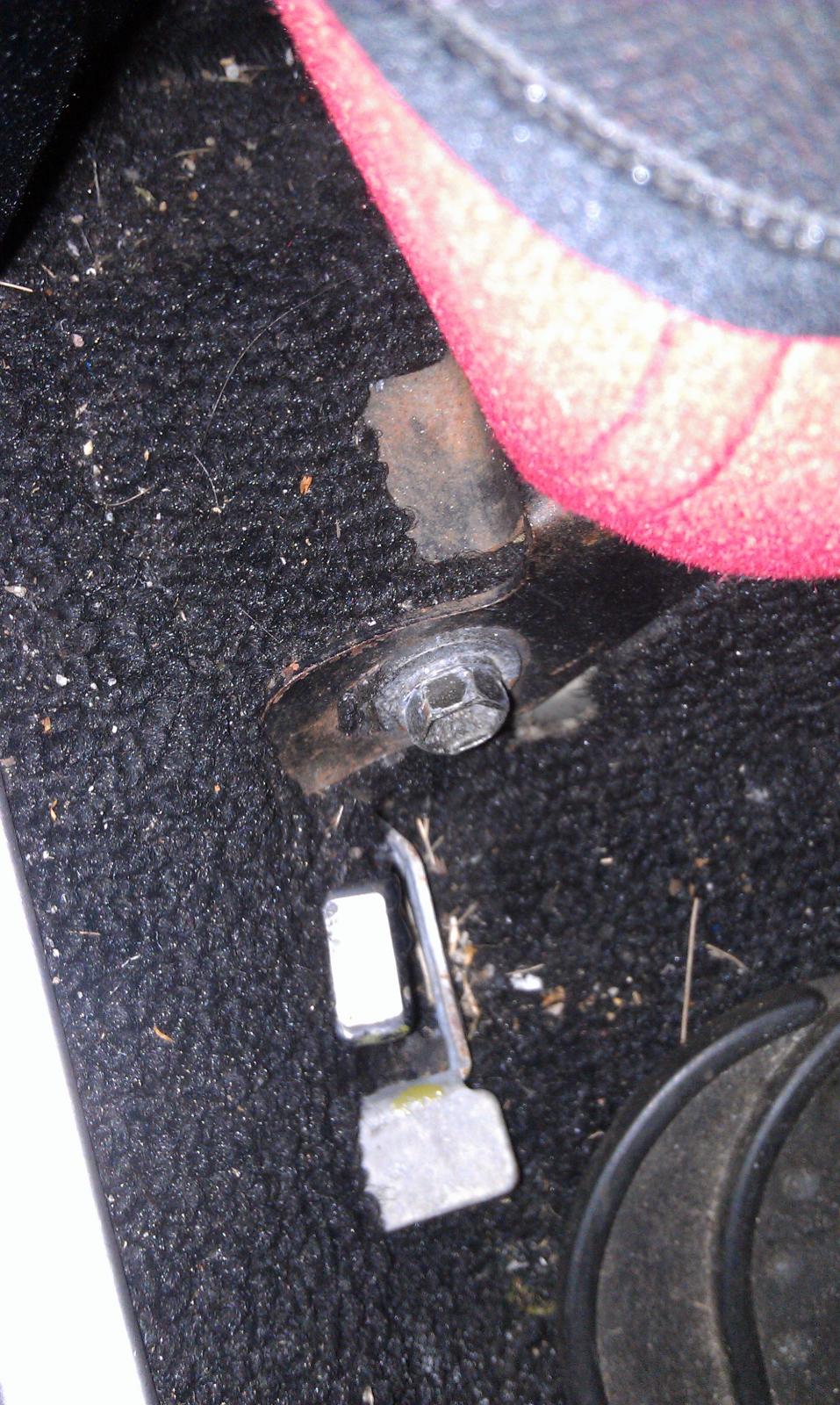

It bolts to the chassis under the seat.

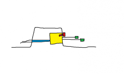

There are 2 holes, one with a tread and one hole to align the mechanism with the threaded hole. There is the part where the seat bolt goes, the mechanism sits inside the raised hollow beam with the levers sticking out and you bolt it from the outside. You feed it in from the rear towards the front of the car.
Unfortunately I didnt take any photos of when I did mine.
You will need to remove the seat and carpet and cut a small hole in the carpet for the popper to stick through
Yellow, mechanism
Blue , cable to rear
Red, bolt
green, levers
