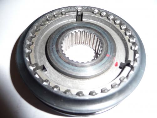

Hi Guys, To provide an update on this thread I ordered the 33395-14013 Sleeve from Amayama in Japan as they indicated that it was in stock. Turns out that the alternative 33395-26010 was the only part available. It was dispatched in Japan on Saturday and arrived in Newcastle yesterday (Tuesday). Very impressed by the delivery time! Whilst the sleeve is different to the original, initial expectations are that it will do the job. It fits the inner gear and the 5th gear side of the sleeve looks the same. The reverse gear side is not machined like the original and looks more robust. Perhaps to make it last longer where subject to abuse. Will try back in the box on the weekend and see how it goes.

Hi Twinky, Yes definitely a question for someone who has experience rebuilding these boxes. I just received confirmation this afternoon that both the 33395-14013 & 33395-26010 are available from Amayama in Japan at around $90USD each + shipping so will probably buy & try. I have attached a picture of the sleeve in case anyone else reads the post. In it you can see where the teeth are worn down on the edge.
