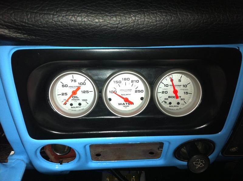

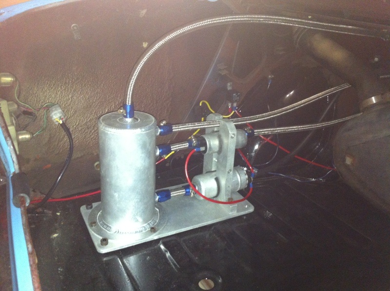

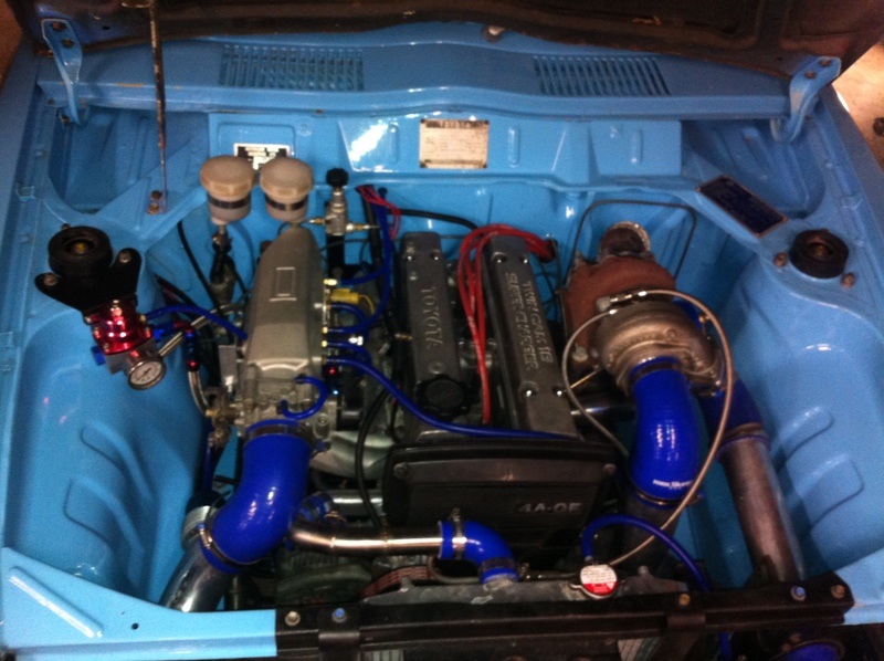

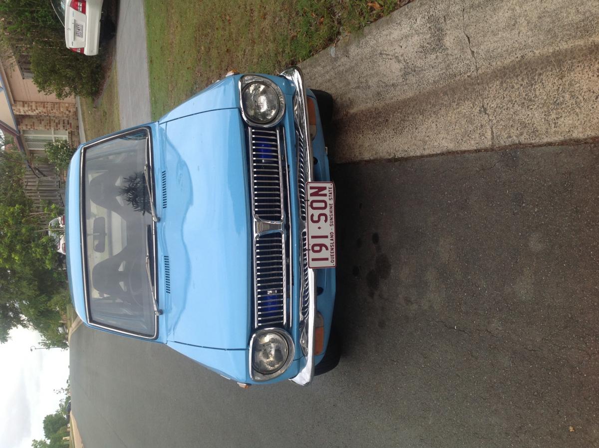

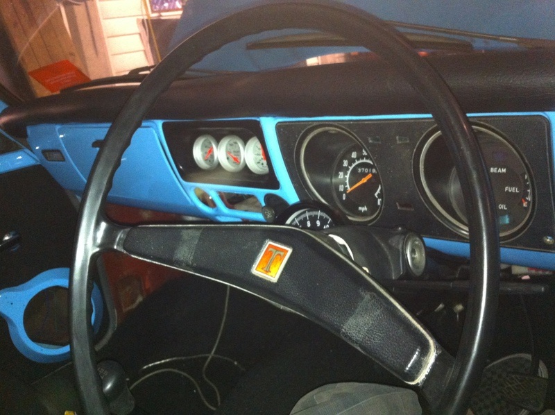

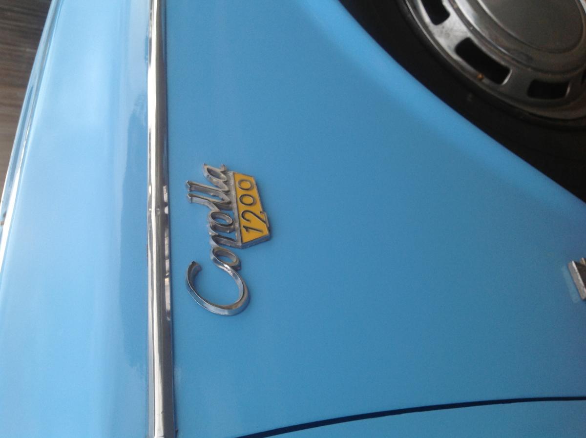

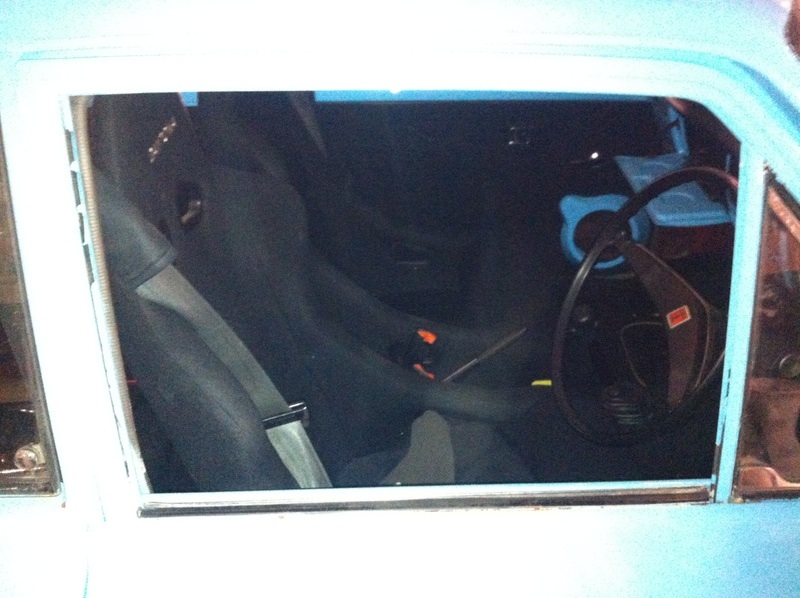

  11. Hi all, Seeing as I've been coming to this forum for god knows how long, and finally have a Toyota!, I thought I'd start a build on the ke11 I bought about a month ago off a fellow rollaclub member. So it's a 1970 ke11 been resprayed in sky blue 13in Mazda wheels with hubcaps Lowered 2in all round (I think) Ke70 brakes up front Ke20 collapsible steering column and steering box Twin circuit brake master cylinder Has the original corolla 1200 fender badges Front mount cooler hidden behind grill 4agte (4agze bottom end with bigport head) Ross forged pistons 4agze rods ARP main bolts and head studs Comtect steel 1.8 head gasket Acl race bearings T25 turbo Custom manifold 38mm external gate Turbo smart BOV Custom air box Alloy radiator and thermo fan Fuel pressure regulator T50 gearbox Megasquirt computer with resister board Lc1 wideband O2 sensor and gauge Auto meter boost oil pressure and water temp gauges Daytona buckets seats Surge tank Vl turbo fuel pump Carter lift pump All braided fuel lines There's probably more but you get the idea. Plans for the future. Complete stock interior All body work and fresh respray. Shortened yr22 tarago diff with altezza 2way centre New suspension and steering up front (coil overs etc) Cams Tune And hopefully it'll make 200kw+ atw Matt
