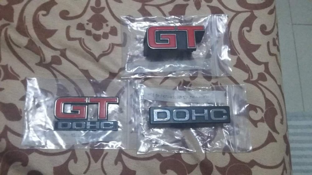

  1. GT DOHC

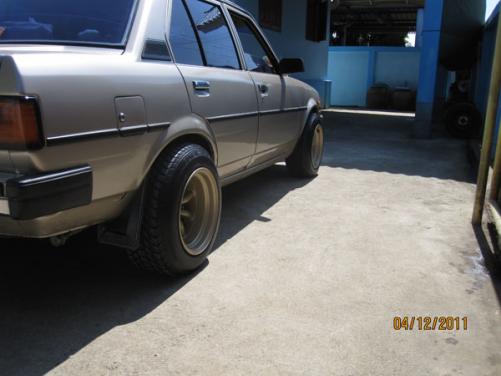

  6. The next item is a wheel with tires, I chose the SSR MK-3 wheels. Front Wheel Style 15 × 7.5J +19 Tire AD08 195 / 50R15 Rear Projection 15 × 8J -0 Tire AD08 205 / 50R15

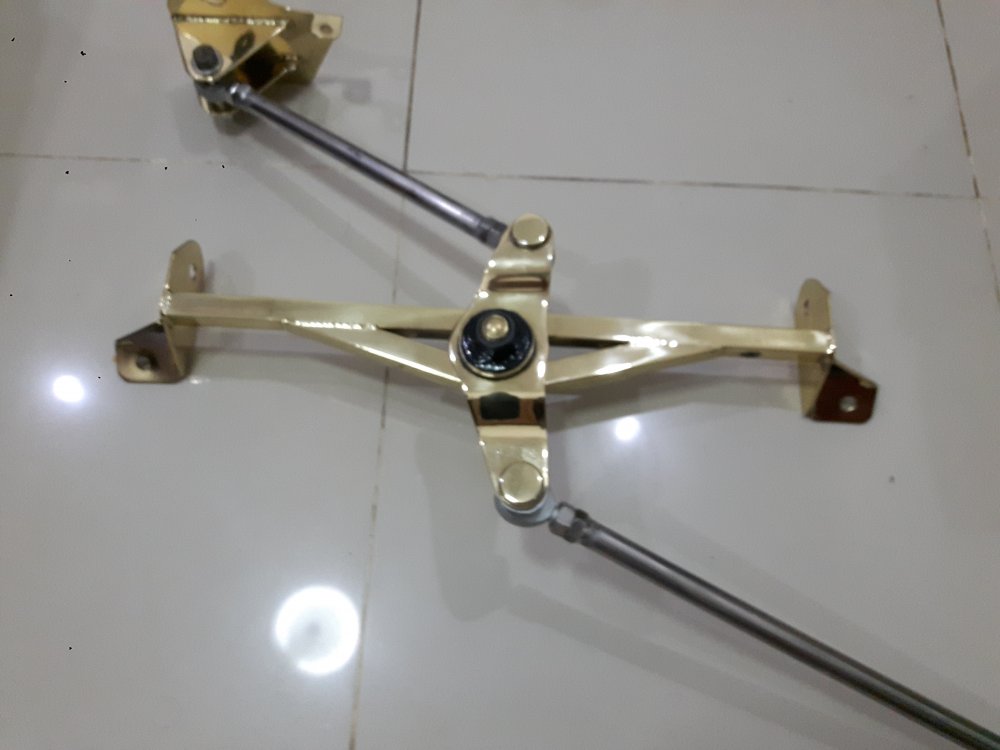

  7. The next item is watt link of SSWork. From Japan By the pros Normal of the undercarriage, hard coil, general coil, time it collapses - stretch It will sweep to the bend. It will cause the shaft to move its left-right side along its sweep. But Watt's link, it will keep the shaft does not move the left-right side better. In the short-term collapse, it will hardly move at all. Improved access to the curve. The disadvantages are only tight. Is very high maintenance

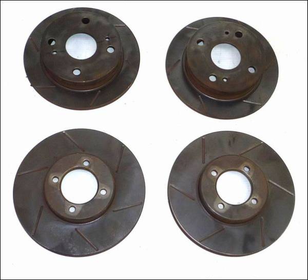

  8. KTS front shock absorber with FC3S brake kit, which I assembled face shocks to fit into the daily use. And brake discs to be used as a mini R53 plate size 276 × 22 mm.
