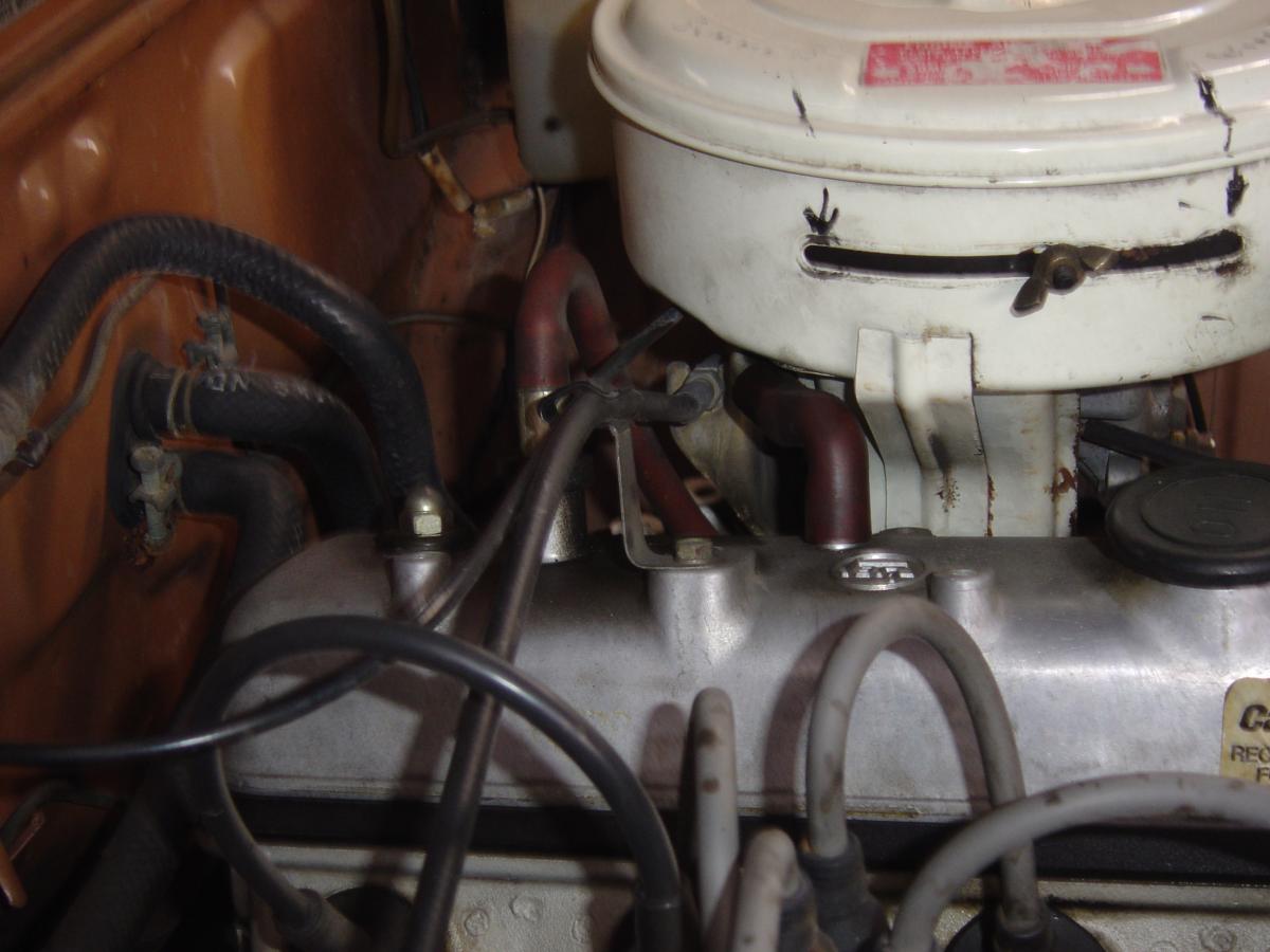

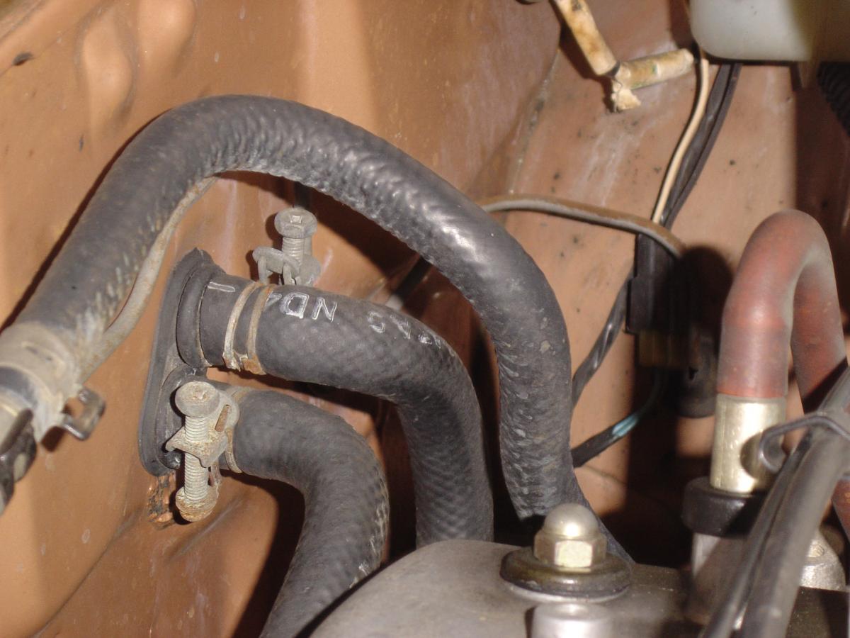

  1. Hi Guys I forgot to mention I don't know why that hose runs back to the rear of the head All the photos I have seen looks like it goes from pump to inlet/outlet on heater down the Carby manifold side. The other hose is down the Dizzy side via a copper tube which is same as I have But I have a bypass hose so that won't work on the carby side

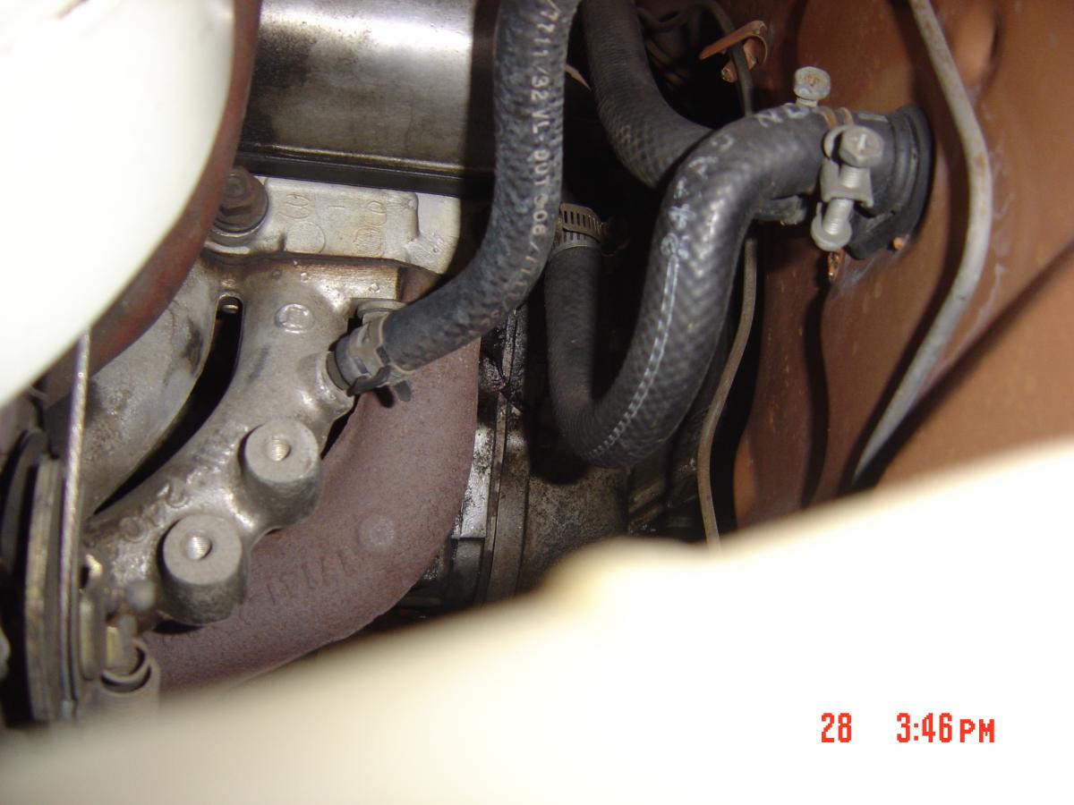

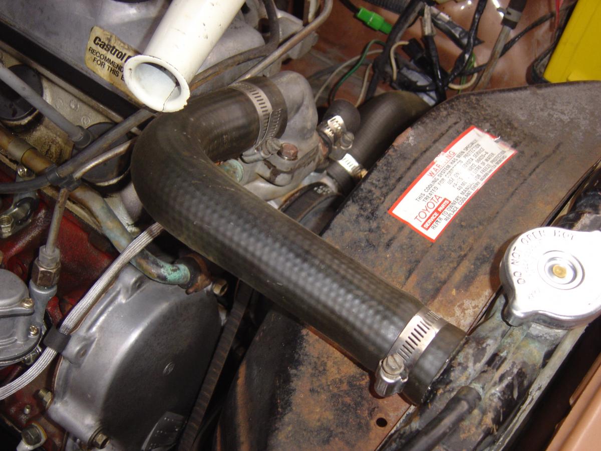

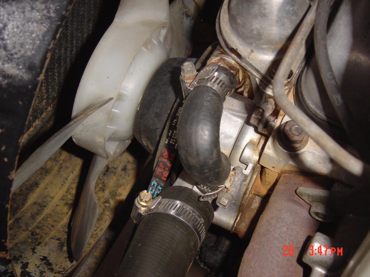

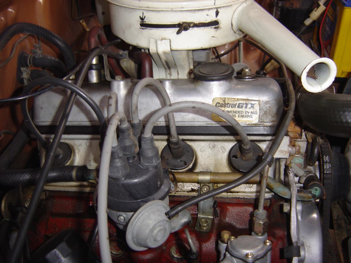

  3. Hi Guys I tried Taz_Rx thought.So I checked this. The bottom WARM slider control is broken on the behind the fascia console. Tried moving the internal control ( near the inlet/outlet on passenger side) forward toward passenger & back towards firewall- after driving around still no heat on either setting. I hope there is no fuse needed for this as I took the fuse that runs the clock & internal lights out. Kept flatting battery when not in use for extended periods. The fan works so I am guessing its not got a solenoid- please don't be so simple!!! I have taken a couple of shots of the engine bay. I'm really worried about getting new heater hoses. Can't find them any where. Do you guys know what size they are OR what do you use to replace them? I've been a bit shy to pull them off in case I get stuck. I am down to one car at the moment. Sorry about the oil & water marks. Had a problem with overheating over summer Oil leak is driving me nuts. Long story but I need a better mechanic - That's what happens when ya get your hips replaced & can't do it your self. I'm saving up for a Engine stand & hoist. Thanks for for input so far John I added another photo
