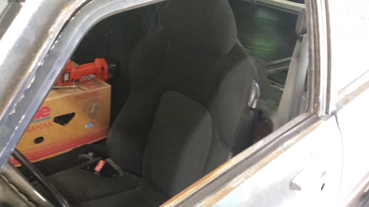

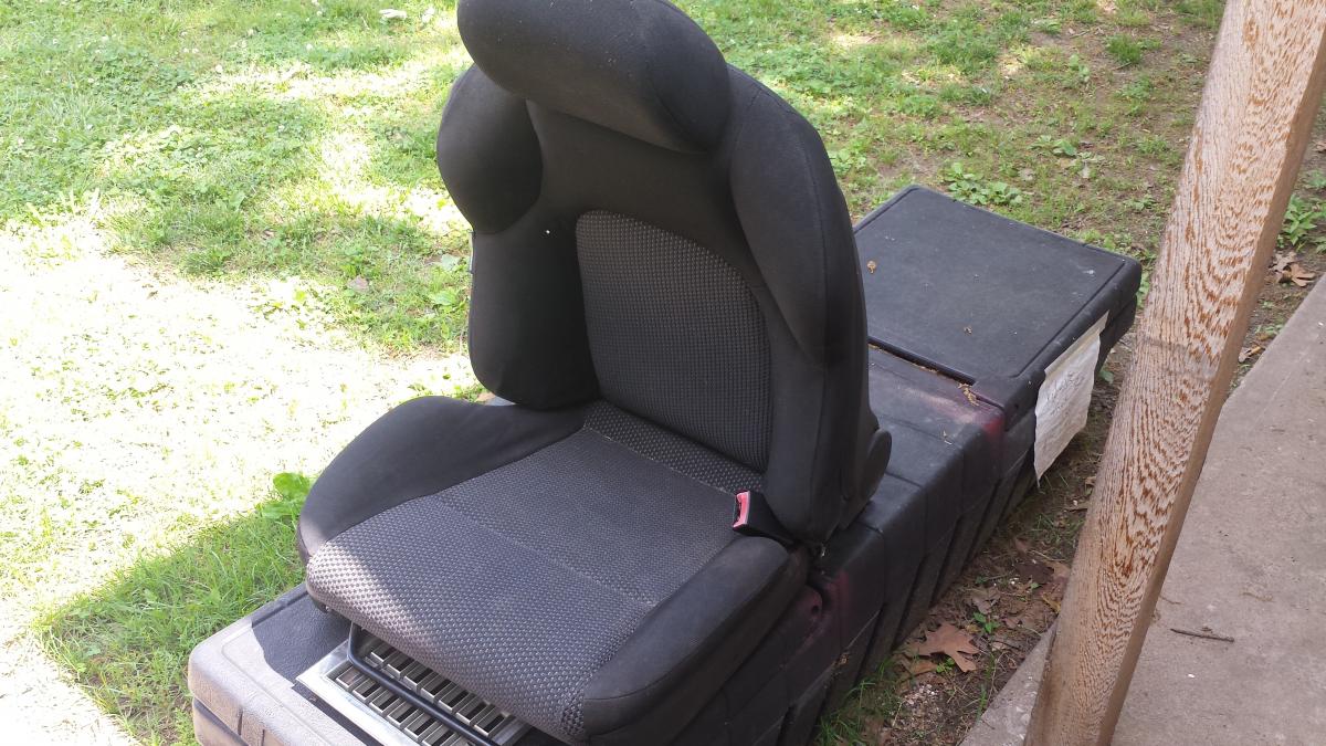

  1. Well I haven't had a chance to update in awhile as it has been slow around here. I did finish up the engine other than a few holes that need to be plugged from removing all the emissions items. I am also building an engine run stand so that I can test the motor and transmission outside of the car. More recently I snagged a new set of seats from the salvage yard out of a hyundai tiburon for 55$ in amazing condition. Great bolsters, lumbar support, and leg adjustments.
