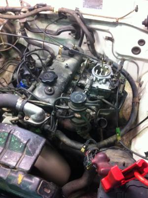

  4. yeah all timing etc set properly and yeah i adjusted tappets as they were noisey as shit. intake were flapping in the breeze and exhaust were so tight i couldnt even get my thinnest feeler guage between. made me think that could have been the issue if valves were open when meant to be shut. i did put a metal rule up against them both and there was bugger all in them. kinda looks like they had been done recently and the gasket was still relatively new. i did use a liquid sealant ontop of the 2 piece. will spray something combustable around all gaskets and vac lines tomorrow to make sure there are definitely no leaks. then pull jets out and see how i go
  5. cheers man had another little play around this arvo as its still not running right. I'm chasing a rather annoying missfire/hesitation at idle. checked plugs, leads, coil, distributor cap and rotor, points and condensor to see if anything was buggered. ended up replacing everything except the coil and leads. this made it run better but still not right :( if i block off the carby a little bit it runs heaps better. so I'm thinking ive still got an air leak somewhere? maybe valve timing is up to shit? could a skipped tooth in the timing cause something like this?
