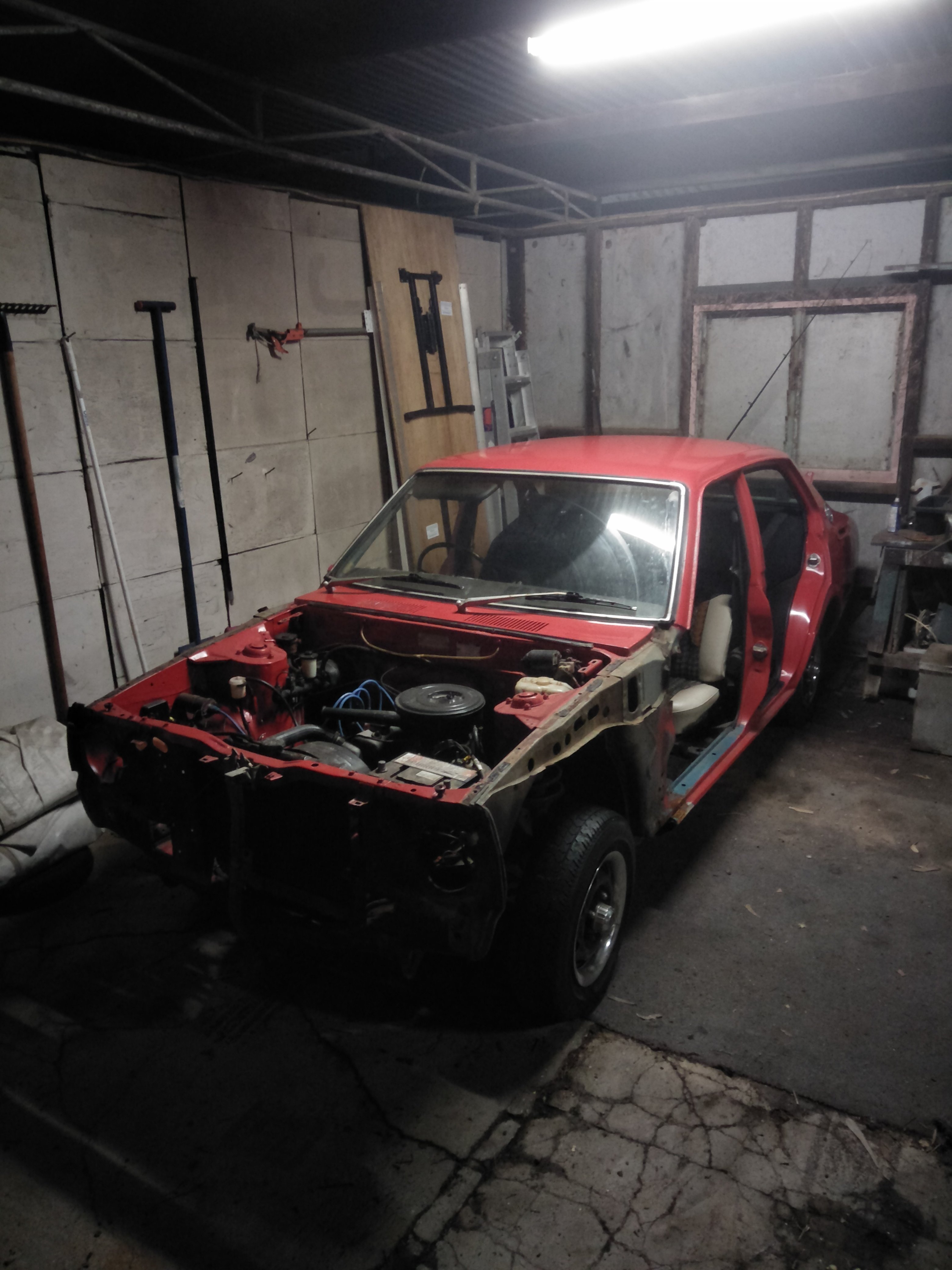

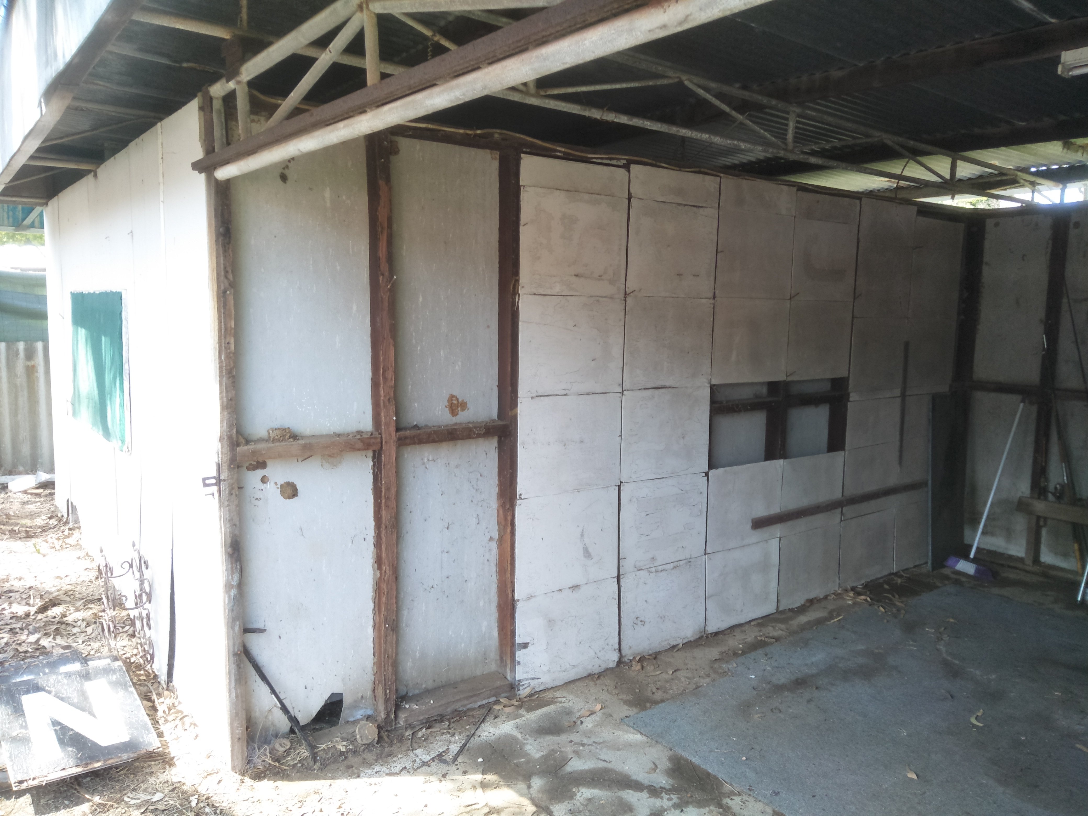

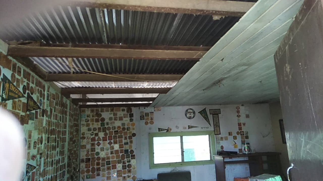

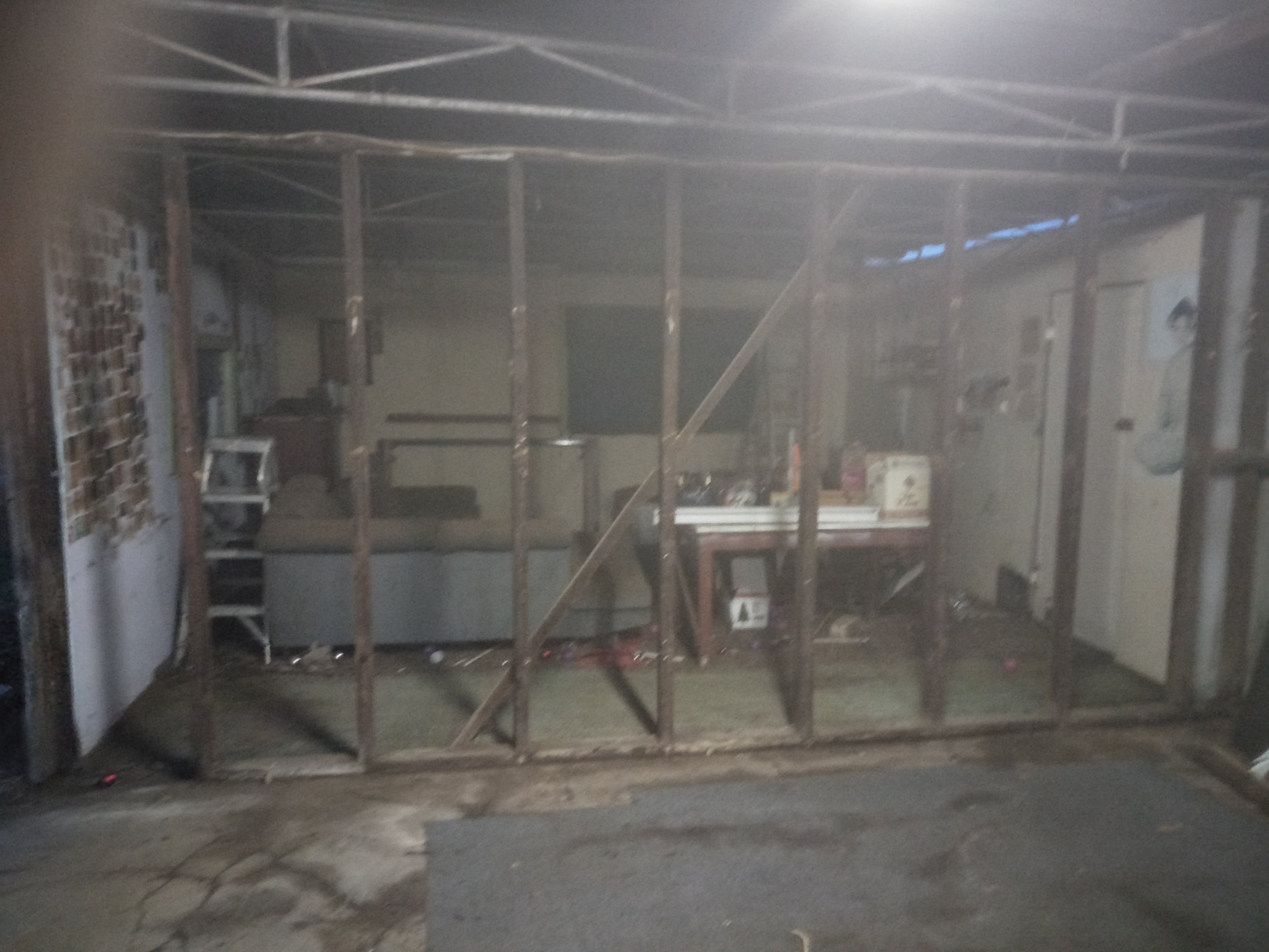

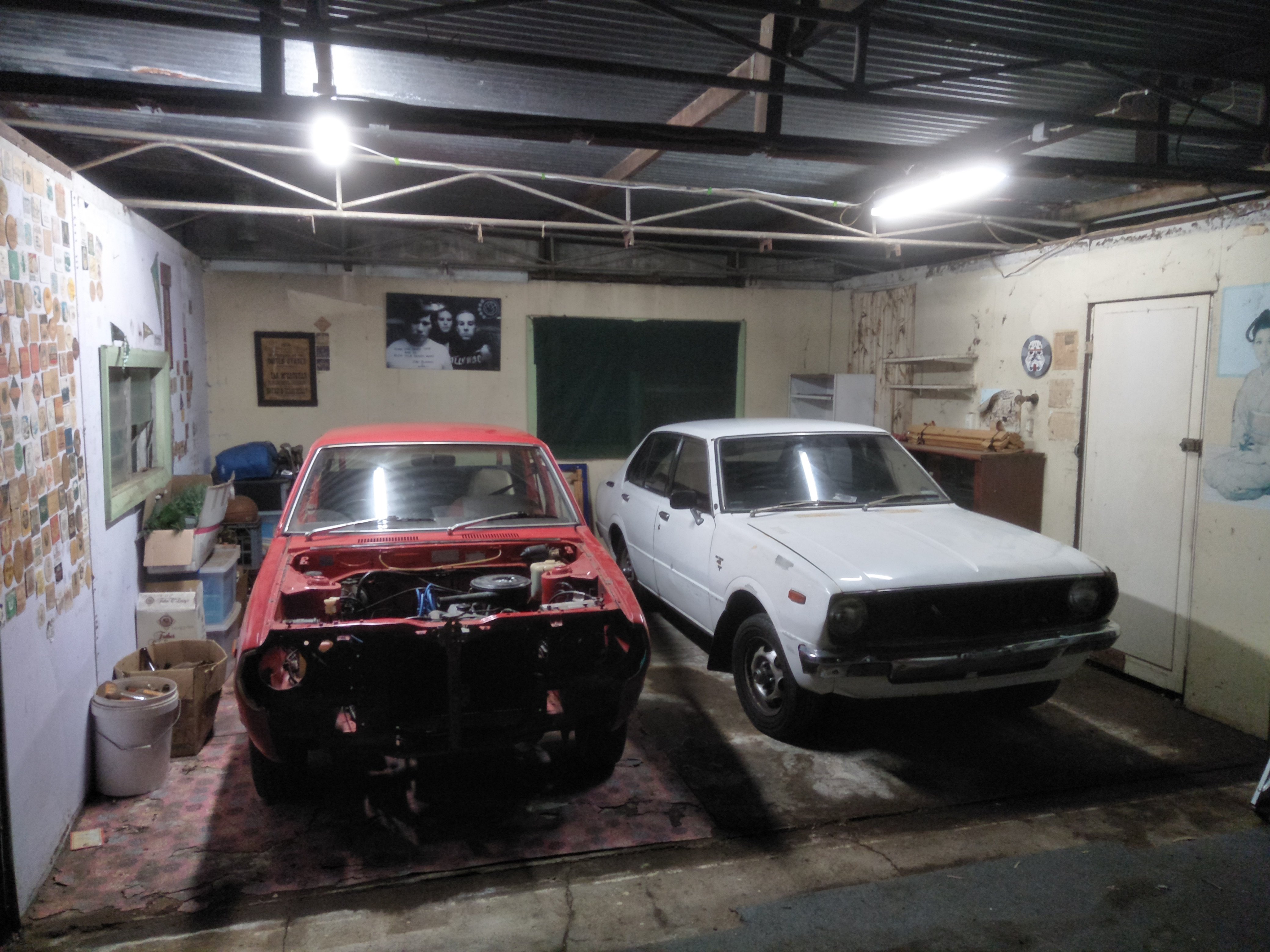

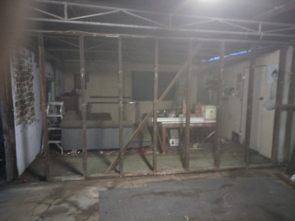

  5. Update (probably the last one for a while) I work in the event industry which will be crazy busy real soon plus cricket season is starting up too. Figuring I was about to have less time for cars and it made harder by the cars being in separate locations I knew had to make more room to bring them together, preferably under cover and under lights. A third of my shed had been converted into a games room which I never really used and referred to as the dingy dungeon. So 36 hours later I had taken out the wall and realigned the lighting to sit above each car plus a massive clean out. It is now reborn as my Rolla room. FYI the red car is the one I'm focusing on as the white one has a lot of rust in the chassis and rear quarters, so it's donating it's doors, bonnet, boot, and interior.

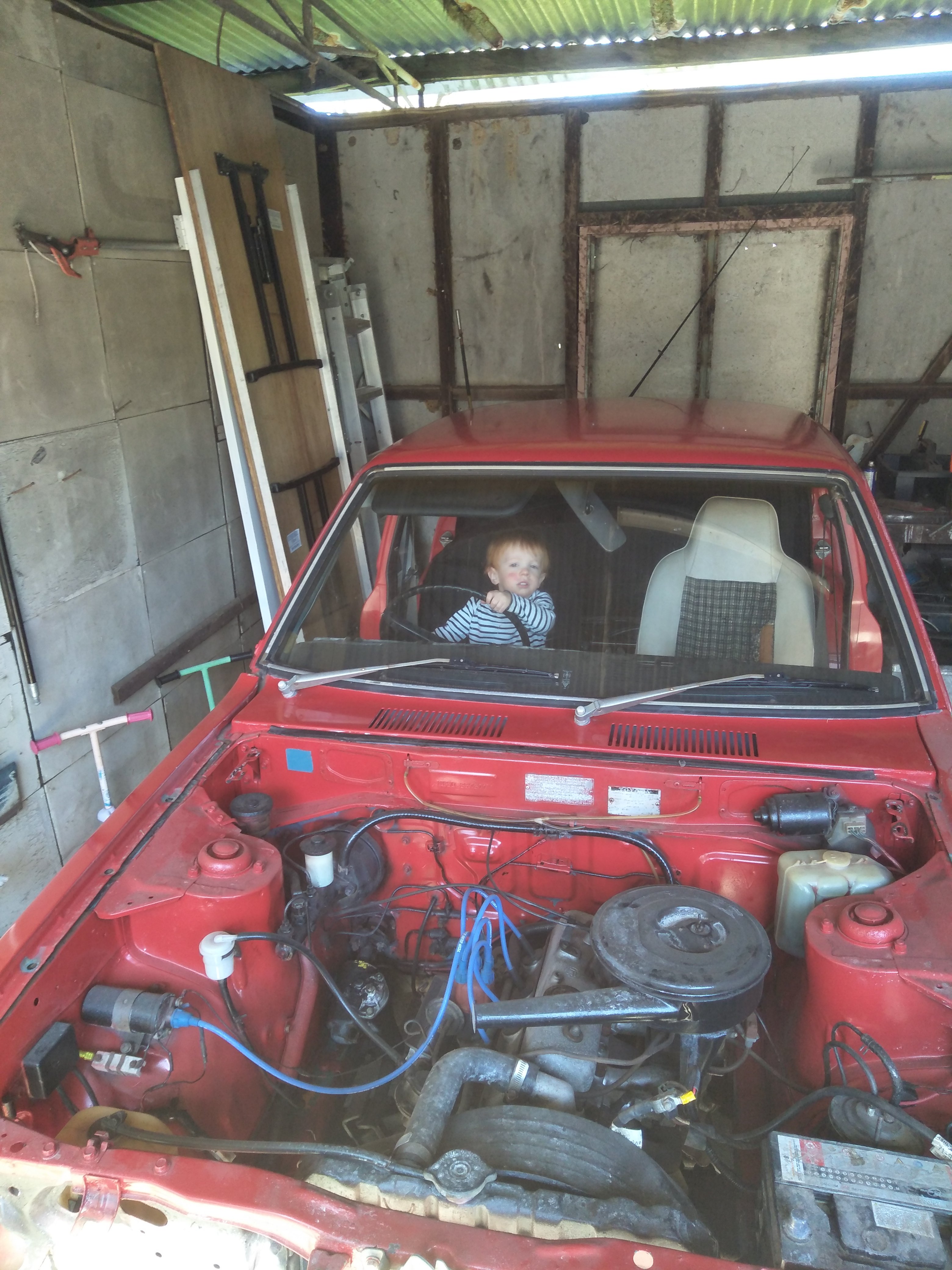

  6. UPDATE I was told the tank was completely drained but thought I'd pull out the drain plug and double check. 5 buckets of fuel and a lot of mess later it was. So a bit of fresh fuel and splashed out on a new fuel filter. Went through all the tips you guys gave me and a minute later we had a running engine. Left the choke on to warm it up, choke back in and it idled perfectly. Can rev it up without missing and comes back to idle without a stumbe. Had a mechanic friend come have a look over both cars and he couldn't believe how well it ran. He also advised me which car was in better shape overall so I now know what to focus on

  8. Will update. Yep that's my 18 month old, his favourite word is car and loves anything with moving parts that makes a noise.

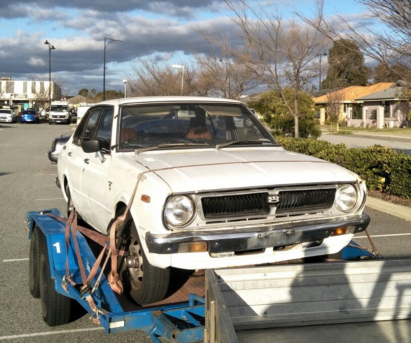

  9. Cheers for the replies hopefully find a bit of time on the weekend to give it a go. A little about myself. I first found affinity with corollas 14 years ago(I was 16 at the time). Drifting was really taking off in Aus and I wanted an ae86. Could've picked one up back then for 1-2k. I ended getting a licensed and running ke70 for $300 which was pretty normal back then. I was moving away so stored it in a shed on my step dads farm. When I finally came home I was told he gave it away as he didn't think it was worth anything. Anyway a few years later here I am with my ke30's(much prefer this shape anyway) and not so interested in drift anymore. Plans for now is just to restore to original and have a weekend cruiser. In the future I may turn into a track car with a 2tg or 4ag. Lastly a few pics of the rollas :)
