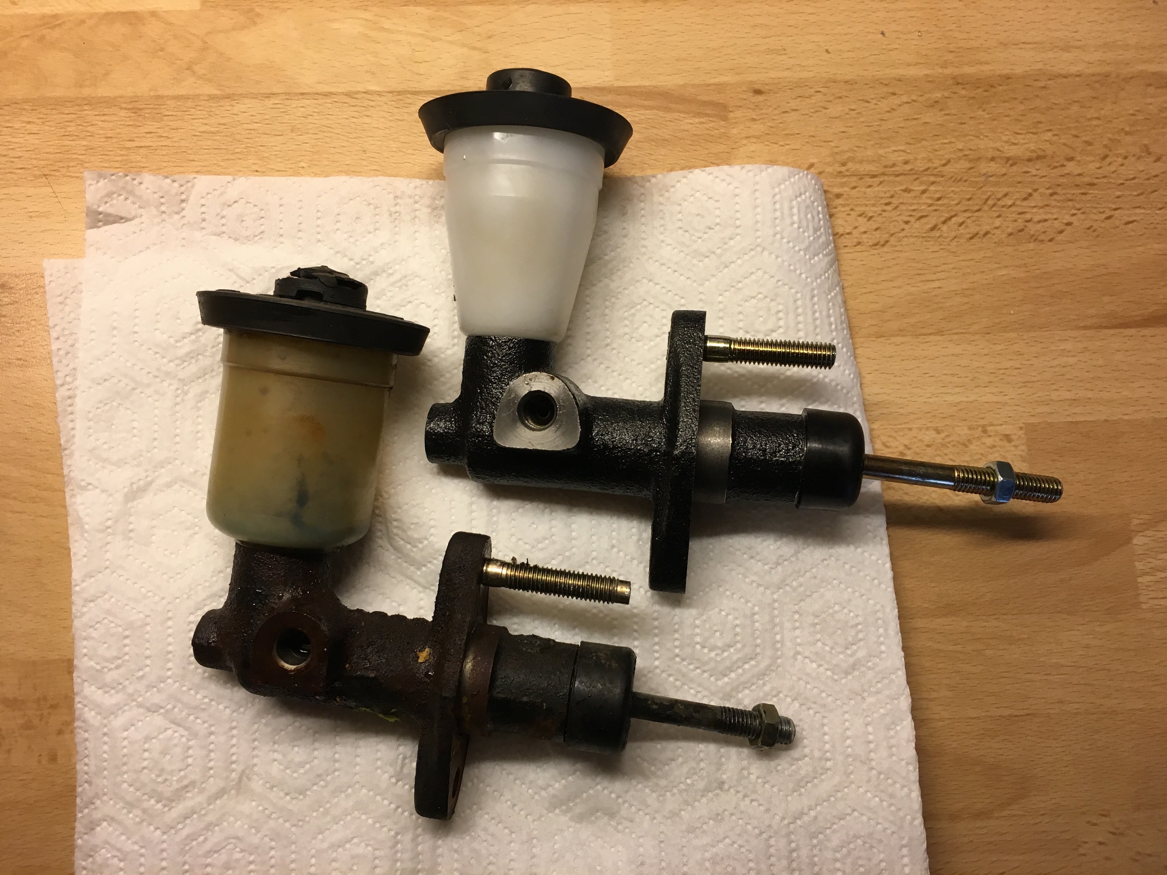

  4. New push rod is in and the car is running, yay!!! everything seems fine except that the pedal is very stiff and sluggish feeling. When I inserted the new slave cylinder I had to twist the hose the opposite way due to the threads being different, I suspect something inside the hose broke and something inside it is now blocking the flow. Can anyone confirm that this might have to do with the clutch hose by the slave cylinder being bad and in need of replacement? Or can it be something else? Thanks for all the advices and replies on this, I appreciate it a lot.

  6. I posted about this in TExx Corolla Discussion, but seems like that part of the forum is quite low on traffic and this post has nothing to do with that specific model. If any admins sees this please remove that post, thanks! My old master and/or slave cylinder gave in a month ago so decided to order new ones, got them from PECAustralia and the make is PROTEX. I got them yesterday and they looked almost identical with the old ones, it seems to be good quality parts.Anyway, I put them in and found that the clutch became very stiff and sluggish like. Also, the clutch only engages when the pedal is all the way out, and the clutch is "dragging" (not sure how to say this in english but the friction plate is dragging when accelerating, hopes this makes sense). I took the new master cylinder out again and found that the rod is over 1cm longer than the old one, and I cannot adjust the new one to be as short as the old, since when adjusting the rod it eventually hits the pedal.Any advice on this? Should I cut the rod?Thanks!
  7. My old master and/or slave cylinder gave in a month ago so decided to order new ones, got them from PECAustralia and the make is PROTEX. I got them yesterday and they looked almost identical with the old ones, it seems to be good quality parts. Anyway, I put them in and found that the clutch became very stiff and sluggish like. Also, the clutch only engages when the pedal is all the way out, and the clutch is "dragging" (not sure how to say this in english but the friction plate is dragging when accelerating, hopes this makes sense). I took the new master cylinder out again and found that the rod is over 1cm longer than the old one, and I cannot adjust the new one to be as short as the old, since when adjusting the rod it eventually hits the pedal. Any advice on this? Should I cut the rod? Thanks!
