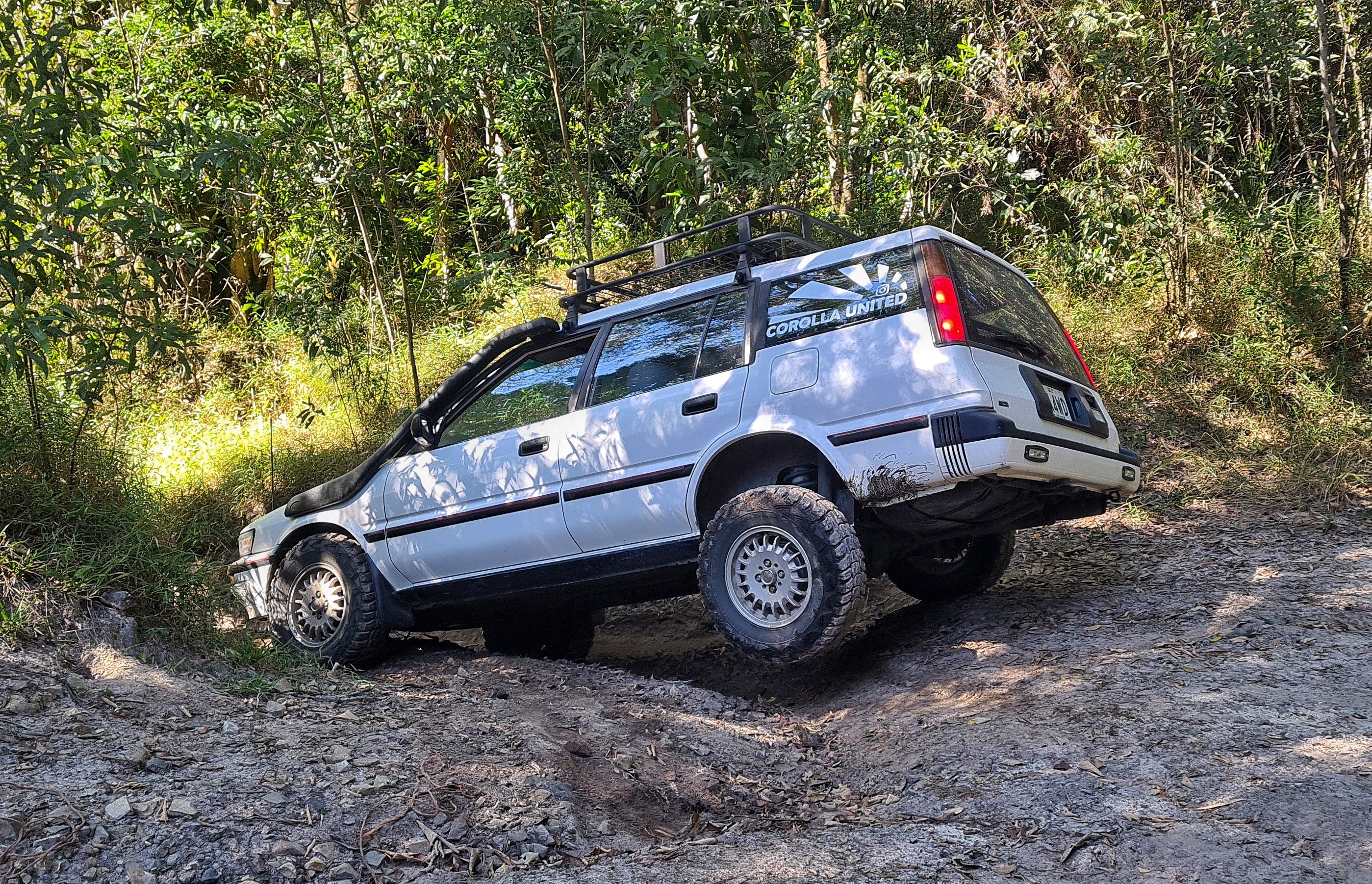

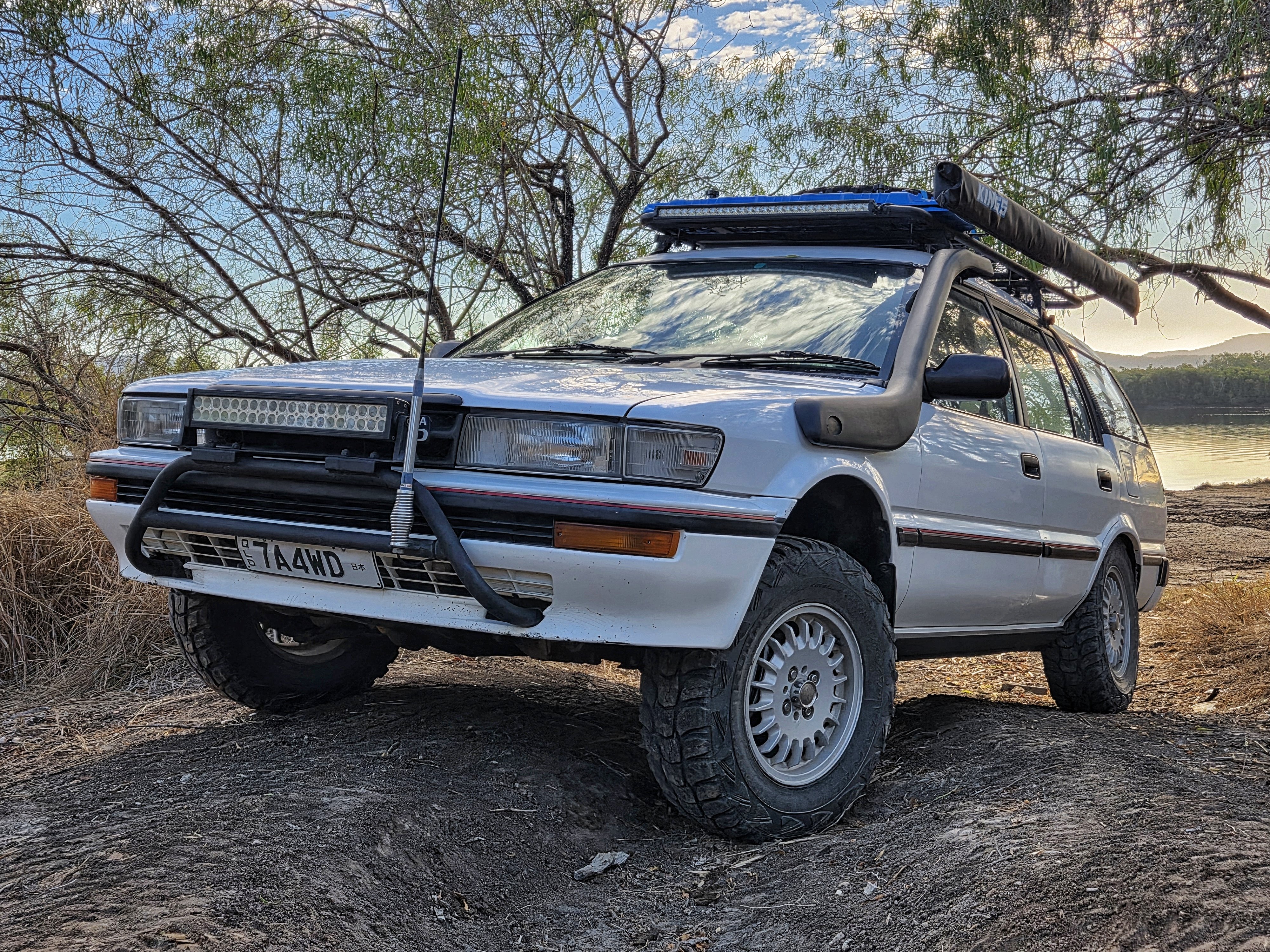

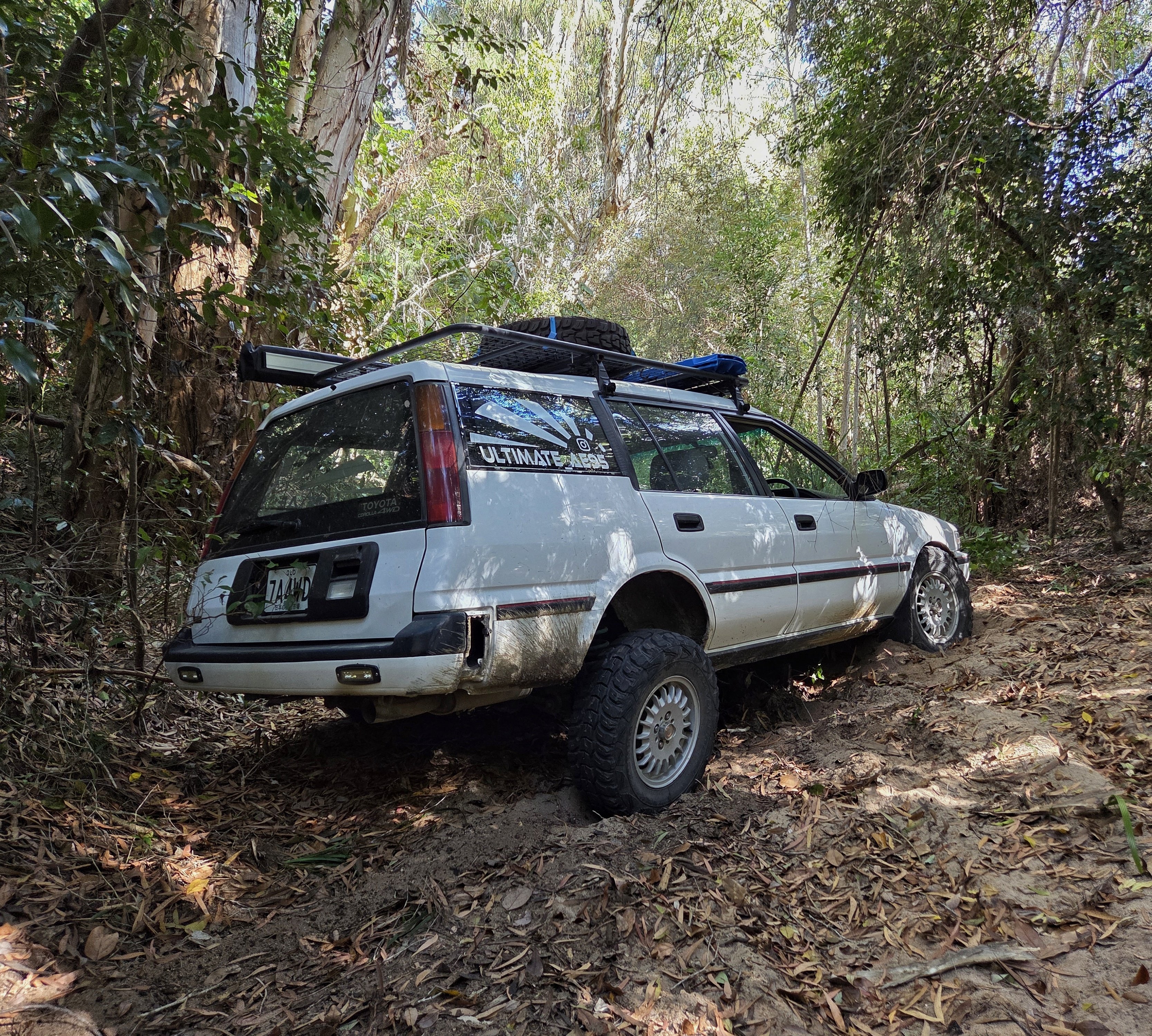

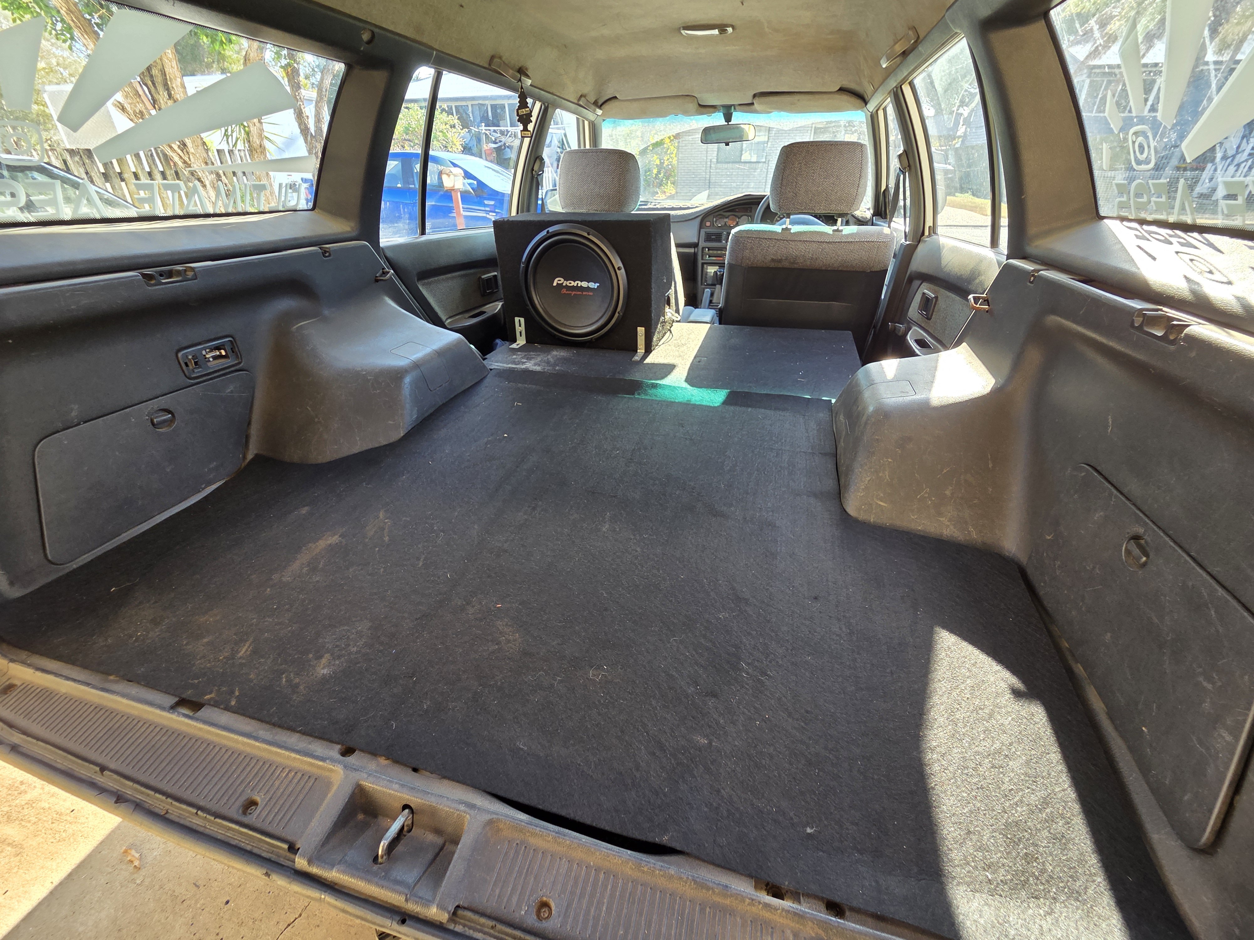

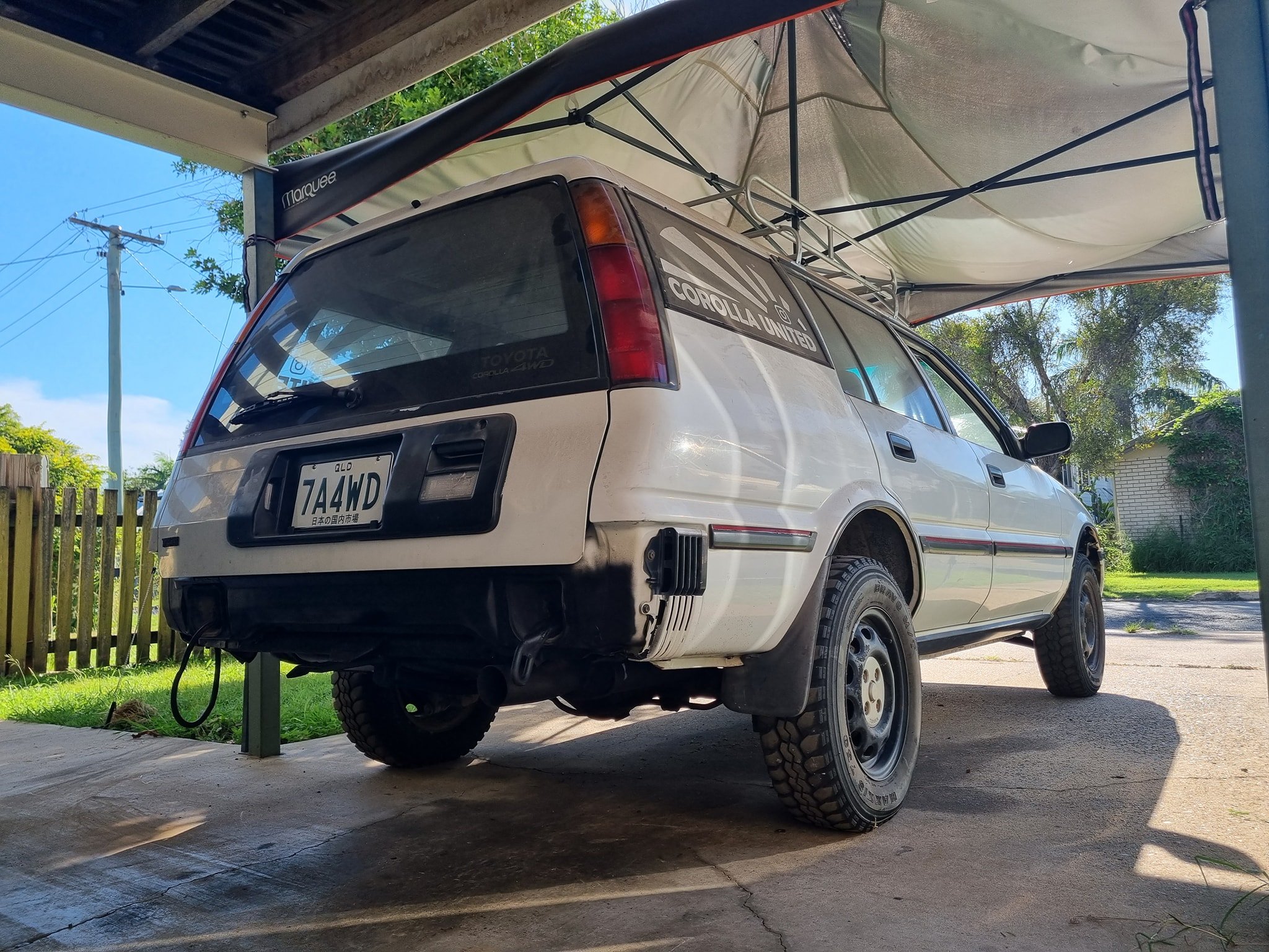

  1. Been a few years now, still going strong, not alot has changed exterior wise. Switched to a longer flat rack roof rack, mounted my recovery tracks up there as well as a 2x3m awning and 32 inch lightbar. On my latest trip into the bush I ripped the factory rear bumper off and broke the mounts so currently in the works with designing and fabricating a custom rear bar with a tyre carrier on the back. Other than that I have perfected the suspension setup. Kept the same springs but rebuilt the front struts and fitted up longer 616mm Rav4 rear shocks which opened up even more flex for the rear. Inside I have removed the rear seats and made a false floor from the boot to the front seats. Where the back seat was I have storage for recovery gear and tools underneath the floor. There is a lot of space there so wanted to use it! Other than that just been enjoying it, getting out and using it on the harder tracks! Actually did a black trail last weekend and there was only 1 obstacle I didn't try cause it was very steep.

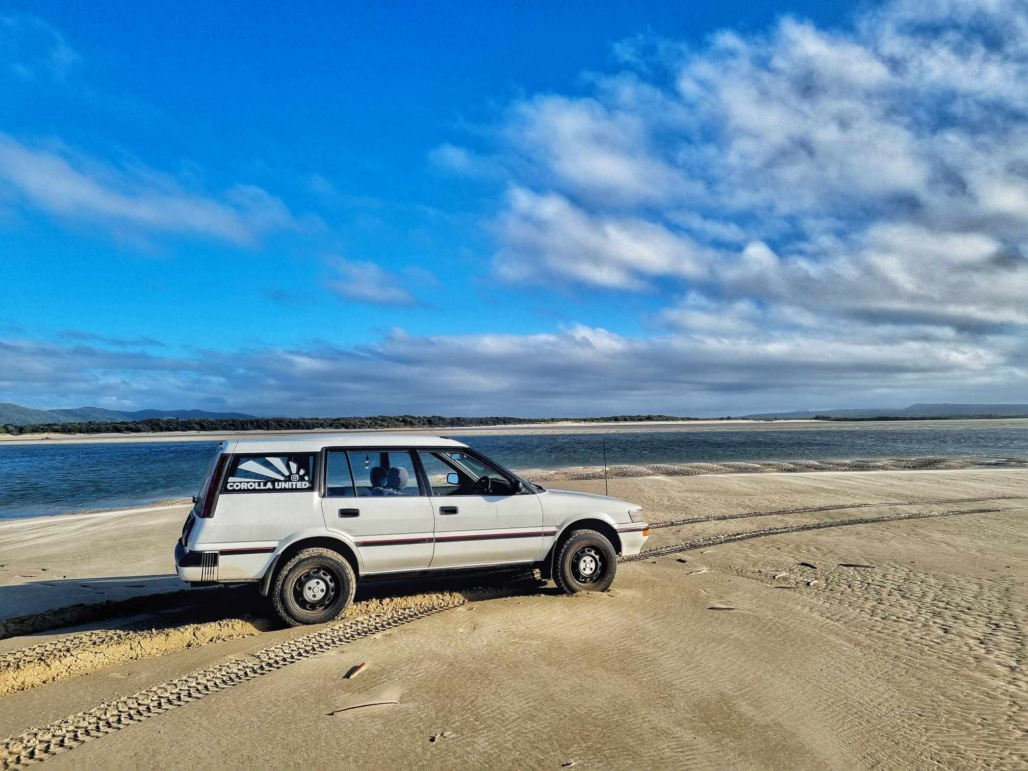

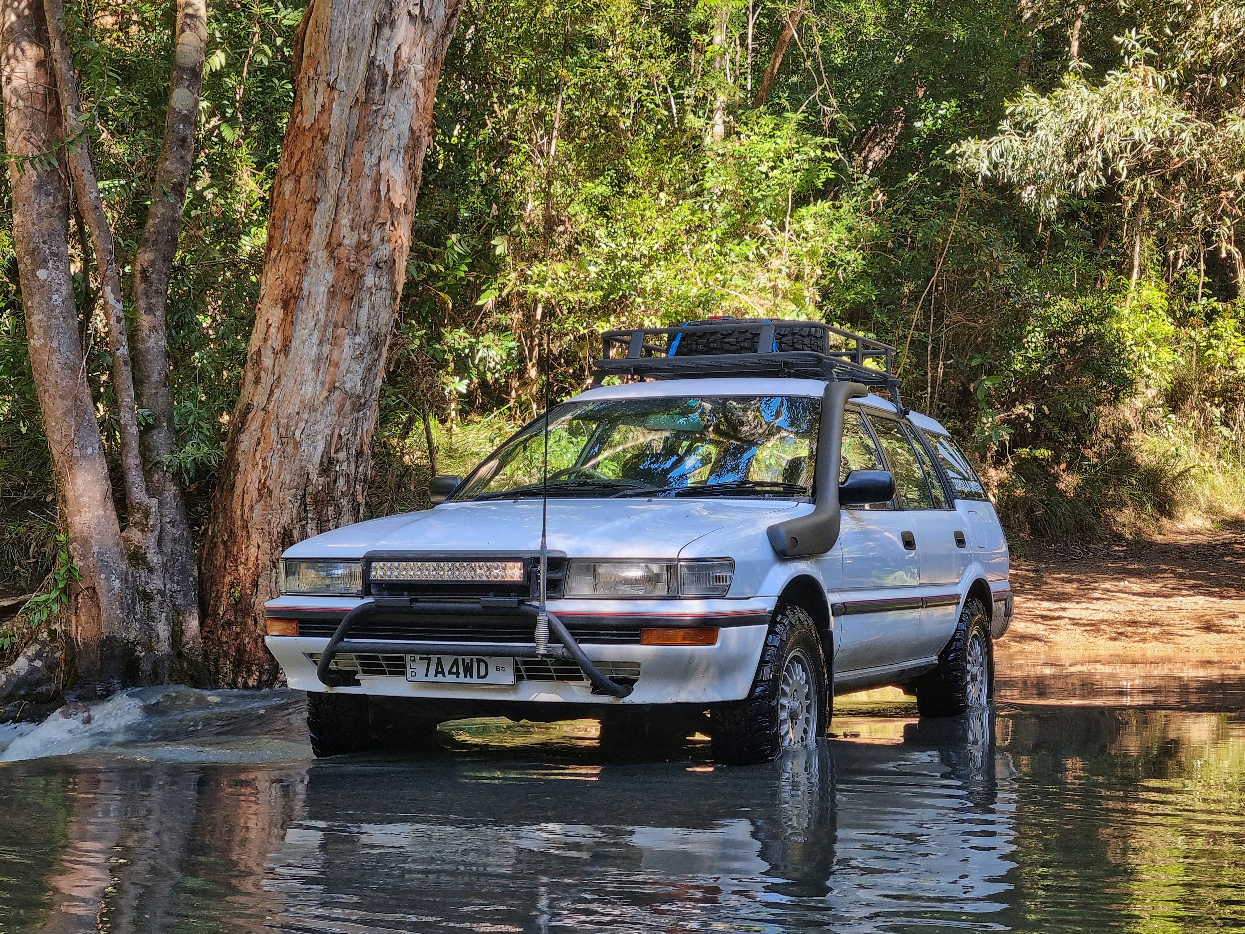

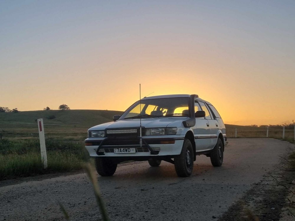

  3. Well BIG update, long story short she is finished and now registered! Here's some photos from it's shake down trip! Started off at a spot out of town for sunrise. Then went down onto the beach! Here's a shot of the finished engine bay! Also fitted up a D21 Navara/Pathfinder snorkel! Fits really well and gives the factory look I was going for! Fitted up some flush mount LED reverse lights in the rear bumper. Really enjoying exploring in the old girl, a few more trips coming up soon!

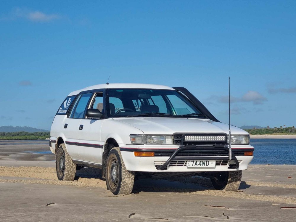

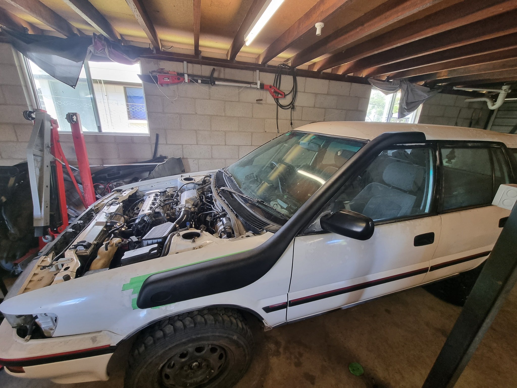

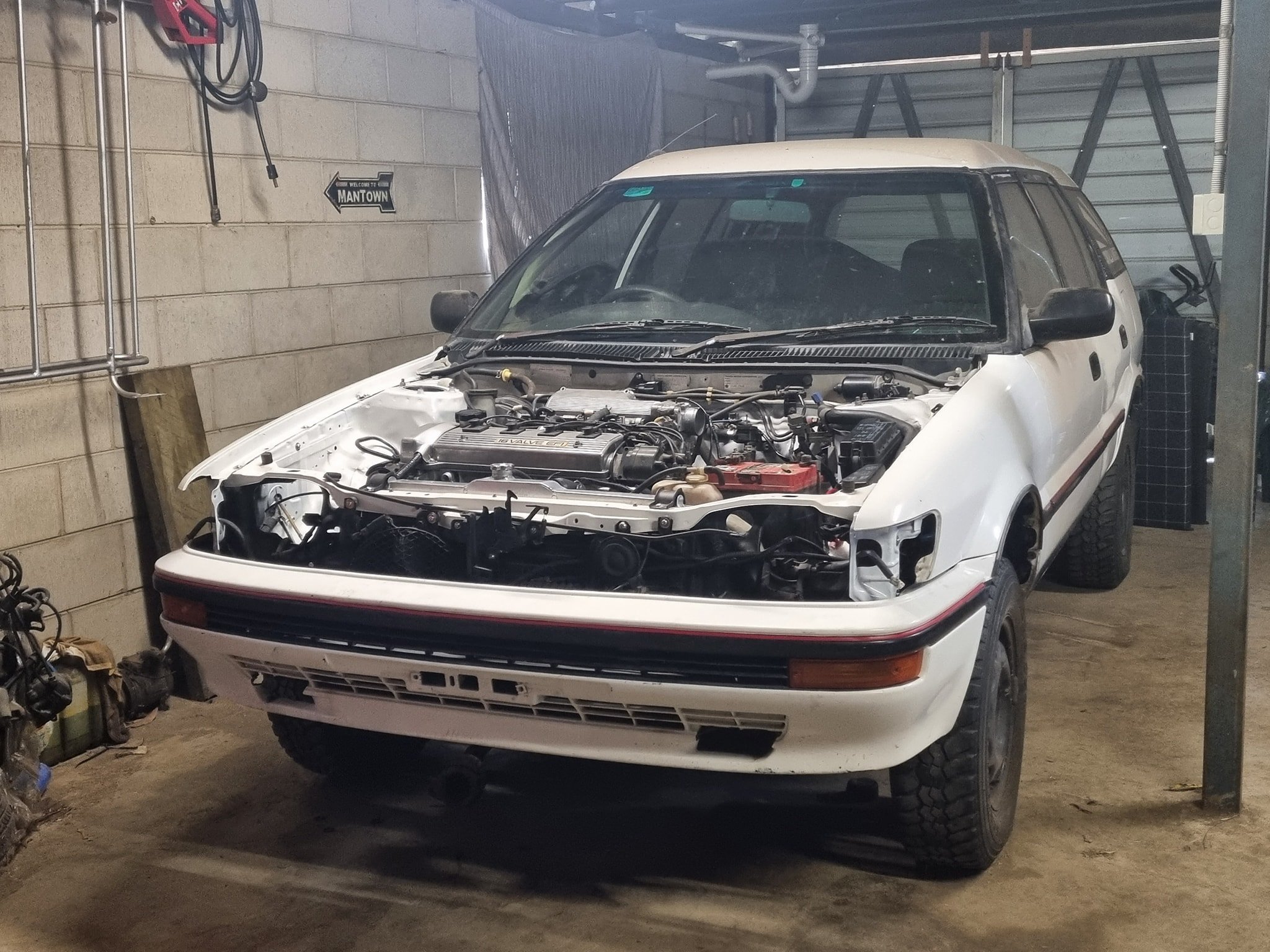

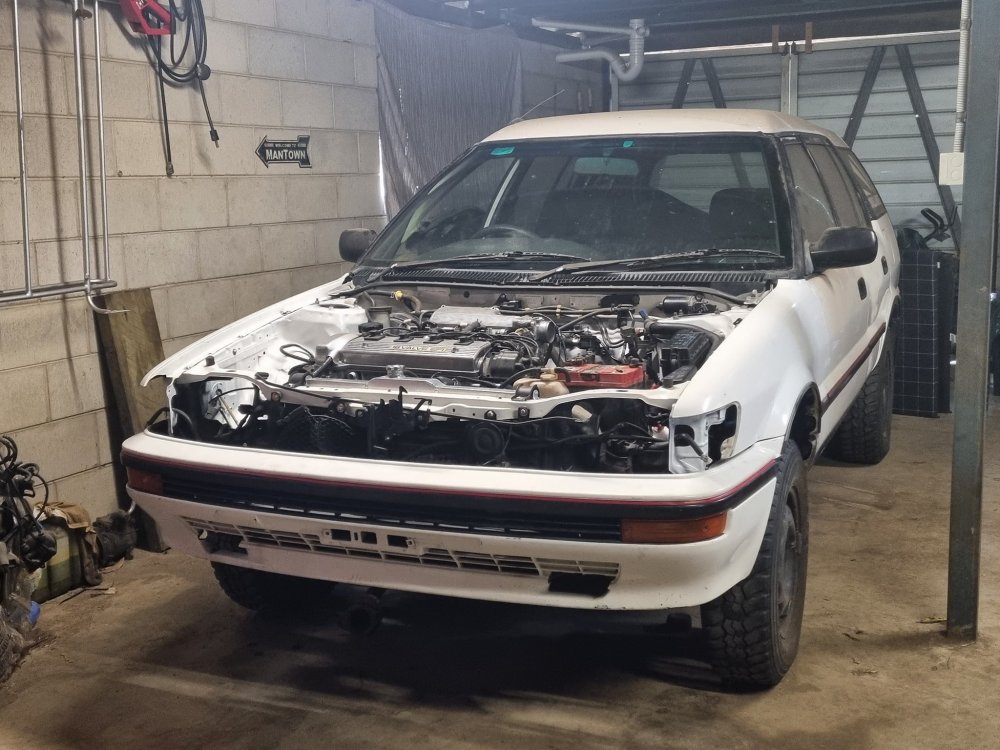

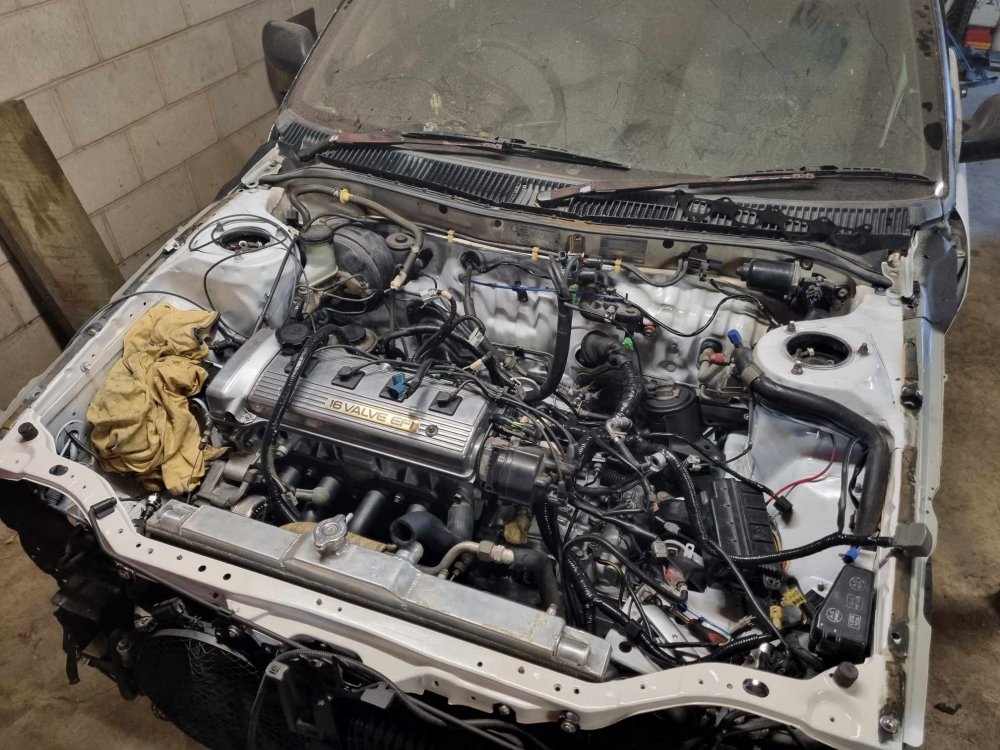

  4. Big update on the old girl! She is 95% finished, just a few small things to do. Had some dramas when I first started it, started, ran for 30 seconds and then died. The engine had the same drama in the donor car which the previous owner of that thought it was fuel pump. I did end up doing fuel pump in this one any way as well as distributor. Ended up finding the culprit being the ECU had shorted out in the injectors circuit. All fixed now and running great! Front end started going back together. Wanted to fit up a snorkel but wanted to go something that looked as OEM as possible. Found that it was common to use a D21 Navara/Pathfinder snorkel overseas so ended up buying one from Malaysia and having it shipped over to Aus! Obviously because it's for a different car the template was pretty useless so I test fitted it a few different ways on a spare guard first to get the final measurements. Obviously not perfect but I love it! Set out to start on the interior, JRP gauges in and I decided to delete the ash tray and the cigarette lighter and instead fitting up a USB charger and mounted my UHF in the ash tray slot using a bracket I made up. Not much longer to go now!

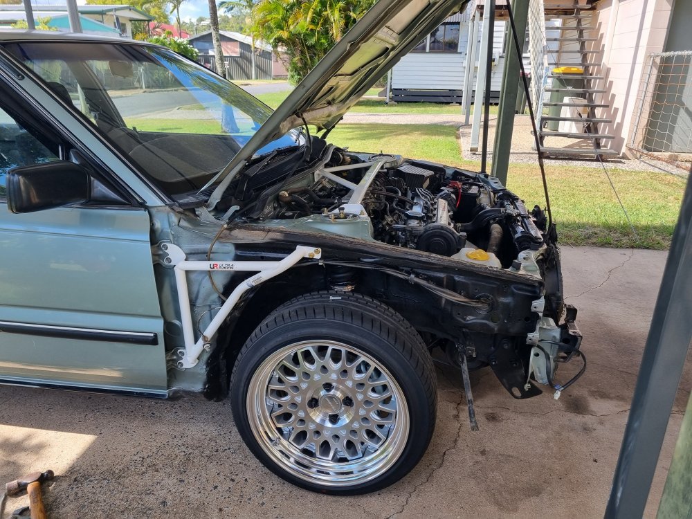

  5. Another update! She's back on the ground for the first time in over a year! Also sound deadened/underbody sprayed the lower radiator support and inner guards. Colour matched the upper radiator support (weirdly from factory they are black in the centre.) And motor is almost completely back together! Big thanks to forum member Kebin for doing the wiring harness! Have done all new front wheel bearings, bushes, ball joints and brakes. Once I have it running I will be doing the same to the rear! Will be like a brand new car when I'm done! Also scored a parts car for free. She has a blown clutch, water in the motor and the radiator support has been pushed upwards. She will donate a few pieces to the build! Check out the height difference from stock to lifted! Roughly 4.5" higher taking lift and tyres into account.

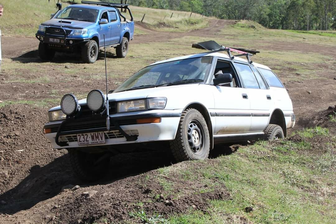

  6. Just another post regarding the mods by not the bloke I bought it from but the bloke before him. Actually got in contact with him shortly after buying the car and got some photos and more info off him. So it's got Dobinsons springs front and rear. Front are TN Magna springs (C43-038) which give roughly 1" lift and it has a 2" strut top spacer. Rear is what I believe to be EL Falcon springs with stock gen 1 Rav4 shocks which are 3" longer than standard AE95 shocks. Rear end also has custom adjustable upper control arms and panhard rod. For those that don't know, the rear end on these are live axle coil sprung. Future plans will be to get some more flex out of the rear end. I will be removing both front and rear sway bars. (car won't be daily driven so shouldn't need them.) I actually live in the town where the Dobinsons Springs production warehouse is so will be making a visit to them to try and find a slightly longer rear shock. I also plan on going 27x8.5 R14 Kumho MT tyres in the future. Current tyres are 185r14 Maxxis MT753's. I'll throw in a couple pics from the previous owner and the journeys he took it on. I'm up in Central Queensland Australia so pretty cool that it has been so far south as Coffs Harbour NSW

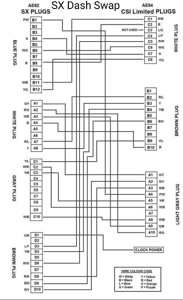

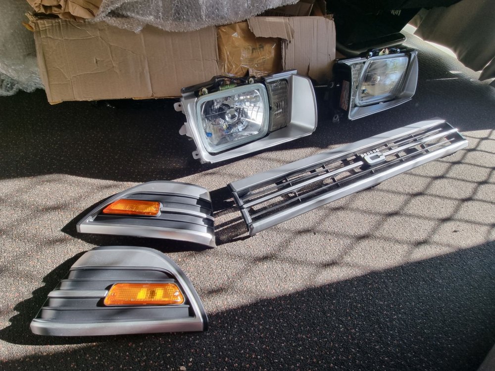

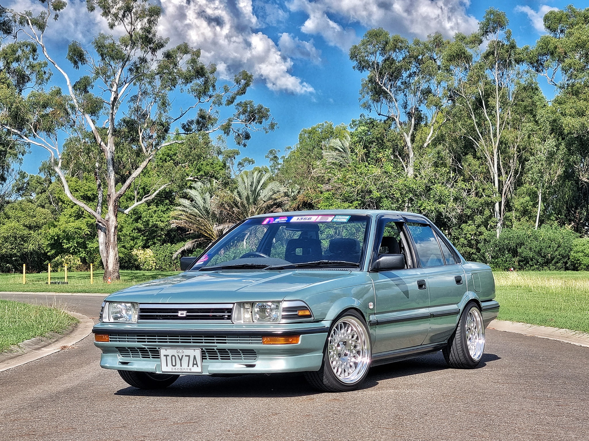

  11. Few mods over the past few weeks! JDM Wagon face front end conversion! And now sitting pretty on some BC coilovers! Missed the low life so much! And black slimline weather shields! And wheels have been ordered but have a 4-6 month wait!

  13. Big update on this car, bit of a change of plans. It has now become my daily driver. In saying that the mods have not stopped and mods are still incoming as well including some goodies from japan! Chucked in the AE93 SX cluster while keeping the original low km odometer. Cleaned up the engine bay and polished the valve cover. And just a few shots of the old girl!
