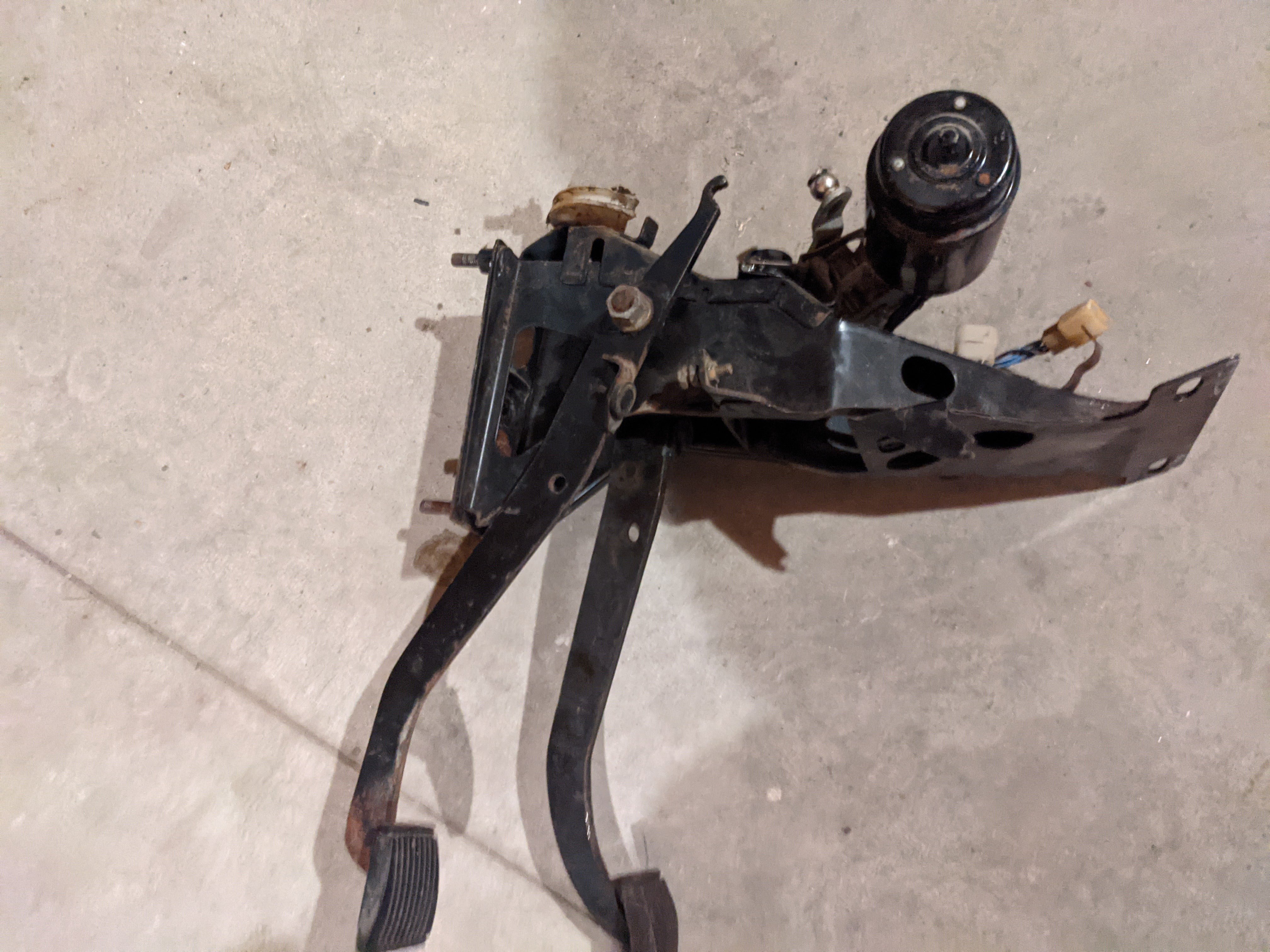

  1. Ahh okay. I was wondering where that was at as well. I couldn't manage to get it off of the pedal box when removing it so I had to remove the dash cluster to get it and the pedal box out. Thanks!
  2. What is the round thing connected to the top of the pedal box called and what is it for? It made getting the pedals out a real pain and I really have no idea what it is.
