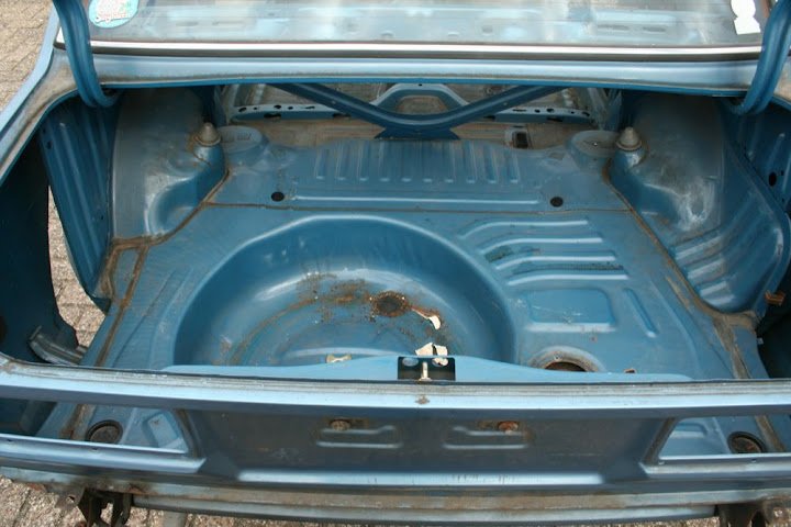

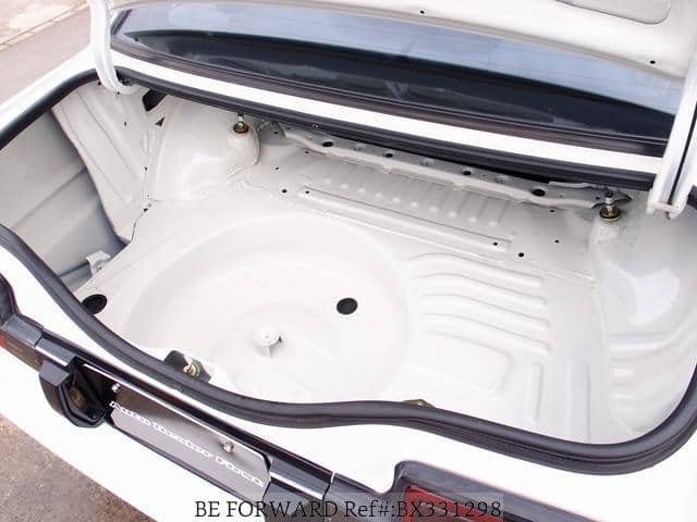

  3. Someone in Indonesia managed to convert a KE70 into a Trueno Hatchback, and in Malaysia, I’ve seen a Daihatsu Charmant transformed into a Levin Hatchback, so I believe the width compatibility is definitely there. The AE86 dashboard fits nicely into the stock KE70, so that’s another good sign. Just to clarify, I’m not referring to swapping every panel, but mainly the outer body parts like the front and rear bumpers, headlights, grille, fenders, doors, rear quarter panels, tail lights, and trunk. I’m not entirely sure about the pillars, but I think the door pillars can be repositioned and welded to accommodate AE86 doors. That said, I’m especially interested in knowing if a Levin sedan conversion is possible. If anyone has worked on something similar or is currently building one, I’d love to see your progress, photos, videos, or even build threads would be super helpful. Thanks in advance! https://www.instagram.com/reel/DBNge5Xhyk5/
  4. AE86 Body Panels on a KE70 – Is It Possible? Hey everyone, I have a serious question and would really appreciate some input. In my country, AE86s are extremely rare, but we have plenty of KE70s available. I used to own one and now I'm planning to buy another. While comparing the trunk panel of a KE70 with that of an AE86 Corolla Levin, I noticed a striking similarity between the two. That got me thinking, is it possible to weld AE86 body panels onto a KE70 chassis? If anyone has experience with this kind of swap or build, I’d love to see some photos, reference videos, or any resources that could guide me. My goal is to create something visually and structurally close to an AE86. Thanks in advance for your help!
