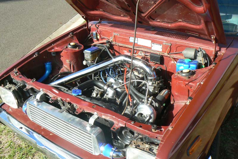

  3. turbo4k replied to turbo4k's topic in Rollaclub Rides
    i knew i wouldnt get a grill over the cooler but i still need something to work with, the cooler had to be mounted that far forward so i could fit my pipes in. i got a reg and pump i just have to weld up my surge tank. as for pics of manifold, they wont be much good to you cos i wrapped it already. I'm hoping for 150 ponies at the wheels, might be dreaming but ill just have to wait and see she shuold be running next weekend.
  4. turbo4k replied to turbo4k's topic in Rollaclub Rides
    no j pipe, i made a custom manifold. I'm not sure how much boost I'm gonna run prob around the 15psi mark + 14 shot (smallest jet i could get) of nitrous just to get it onto boost quick. i need a grill if anyone has got one they wish to part with let me know

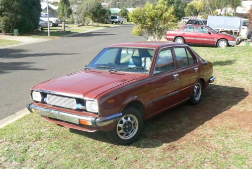

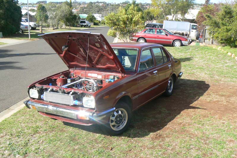

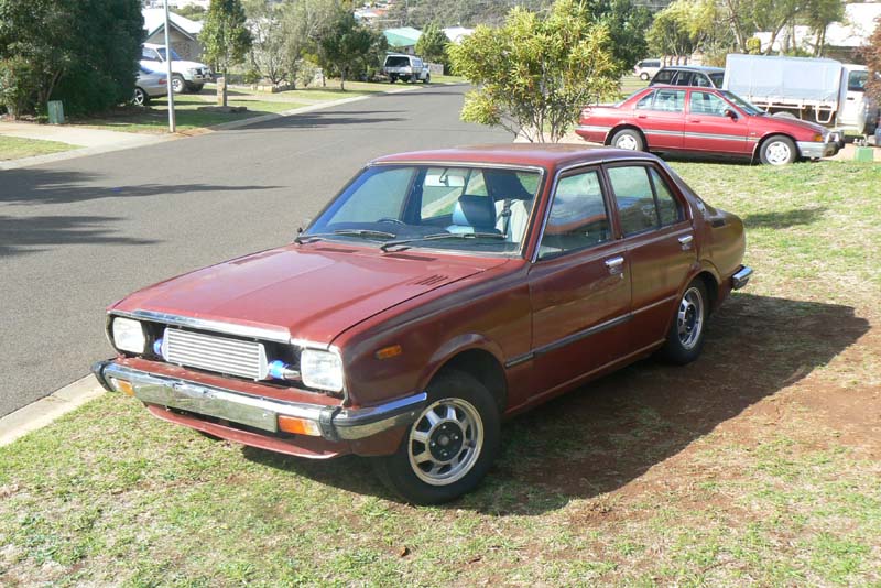

  5. turbo4k posted a topic in Rollaclub Rides
    Hey everyone, I've been working on my ke55 for a few months and this is what I've come up with.... It's got a Garrett t25, I ported the head, done a full rebuild, front mount + stainless pipes, full stainless 2.5" mandrel bent exhaust, electric ignition got a few other bits and pieces. I just have to do fuel pump, surge tank, regulator and hook the gas up and she will be ready for dyno. Here are some pics let me know what you think.
