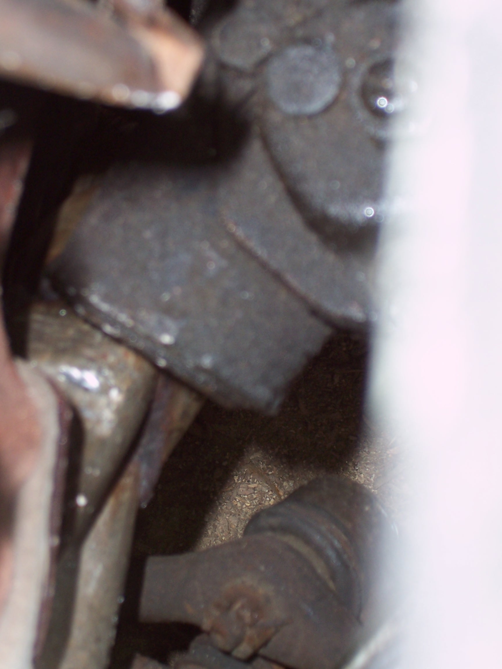

  12. Hey Guys, I am in the middle now of rebuilding my struts on the ke15. I have a set of Ground Control/Eibach coilovers that I am going to fit to the ke15 strut and they are for a 99 corolla, but they will be close enough for what I need. I also have a set of tokico inserts for them. I got the first "retainer nut" out and the insert won't budge, is there another nut under there. I see a flat washer looking thing with a hole on each side like it may be another one maybe. These appear to be original rebuildable struts. Thanks for the help, Glenn
  13. I ended up adjusting the pipe with a BFH and it seems to clear a lot better now :'( , not exactly the best solution, but I didn't have any more patience for the clunking. I figure that the amount of "adjustment" vs the excess piping that the exhaust shop left probably evened out. Mikey, the starlet dizzy is elec, right? No points and more spark, this is a new one for me. I'll get with you after the holidays to hook up on it. Thanks for your help. Glenn
  14. Mikey, I'm not sure what car the motor came out of. It's a 3k that came out of a 79 ish Corolla, I think. I bought it from one of the techs here at work and it came out of a relatives car so he couldn't remember. It is a dual plane exhaust which adds to the size by a good bit. I have cut the exhaust off and hammered it a bit to make some more room. It's not the best way, but I really don't know how else to fix it for now. The more I get into it, the more I think that I should've gone with the single plane from the k motor, it would've been much easier and cheaper. I'm not sure if it helps much on the power side. Do you still have the starlet dist? I may be interested if you do. If you can think of any other bits that might help me tweak some power out of this ride would be nice. By the way, I used your trick on the clutch with the tube to extend the adj. and it feels much better. Waht setup are you running again? 4k with efi? What car here did you pull that off of? Thanks, Glenn
