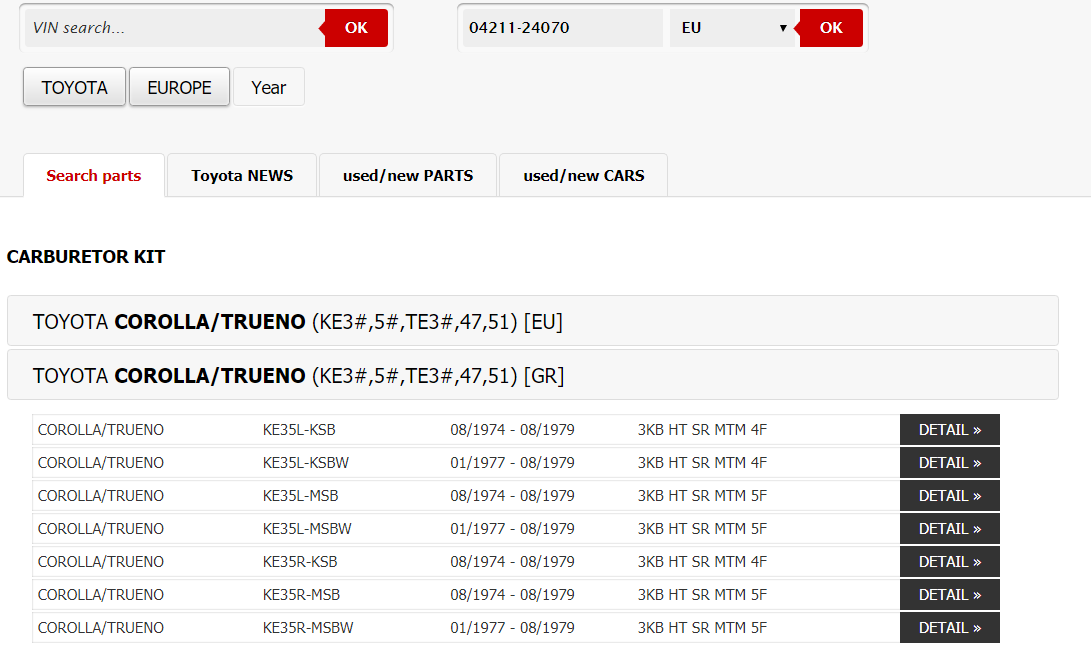

  10. u have to buy 2 kits I cna confirm this is all correct, you ignore labels on ebay listings. Just look for that part number, it is for the twin carb on the following cars
  11. take this as gospel from the toyota parts list diagrams for twin 3KB carbs fitted to 1974 KE75 http://www.japan-parts.eu/toyota/eu/1974/corolla-trueno/ke35l-ksb/5_161230_046_/tool-engine-fuel/2103_carburetor#21251 primary main 0.83 X2 Secondary Main 1.26 X2 (dissarees with previous rollaclub figure of 1.4) Slow Jet 0.44 X2 Power Jet 0.55. This is tthe carb assembly. http://www.japan-parts.eu/toyota/eu/1974/corolla-trueno/ke35l-ksb/5_161230_046_/tool-engine-fuel/2102_carburetor-assembly And the kit you are after is part number 04211-24070 for sale on ebay for 50 bucks. https://www.ebay.com.au/itm/Carburetor-Repair-Kit-Fits-Toyota-Corolla-KE30-E30-KE35-KE36-KE50-3K-3KC-/111874239684
  12. bugger i accidently bought that kit for my 4k in philippines, but can't remember what the jets were. i didnt end up using them coz they were wrong and caused a massive idle and low RPM power problem. I remember that they were all relitively close to the follwoing 3K-C&H figures from the K series handbook: 3KC&H Primary jets: MAIN 1.05mm, SECONDARY 1.41 mm Slow jet, 0.47 Power Jet 0.8 4KC PRimary Jets: MAIN1.1mm, SECONDARY 1.53 Slow jet, 0.53 Power Jet 0.8 so the 3K B it that i got, in the orange box, had something simialr to those 3kC sizes, but i think the major difference is the B Primary MAIN jet is ever so slightly bigger than the C (california emmisions) Dual carb is actually 3K-B according to wikiedia. but according to us here at rollaclub, buth B and D are dual carb. and according to rollaclub, these twin carbs use Primary 0.84 Secondary 1.4
