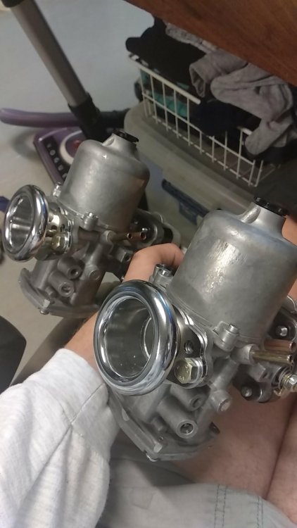

  4. I had a great time at my first Toyota Nationals. Everyone was super friendly and a really good time! In other news, I got my new carbs. I think they're stunning! I also bought a 5 speed that is currently sitting at my grandmothers place ready to be picked up!

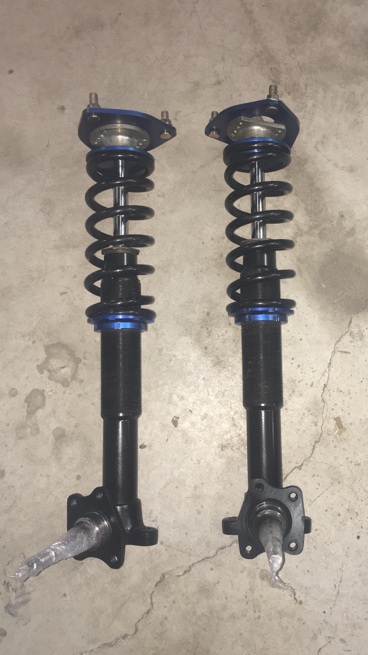

  5. I've got some custom ones basically the same, however. I haven't got the brake line clamp thing on the strut, how well does it sit down that low? because my thread for the coils goes quite a way down

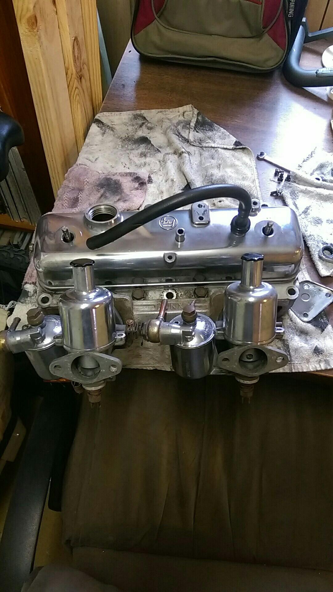

  8. current situation, been cleaning up the head to get it off to the machinist, and carbs are being rebuilt in the next few weeks I also got some front coilovers for a steal, if anyone wants some ke70 camber-tops I've got some to sell.

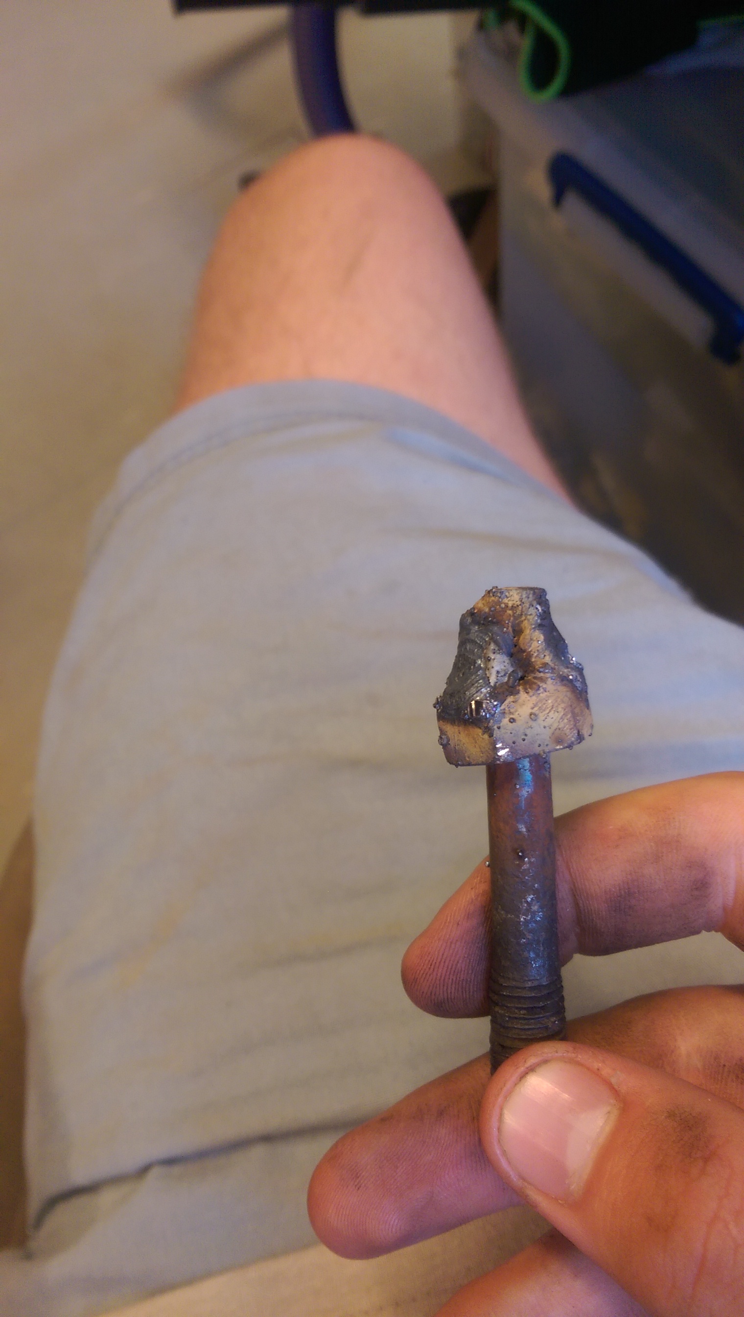

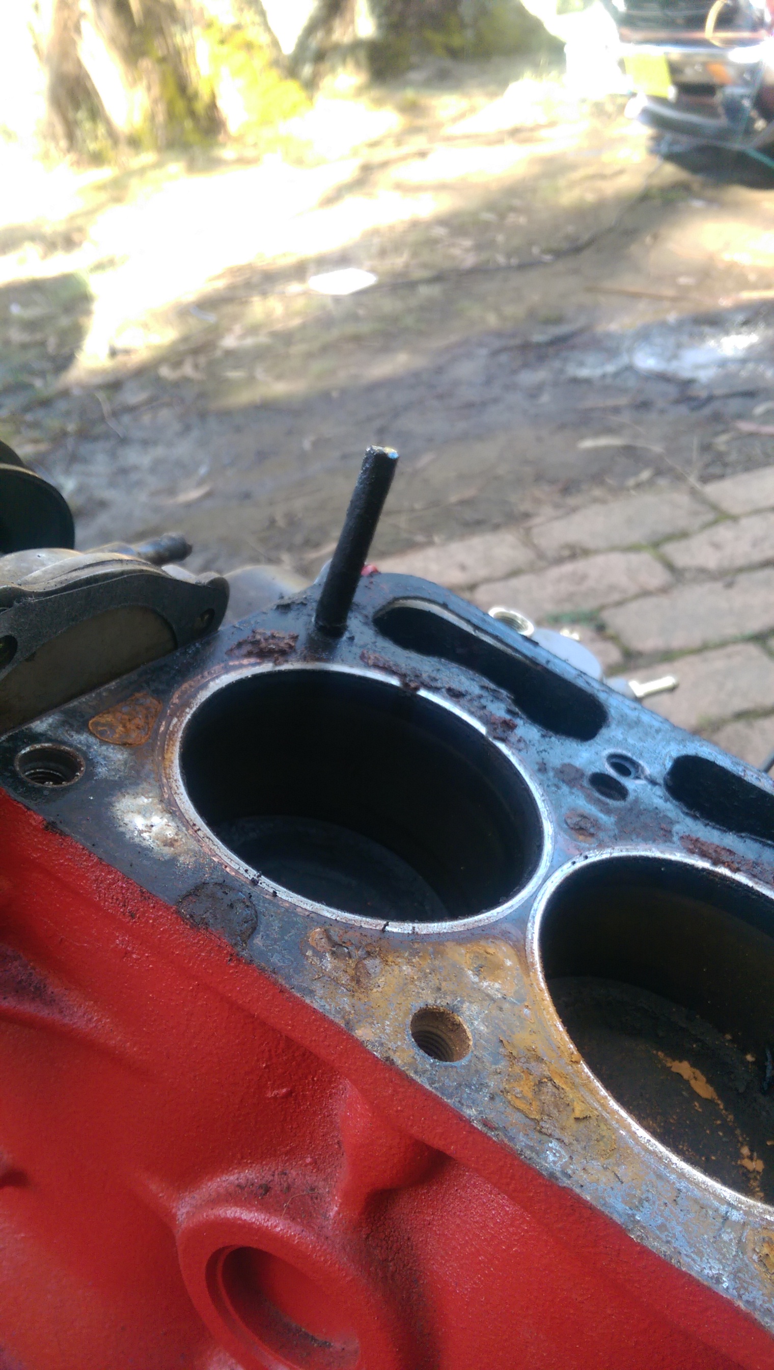

  10. Hey Banjo, and everyone. I finally got it out. It was my turn at welding so don't mind the horrendous welds, but I was strong enough to crack it.
  11. Hey there Banjo, unfortunately I haven't had time to get the bolt out as of yet, but. I think i'm going to heat the bottom of the block a little then weld a nut or 2 on the top and hopefully be able to crack it that way
  12. What's the quality like on this stuff Jeremy?
  13. Hey again banjo! Thanks for the reply once again I thought of welding a few nuts onto it and using a socket, but as you said. I don't want to risk it snapping into the block, as it seems pretty damn stuck. Cheers man!
  14. Cheers Banjo, I can't thank you enough. I'll use that guide when putting it back on!! I kept letting it sit in Wd-40 then flushing it and doing it again. After about 6 hours, my dad and I gently tapped one end of the head as we chocked the other end (making sure not to scare it) amazing how that little bit of metal can make me go insane :^)
