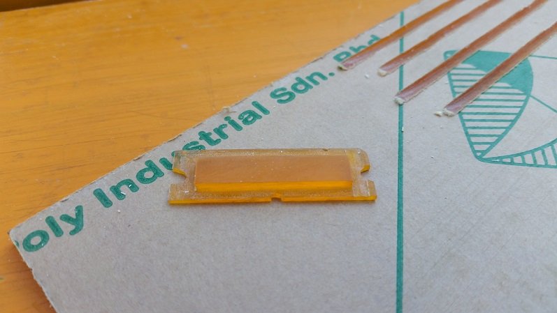

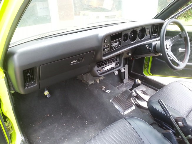

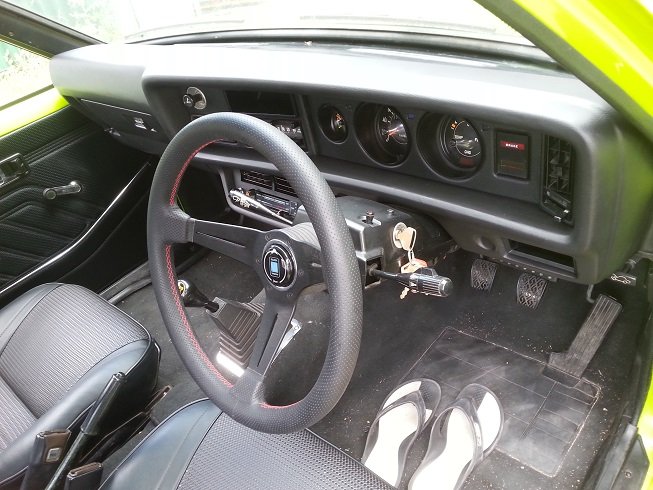

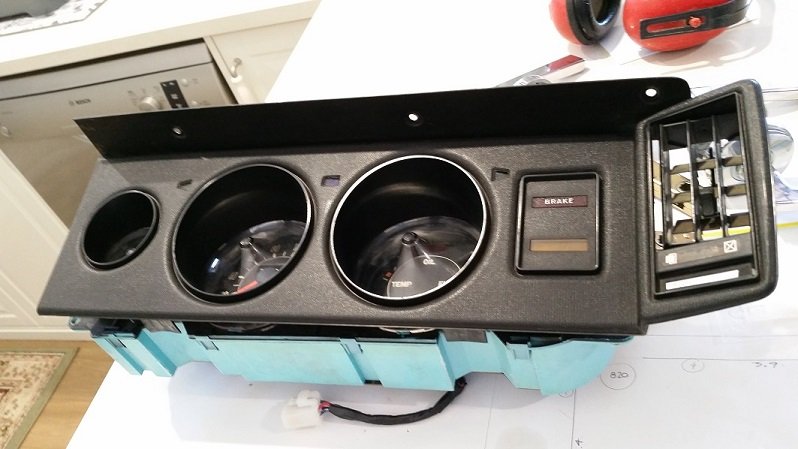

  10. Finally got around to installing the refurbished dash that I got back a few weeks ago. From when I did the conversion I had the ECU check engine light dangling off a cable hanging under the dash. Ive been wanting to have the check engine light in the dash under the park brake light but looking stock. I bought some 3mm translucent amber perspex. Did all the cutting on my triton table saw so that the lens would be recessed. I sanded the top of the perspex with 600 grit to take the shine off and no longer see thru. Filed the notches out for mounting and used a soldering iron to melt the pre existing tabs in the dash facia to hold in the perspex in. Reworked the PCB on the cluster to suit so I could use the stock dash bulb and location. It doesn't look 100% stock but it will do. I cleaned all dash components with a toothbrush and dish washing liquid. Even pulled the fins out of the vents. 40+ years of dirt and grime. time consuming but worth it. I also replaced the $20 dollar Nardi copy with a genuine one the family bought me for last xmas.
