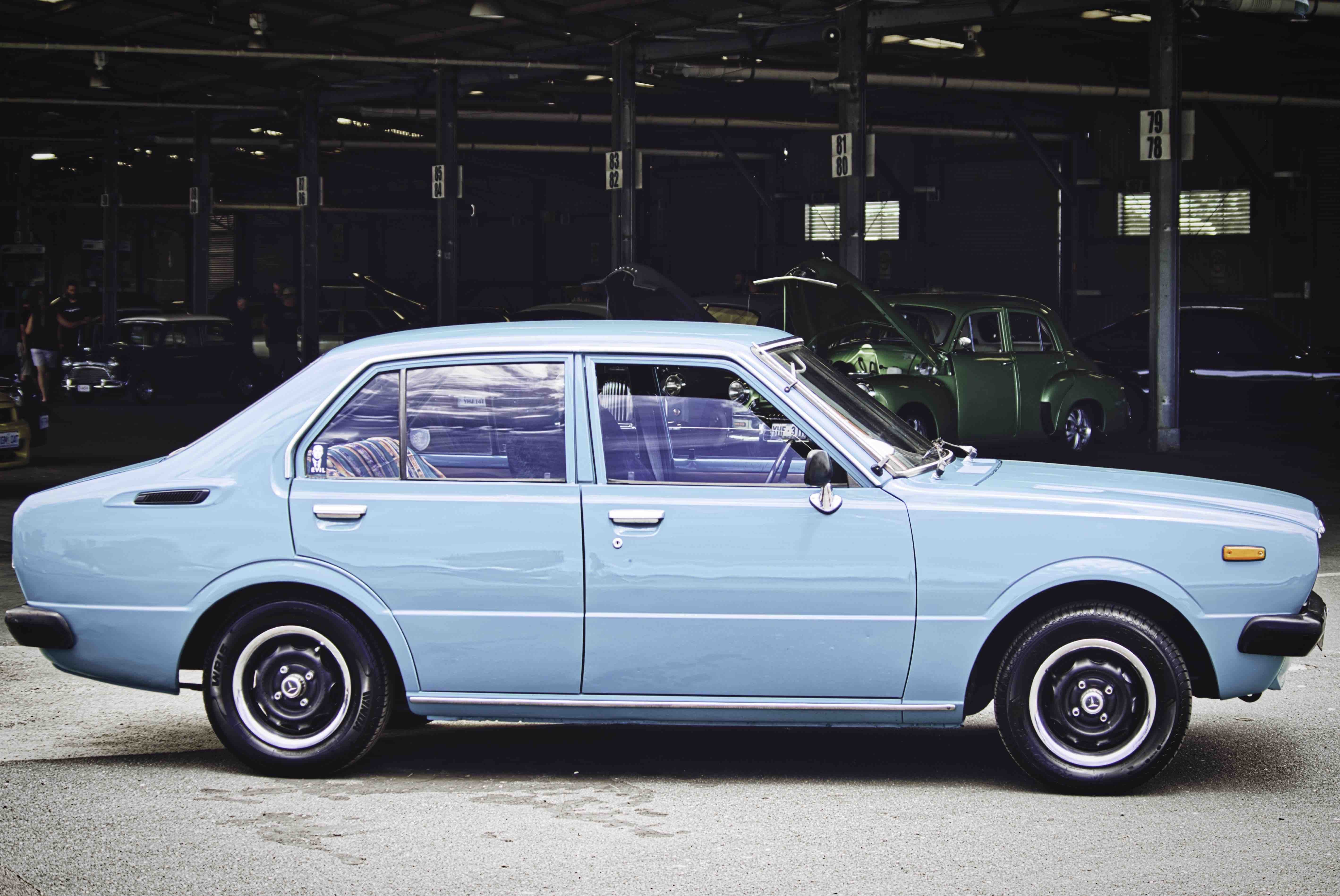

  1. Sadly just before Christmas my beautiful ke55 was stolen when I was visiting my parents in Canberra, joyridden and torched on the side of a major road. I've been to see her at the wreckers yard, and she is completely done. The firefighters put the fire out before it reached the engine bay, so I have the car now at a mate's place and we're going to pull the engine and any other front end parts this weekend, then post them up here and on the forum if anyone wants them. Pretty awful way for a great car with a lot of love put into her to go. At least she was insured, and they'll be another (hopefully corolla!) project soon. Here she was at the most recent show, a fortnight before this happened.

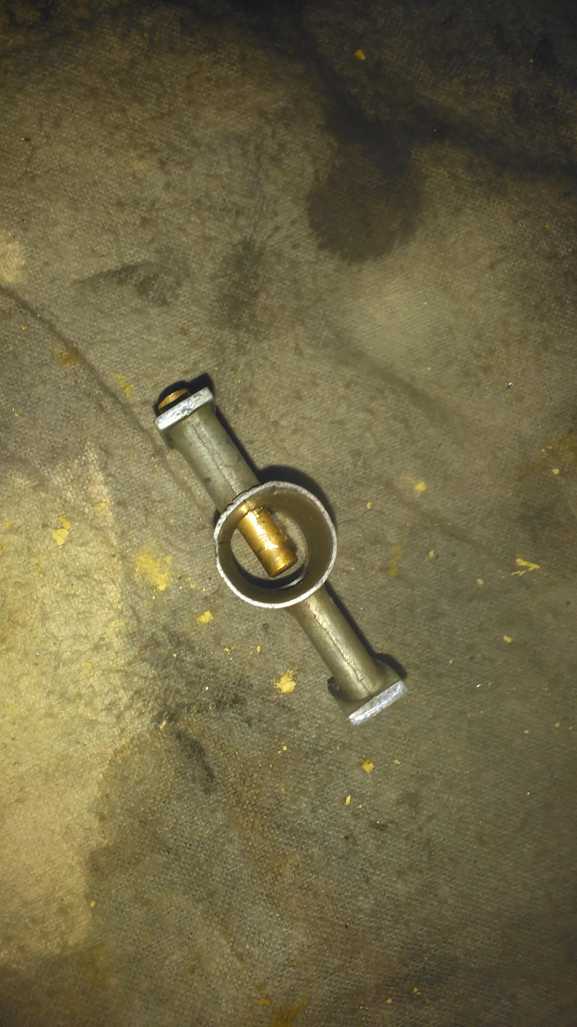

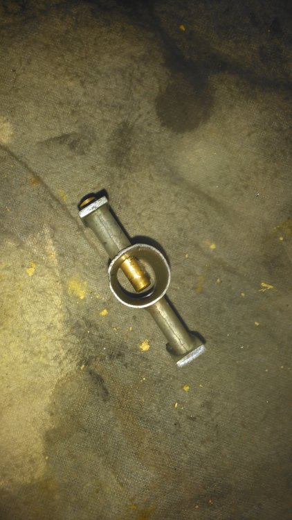

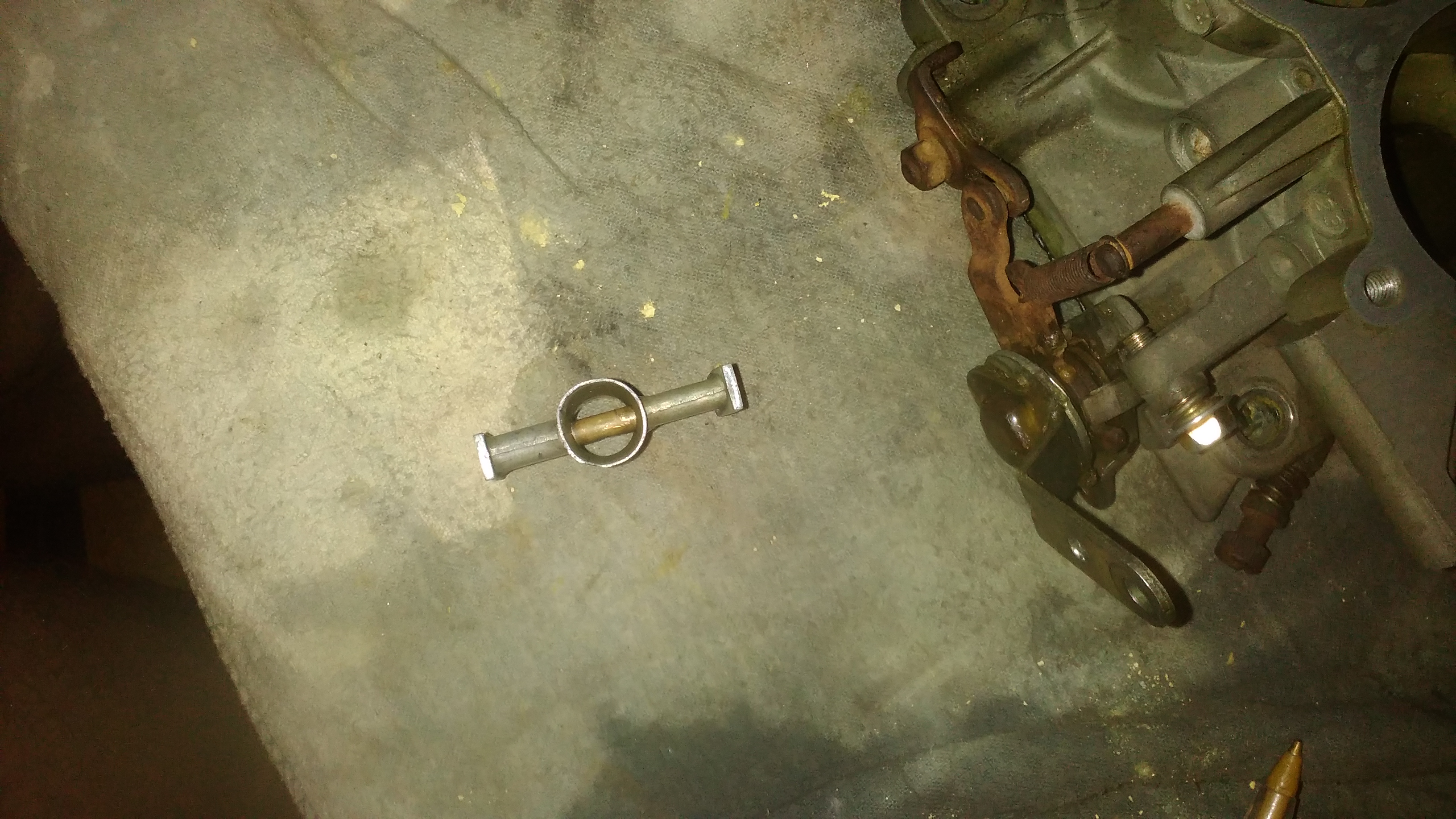

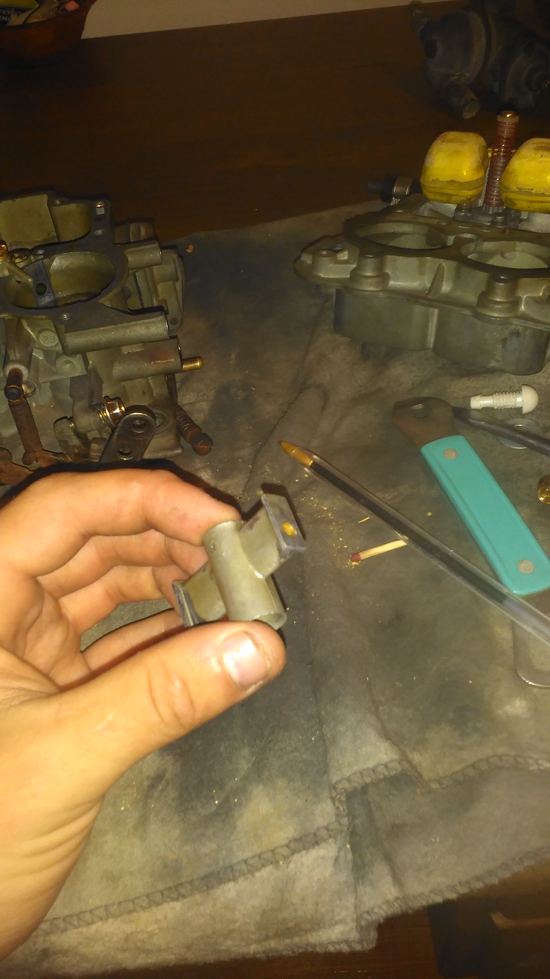

  9. Problem solved! After taking the carb off for a cleaning, I couldn't get the primary Auxiliary venturi off! Turns out the brass insert in the venturi had slid half a cm toward the float bowl, and rotated such that the opening was facing sideways instead of down toward the throttle valve. This was all but completely blocking fuel to the primary throat. I've attached some pictures of the before and after look at the venturi for the sake of explanation. The brass tube felt quite loose in its hole, so I shimmed it with a piece of beer can and tapped it back in with a pen, with the little fuel windows facing down.
