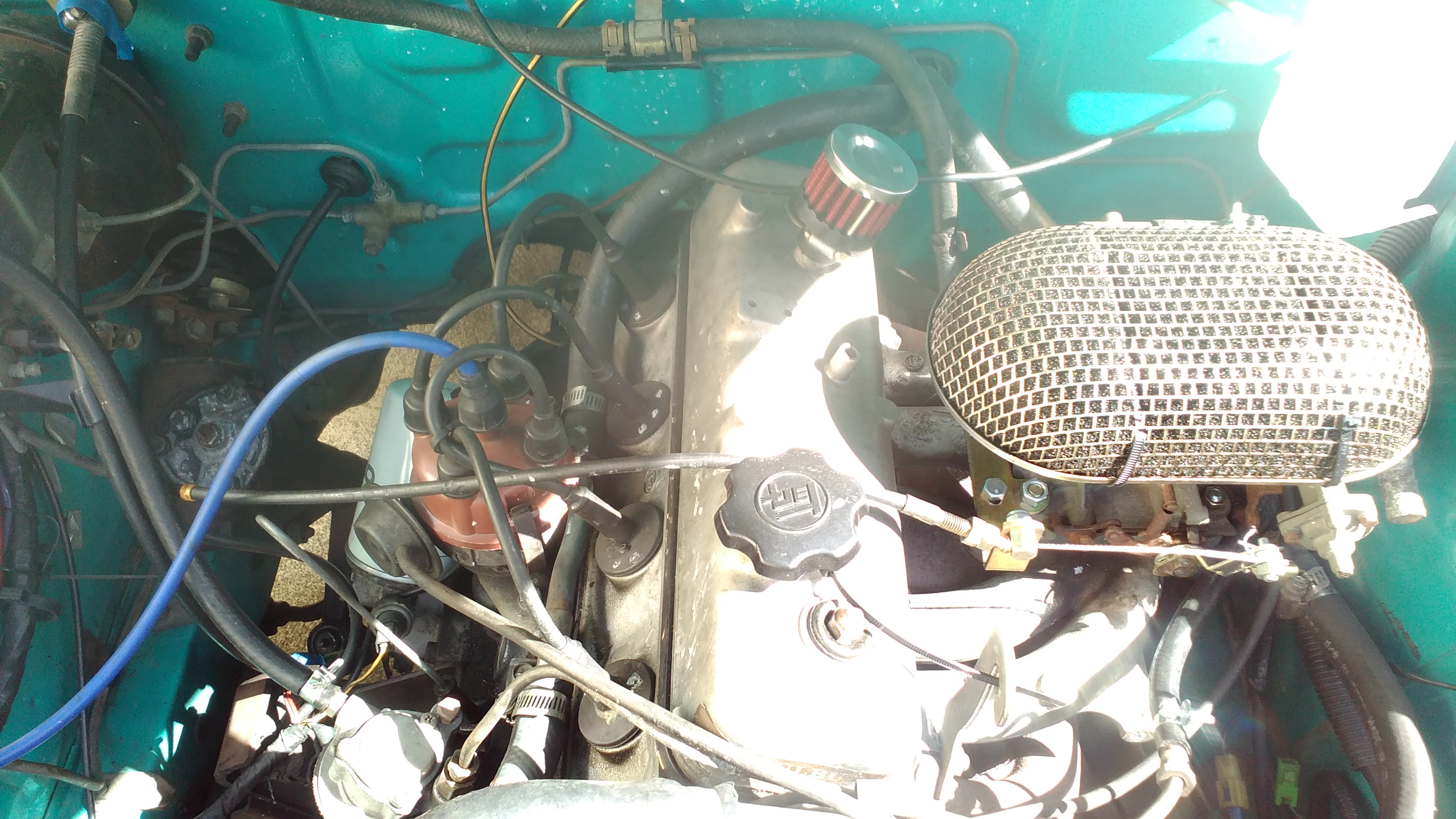

  14. Hi all, I have a mystery for rollaclub's finest... I've just dropped a freshly rebuilt 5k into my KE55, and had success for the first night of driving (about 45 km). Then I noticed a flat spot under medium acceleration. This got worse and worse, to the present, where it is undriveable--bogs down and shudders when trying to accelerate past 20 km/h in any gear, but will go ok with my foot to the floor. I've taken the carb (Weber 32/32) apart and cleaned all the jets, adjusted the flat level and checked the needle and seat. I've also changed the ignition points and checked gap and ignition timing. Initially I suspected water in the petrol tank, but having filled a bucket from the carb inlet hose, and inspecting the fuel being pumped through, it seems completely normal and un-gunky. I'm a little lost as to what to try next--I thought of changing the ignition coil? But I'm not totally sure what these symptoms would point to as the next step. Any help would be much appreciated!! Cheers Jasper

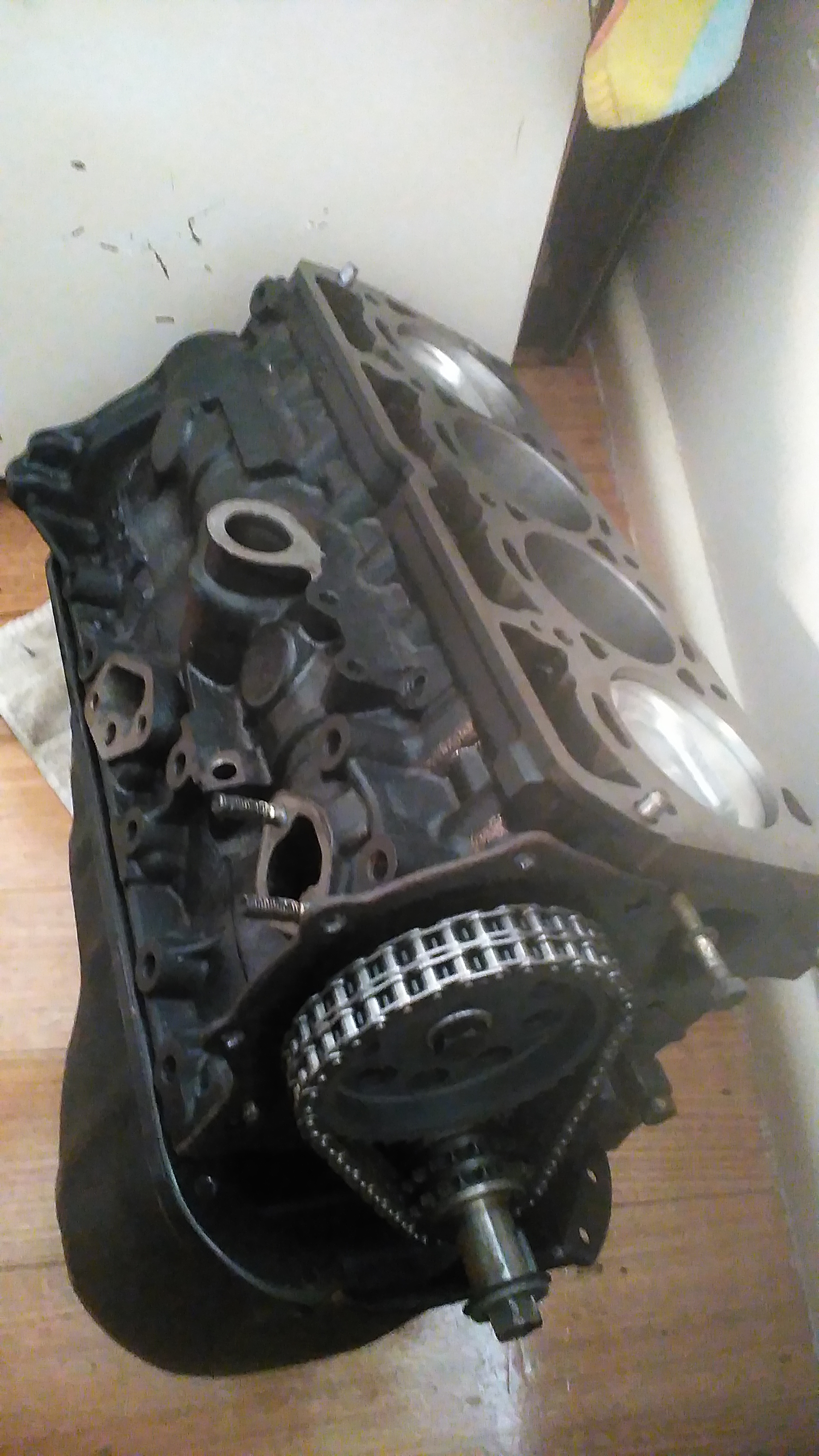

  24. Planning some work on my KE55, time for a build thread. Here goes: I bought this stock as a rock KE55 a few months ago, and have been pouring time into learning how everything works and repairing whatever issues spring up. So far, I've changed the stock carby to a 32/32 weber off a fiat 500 (or similar), given it a thorough tuneup, done a couple of suspension bushings, etc. and changed the clutch after it exploded when I was interstate. It's developed a decent misfire, and I've diagnosed this as a piston ring issue. The motor also has just on 200k kms on it. I figure if I'm going to take the motor out to fix it, I may as well change it for a 5k! I picked up a 5k (not sure what vehicle it was from) that has had a full rebuild and never been run: cylinders have been honed, oversized pistons, all new bearings, head tested and cleaned up, new double row timing chain and a clive cams 265 duration cam grind. It didn't come with anything attached, so dizzy, manifolds, carby, alternator, fuel pump, flywheel clutch, oil filter, engine plate, etc. are all going to come off the old motor. It's also missing the pushrods, so I am planning on getting these this week and putting the motor back together with a new head gasket, doing the welch plugs, gaskets and seals, and generally getting it ready for the other motor to come out so the old parts can be transplanted. This is my first time doing anything this involved, so there has been a lot of reading the yellow book, gregory's manual and the how to build a tough 4k thread. All things going to plan I will find a hoist to borrow and try and drop the new motor in in the next fortnight. I think I'll need to take it to an exhaust shop and get a full exhaust (including extractors), before the swap, since the cammed 5k in unlikely to run too well on the stock exhaust. Here are some photos of the engine bay as is, and the 5k parts: I'll update as it comes along, and will probably need advice on this or that! Thanks for reading Jasper
