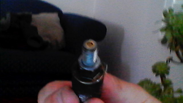

  4. Now that I've removed the solenoid I can see why there is no click, etc--looks like a past owner has disabled it like Altezza has suggested. I guess one option is to replace the solenoid, but if it has been cut all along would that suggest that it's not the cause of the idling issue? Cheers

  6. Thanks for the replies Banjo and Altezza. I stripped the remaining 1 cm or so of the solenoid connecting wire, and connected it to the battery positive terminal while the solenoid was still attached to the carb (I assume this has the same effect given this is where the solenoid is supposed to function, and the engine is negatively grounded). I did it there because it was quite stubbornly in place screwed into the carb Is there anything else worth trying before changing the solenoid?
  7. Thanks for the quick reply! The wire has been cut right near the solenoid end, so I think I'll have to find a replacement. Can a new one be found somewhere and bolted on?
