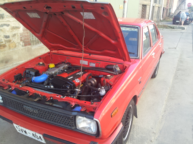

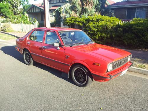

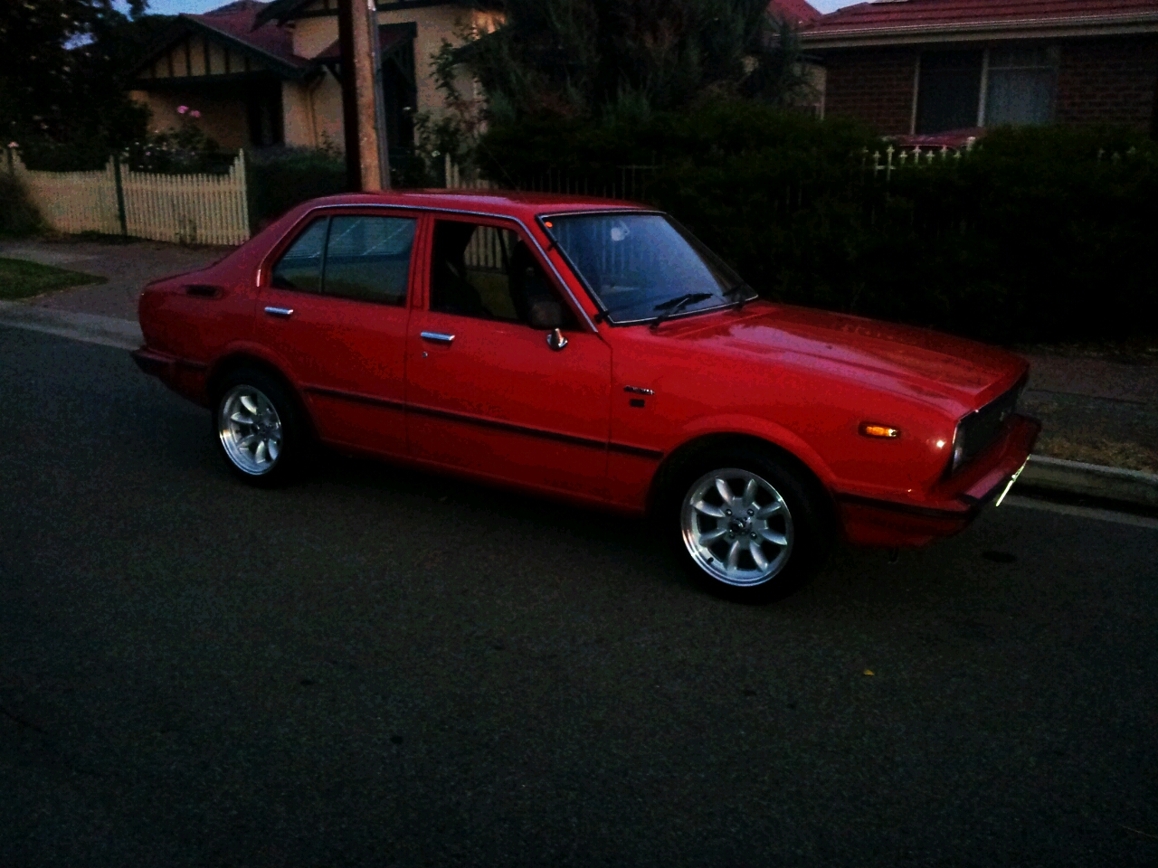

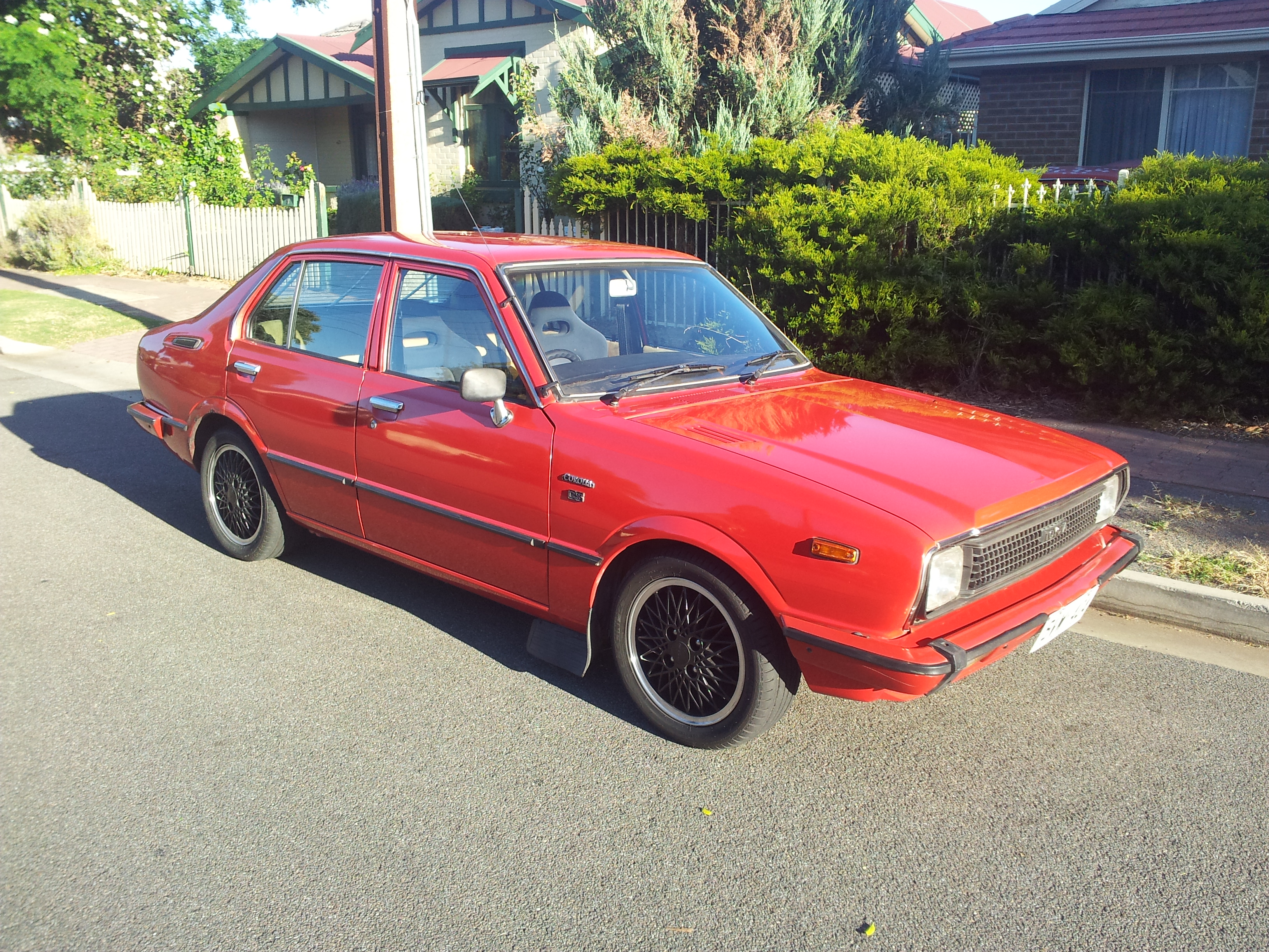

  1. Hi Guys, So its been ages since i made an update. The car is now finished and i have taken it to a few track days at Mallala. The car now has: Minispool Venetian blinds boost controller xt130 lower control arms super lite wheels - 15x8 rear 15x7 front and a few other small things. Heres some footage from Mallala and some more recent pics :) http://www.youtube.com/watch?v=FuIjtTw9otg&feature=relmfu http://www.youtube.com/watch?v=YeV56osugis&feature=relmfu http://www.youtube.com/watch?v=KZm2sbZRTo4&feature=relmfu with the new super lites Next thing will probably be upgrading the front suspension to coil overs Cheers

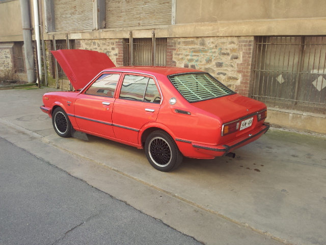

  4. We had to cut down the crossmember brackets and lay them back, so that the engine would sit low enough. very happy with where it is sitting now though. The leaf springs aren't new, they are the original springs, with an added leaf and reset at a lower height. I got them made up at industrial springs on port rd, and they gave them a coat of paint. very happy with how they turned out :yes:

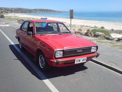

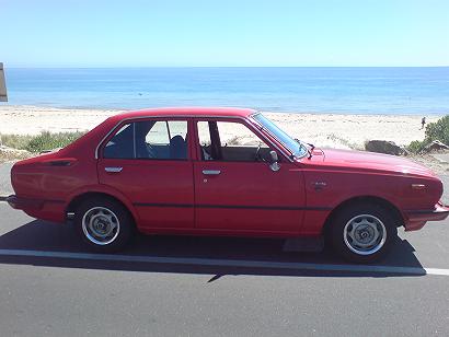

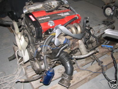

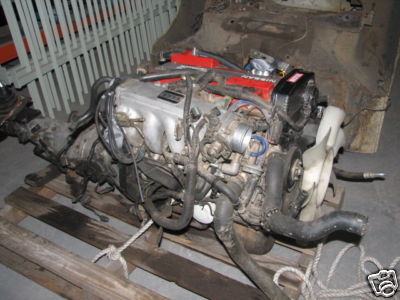

  12. oh ok cool, yea I'm pretty sure mine is just a cs
