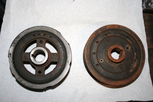

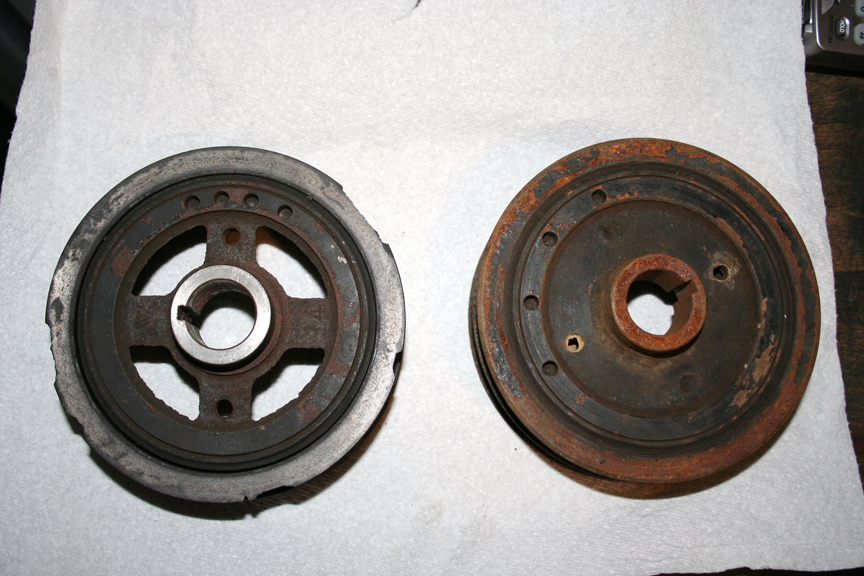

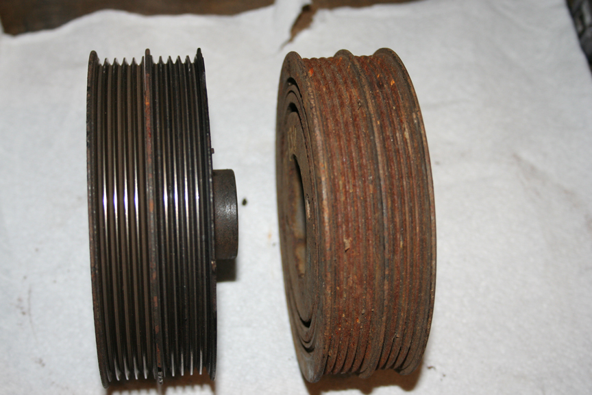

  3. 1990 Corolla GTS 4AGE FWD I have had this car for about 5 years now, my cousin had it before. As long as both of us could remember the electric cooling fan runs soon as the ignition is turned 'on' or when the car is running...then the fan runs constantly never shutting off. I have replaced the fan relay switch(fuse) and the temp switch (or ETC I think its called?). Hasnt fixed the problem. I have two different repair manuals both have really no info on the problem of running continually (Chilton and Haynes manuals). I have been pulling apart my wire harnesses trying to find any loose connections or what have you, no luck so far. If anyone has any suggestions it would be terrific. Also posted some questions about harmonic balancer w/ pics.
