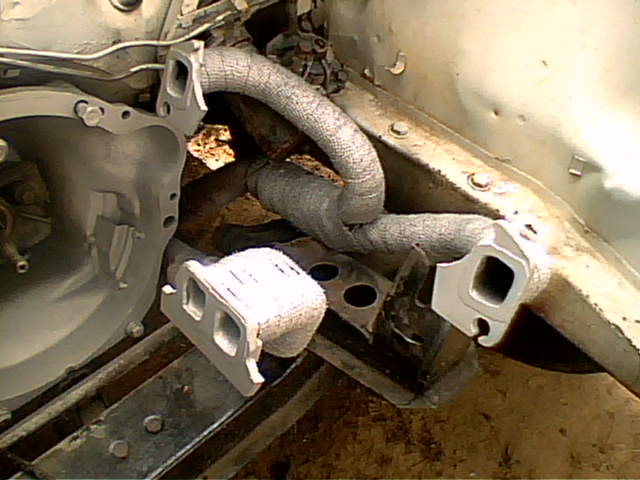

2 2-1 headers with dual exhaust (made em myself)
