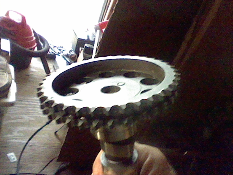

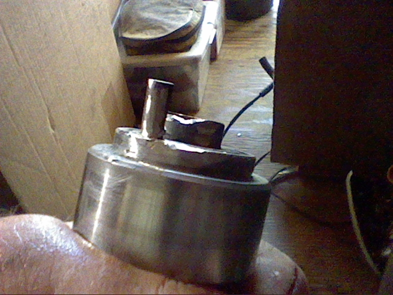

  2. Well, let's see how this goes...I still have a little smoothing to do and take the pin down a smidgen til it's dead flush. Welded the pin in, filled it in and ground it, yep cast is a pain. I gotta get the dremel to finish it, I knicked it up with the bigger wheel. Would it be better to shorten the pin more? It seems like the factory pin only went halfway through the gear. It's ugly but should be functional. Wednesdays are short days at work, I'll see if I can get it together tomorrow afternoon and see what happens.

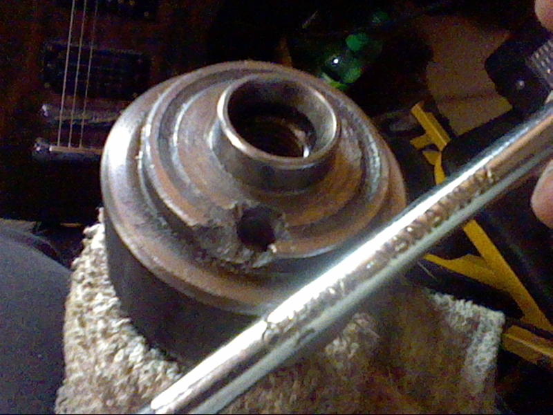

  4. Hey Rob, I will weigh this one and see if I can figure the postage and what size box. I would need a zip code or whatever you use to get an estimate. Mine is 72210. This is what I'm planning for the moment because I want to be driving this weekend. I got the leftovers out of the hole, I've deepened it slightly with a matching size bit (making sure I stayed centered) to give the hole a bit more strength and I'm going to use a piece of the shaft from this chrome vanadium screwdriver as a pin and weld it in and fill in the gap, grind it smooth and should be...should be...good. We've got a good wire welder. Except for that breaking problem this cam has no visible wear at all.

  7. Welding isn't out of the question. I'll try to get a picture tomorrow. The pin hole is now more of a channel to the outside edge. If it wasn't outrageously expensive I figured a new or unbroken cam would be safer. I'll have to find another pin or make one, fill the gaps in and grind em off. Any problem with it getting out of balance maybe? That's the main concern of my buddy with the welder. As I said...my last ditch effort will be to spot weld the gear directly to the cam and hope it's the last time I need one so I'm not pulling this one out until I have a solution in hand. The car should outlast me the way things are going. I'm going to see if i can magnet the lifters out so i don't have to order new gaskets and pull the head. and would like to keep the new standard bearings in too, they only have 300 miles on them. Really hoping to just slip this one out, slip a new one in and be running in an hour. We have a really strong bar magnet that I may be able to just stick to the side and hold all the lifters up at the same time while I slip the cam out. If it works I'll let ya know. i hurt my back the other day and haven't made it back to the big shop at my buddy's house. I can barely make it to my smoking hole, I mean my workshed, where I do important work, outside. From looking at it it seems to all boil down to, the big washer I used failed, wasn't thick enough, the gear tried to ride over the pin and pushed it out the side. When you have to put stuff aside for months, and move them around, things come up missing. That will definitely be remedied. I would have thought the pin I made would have been weaker than the solid steel cam. It was just a roll pin with a piece of a nail in the center that tapped into place. I even put a pound or two extra on the bolt torque. the bolt was still tight but the washer was bent. I think a hard shift into 2nd may have set it loose, it died about a mile later.

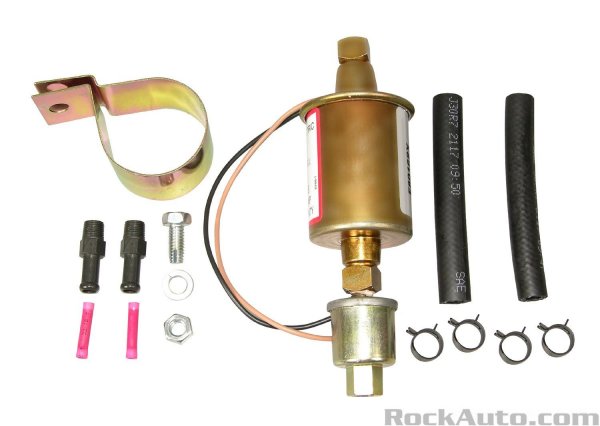

  15. Thanks for the info, seems it's not just bolt in place. The oil pressure cutoff switch seems like a good idea, would a "momentary switch" be good for priming? Only works while pushed. This is what comes up on RockAuto as a replacement, and to me looked like it just went on the fuel line somewhere along the frame. Under the hood somewhere was what I was hoping, my right side frame and firewall are mostly open as my steering is on the left. The original glass bowl is there but no filter in it, I've got a filter inline between that and the pump. they never seem to go dry so I thought a pump mounted on the frame below the glass bowl would have no problem staying primed. it would be below the level of the fuel tank. It's pretty noisy up front already as I can't seem to get that perfect valve adjustment like I used too. I do the 1's open adjust 8 method. I'm wondering if my replacement pin on the cam has let the gear move a smidge. It did not fit perfectly tight in the hole on the gear. If it did that would make everything just a tiny bit late. I torqued the gear and then a tad more, I may have to pull the timing cover to ease my brain.
