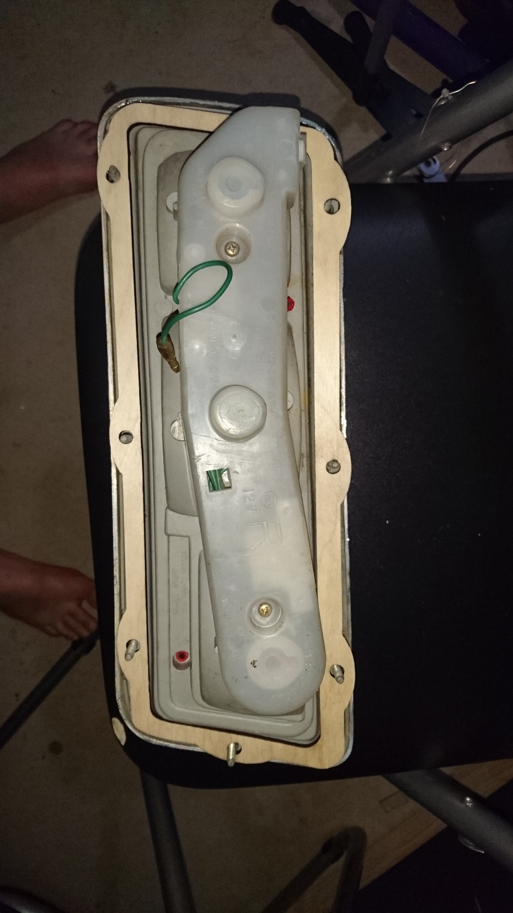

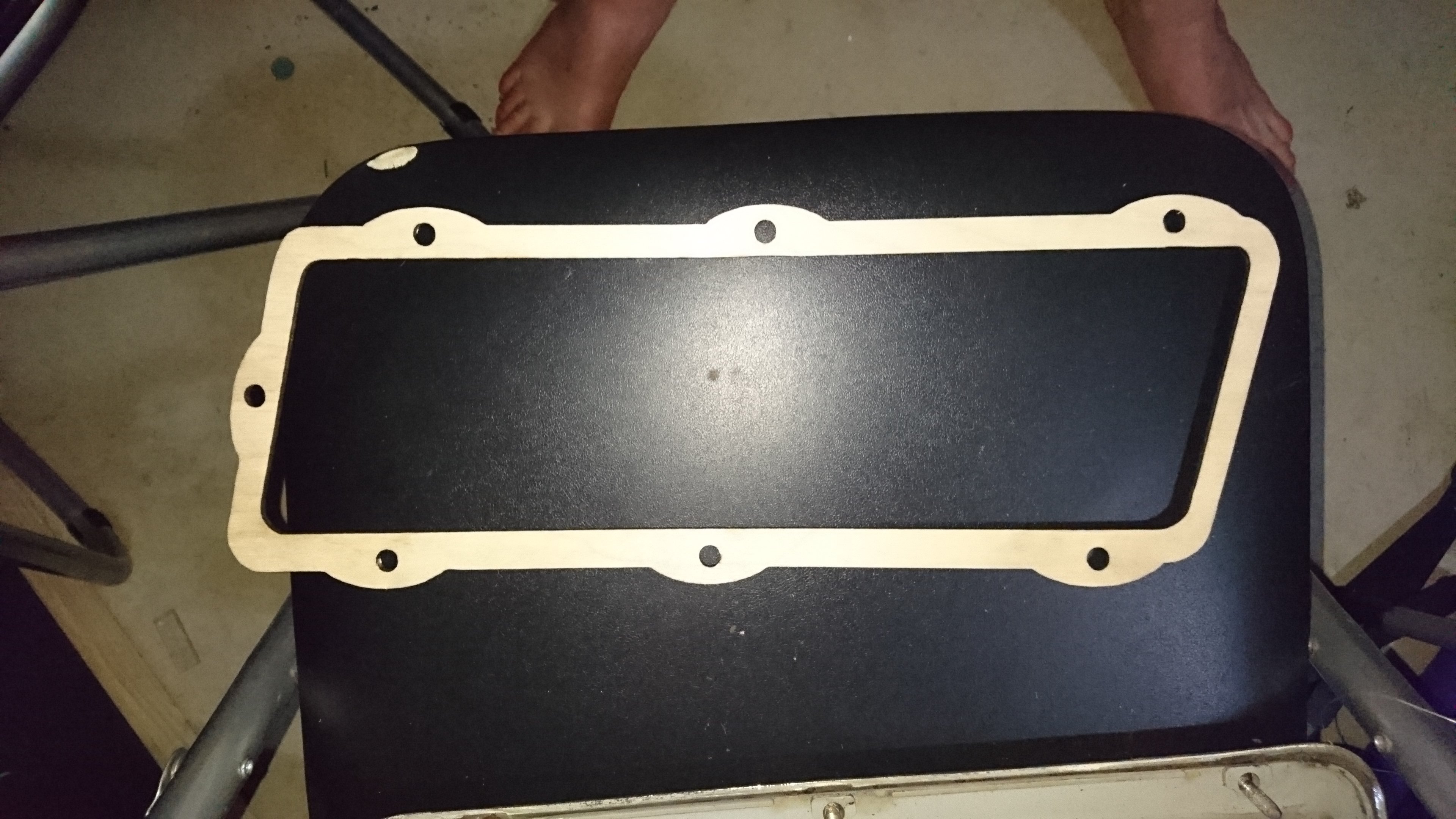

  6. Hey lads and ladettes, welcome to midnight! So ive found some UV treaded neoprene rubber that I will be using to make the taillight gaskets from. It needs to be UV treated so the gaskets last the life of the cars, unlike the factory gaskets that only last a very short fortyish years bahahahaha :-D I have traced my old gasket and transferred the very rough trace to my cad program. I cleaned up the trace and laser cut some plywood with the design. I thought it best to cut the inital gasket shape from plywood, as i can perfect the fit to the taillight to the millimeter, as ply has very little flex, unlike rubber. It does not quite fit as per pictures, but I have adjusted what needed to be adjusted and will cut another tomorrow to retest the fit. Hopefully in the not too distant future, ke30 sedan owners everywhere will know what it feels like to have one less leaky spot in their boots :-D Regards Mac.
