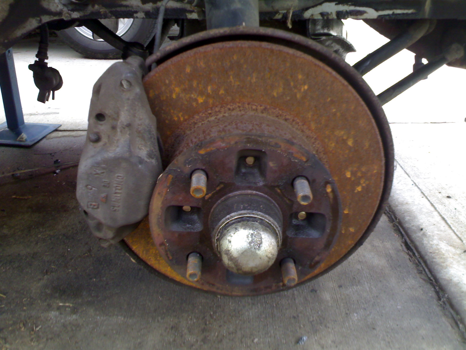

if you are lazy like me get some corona brakes from a rt132.
big brakes easy
you need to get super low springs to just go low coz they 380mm long not 340mm like my rollas
