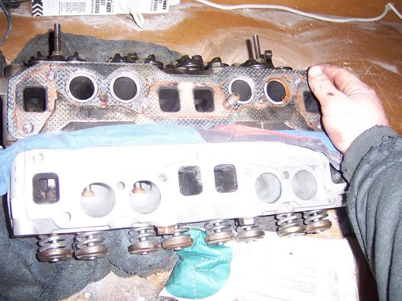

Usual type of head work is port and polish, valve re-grind, maybe bigger valves, stiffer or double springs, as you've said. Depends how far you wanna go. Speed and power cost money!!
Heres a pic of some decent sized ports compared to normal 3/4k size.
Other thing to remember is though, if you're going to put a cam in and port the head etc, you really need some extractors, decent exhaust, and a weber or similar carby. You should be able to get a suitable weber pretty easy off a alfa or fiat. Something like a fiat 128 carb is perfect!
