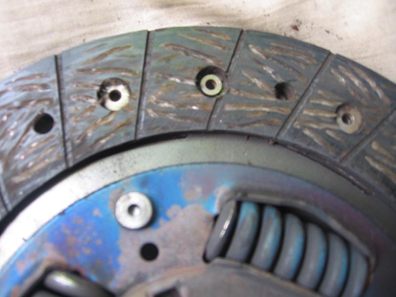

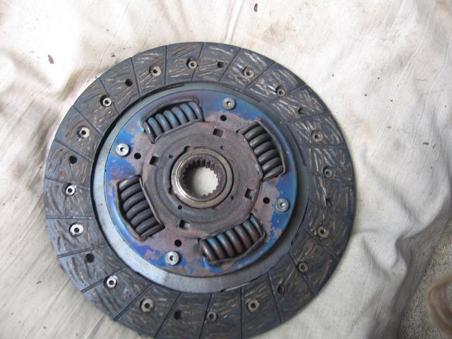

Well i pulled the clutch of my 4ac as i don’t need it any more because i'm waiting on a 4age to put in
i pulled it off and found this i don’t think this is standard Toyota gear although could be i don’t know this is the first corolla I’ve worked on properly
the paint is funny its got a iridescent shine like an oil sheen its weird
and also looks like its been laced with string, better gripping???
the pressure plate is repco brand but i couldn’t find any number or code or brand name on the clutch plate got me stuffed
cheers
Edited by ae174agze
could easily be standard, looks more or less like most clutch plates
my 71 had a repco clutch exactly like that one not to sure if it came stock or it was a replacement some time during its life? I think the reason why your clutch has the irregular paint work on it is because this clutch has got extremely hot at some stage in its life. I had a extreme organic heavy duty in my 71 after my repco one had died and when i pulled the box off again my clutch had these exact particular marks like yours on it. Has this clutch been abused at any stage in its life? Mine had been abused regularly and got hot often .so maybe the same or similar thing has happened to your clutch ,probably the reason why its has these marks, this is just my opinion but i could be wrong though.
