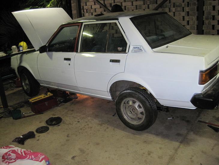

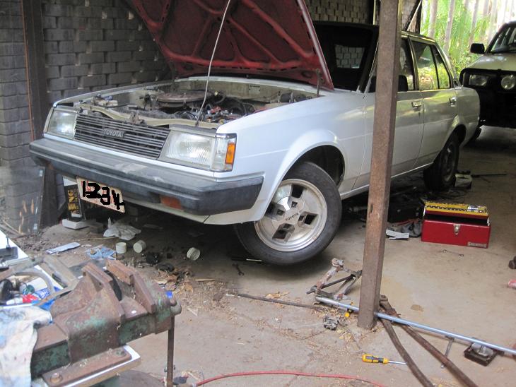

  15. YAY finally got the clutch in and the new master and slave in and working, what a mission because i couldent take the engine pipe off had to lift it up and over was a bit of a prick, everything else when faily nice and easy couple of piccies me shit that finally rocked up all in and finnished flat friggen battery, quick charge tonight and i'll go for a coroll tomorrow as it sits now

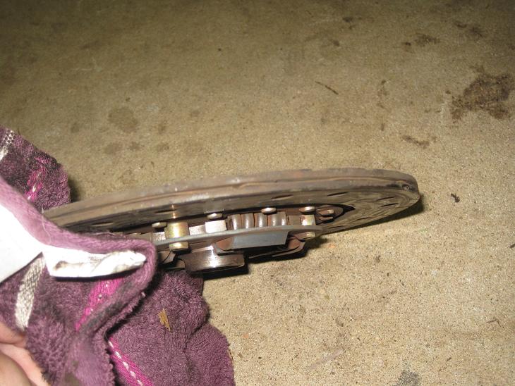

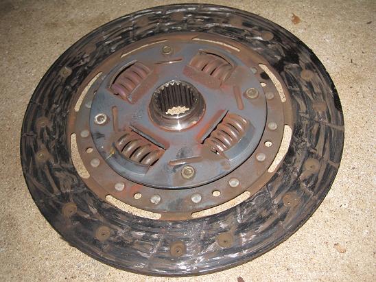

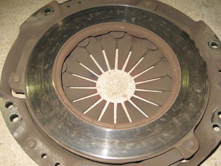

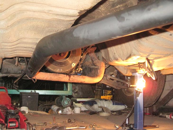

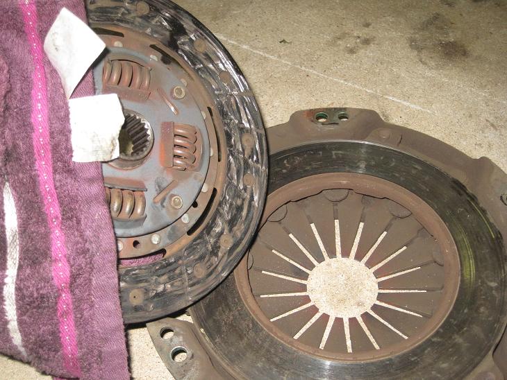

  18. breaks were from a j p s, cost alot don't ask i finnaly got around to getting the friggen box out, bit of a pain in the ass as the fella who did my exhaust cut the flange for the engine pipe so i had to sort of lift it over the exhaust, was harder than it should have been, other thatn that it was pretty good and the clutch was pretty mutch munted no dammage to it just pretty mutch worn flat, and really really shinny, they both where really shinney you can sortta see here that there isnt mutch meat left it was worn flat current pic as of about half an hour agow

  21. current pic just waiting on clutch parts

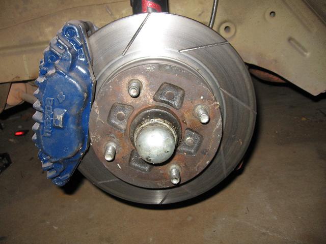

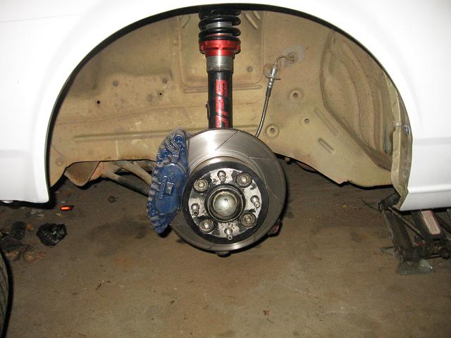

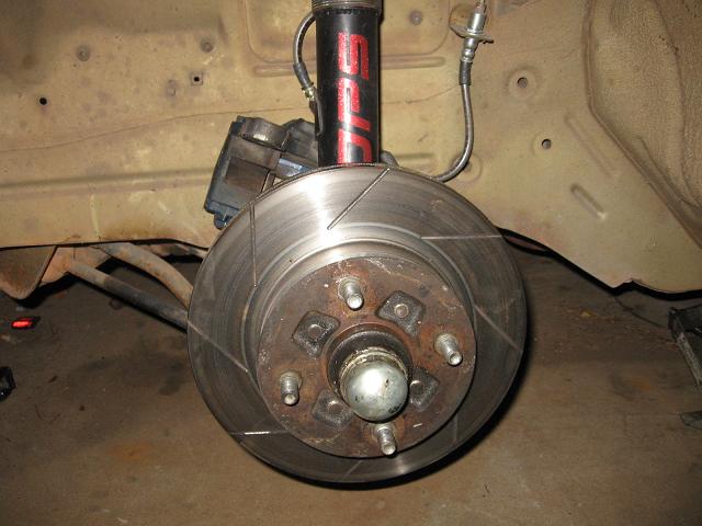

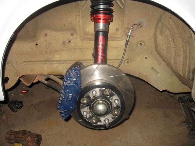

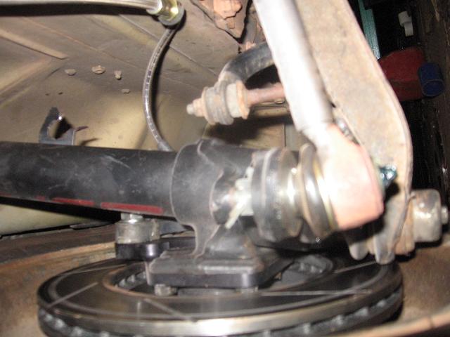

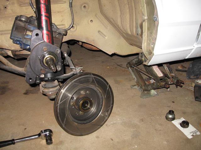

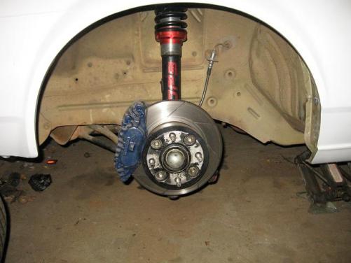

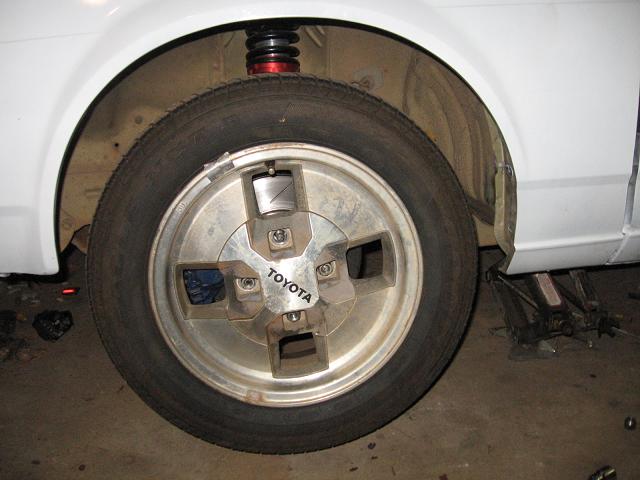

  25. cheers man today i found out that my LCA had drawn a nice big round scrach picture drawn into the back of my break disk, after i took it for a drive thaught i might show you how i fixed it with a sledge hammer :dance: started by jacking the sucker up and taken the wheel off, safty first, jack it brick it with the wheels off i was able to get the 25mm bolt on spacers off got the spacer off and undid the nuts that hold the calliper on whitch ended up like this, then wedged off the cover thingo and undid the nut on the bareing pulled the hub and disk off and fliped it over to see that the LCA had gorn to town on the back of the disk so i got a sledge hammer and tapped the edging in, just enough so the disk wont touch, friend good help aye :S put the sucker back together and where good to go theres probably 7mm gap now so no touching on the break disk this has to be done if you do the rx7 4spot conversion, i found out the hard way, might have to get a new set of disks posten this up just to let you know, cheers fellas
