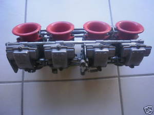

Pics are coming.... Bit of a teaser below, just brought them tonight.
