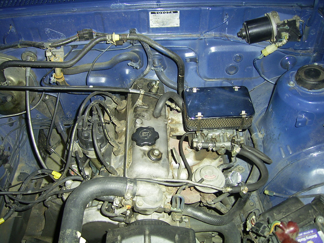

I just received my 32/36 dgv weber. Does anyone have pics of there 32/36 dgv setup on a 3k motor, so can put my on correctly?
Really not many ways it can go on mate, it'll only fit the adaptor plate 2 ways.
Thats not what I need to now, I need to see where all the hoses hook up to , on a 32/36 dgv there are to valve's that open up on tpp, there isn't anything that hook's on to mine? I just need to see where all the linkage's hook up too.
Here is a picture of a 32/36 on a 4K, which is essentially the same thing.

Do you have a pic of carb without the airfilter on , I need to see if the top two square valve's are hooked up to anything?

Hey mate. I could remove the air filter, but it won't show anything helpful :yes: The carb has had the choke removed sometime in it previous life, so the "square valves" are non existent. Sorry, I can't help you find out where they hook up, as I have only ever had mine w/out a choke. You might get the info you need from another Rollaclub member, other wise, look on the net for a 32/36 Weber exploded diagram. That should show you what is connected to the choke plates.
haha, square valves. The choke cable should hook onto the choke lever without too much stress. You should have a choke cable, the pic above you can just see bLinded's choke cable running next to his throttle cable.
If you don't have it, pull the chokes out, just have to pump it to get her to start!
