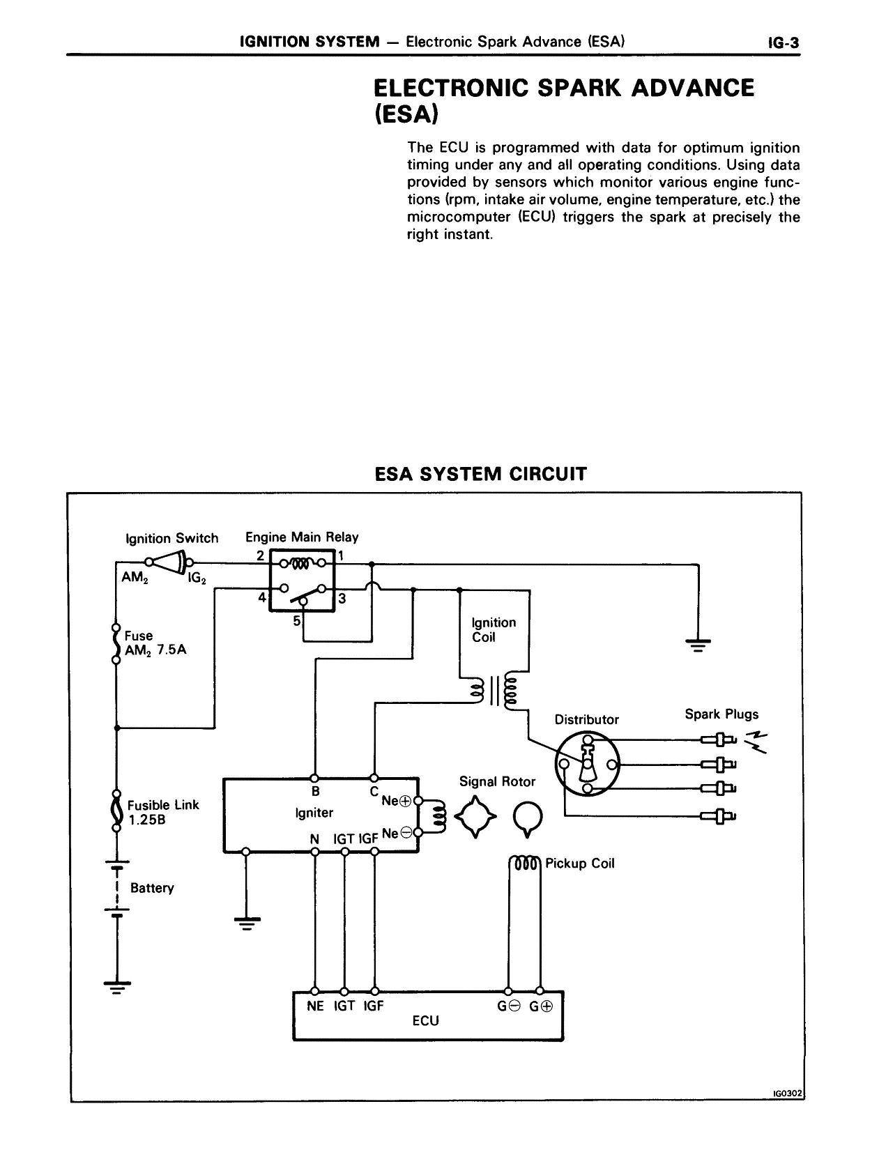

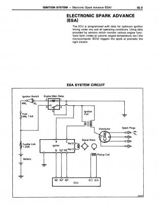

was sold a coil and ignitor, apparently for my smallport.
problem is - were having troubles identifying exactly what the 4 wires correspond to... we have every single wiring diagram and pin out diagram the internet can host in several hours of foruming and googling!
apparently smallport ignitors arent supposed to have 4 wires either... apparently? do i have a camry ignitor or something? or should i stop listening to my mates who say my shit is wrong?
can anyone confirm this?
