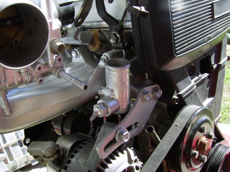

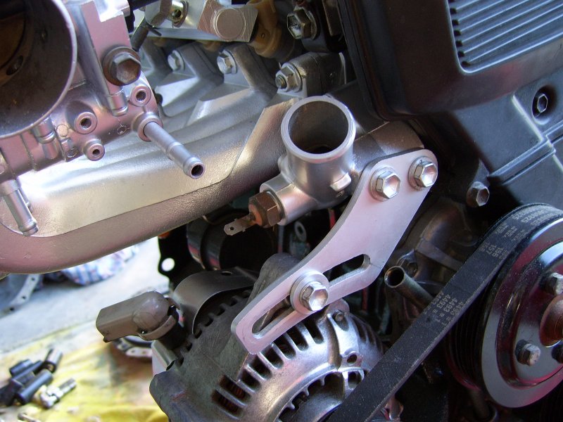

The AW11 MR2 4AGE head water inlet points straight up in the air, probably not good to pipe water into it at a 90 degree angle. An AE92 100KW 4AGE head water inlet points up and to the front at an angle, probably better suited to the job. Also note the alternator tensioning bracket mounts to the head water inlet. I did some hunting and got hold of an AE92 100KW 4AGE head water inlet, they are hard bastards to find too..
