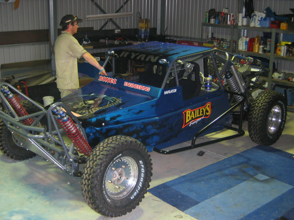

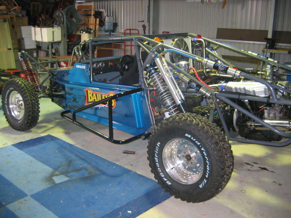

Hi there i have a 4age 20 valve silvertop in a offroad buggy i am running a microtech L10 computer
i'm looking for a bit more power so i'm thinking Cams, Extractors,Adjustable cam gears ETC!!!
any one with ideas of what sort of gear to use that would be great and just a couple pics of my toy:hmm:
