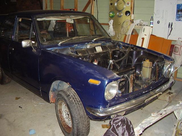

The car is a 1970 KE11 2 door sedan. Bit of basket case when we got her, but it is slowly going back together. The plans are as follows:

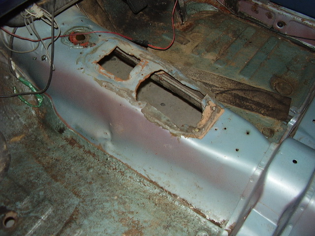

Gearbox/driveline: k40 out of ke55, standard ke11 borgwarner diff. Holes already cut in transmission tunnel, plans to neaten the mess up and make the ke55 box fit neatly as I have a few of them lying around. Unsure about changing stud pattern.

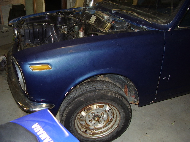

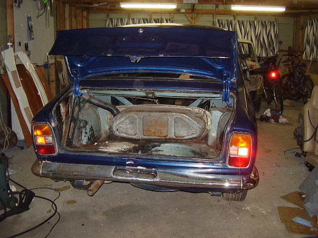

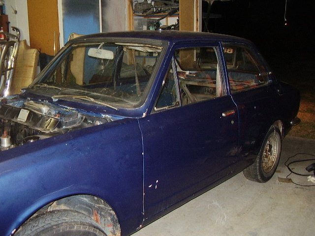

Body: rust to be repaired, paint to be repaired. paint is 2pac over acrylic, not a huge fan of technique or colour, but I will be repairing what I've got. Already adjusted doors and had drivers hinges rebushed. have to bend boot hinges to identical shapes as they are wonky. Have to buy bonnet, paint valance and bonnet, repair rust in guards, clean behind guards, and touch some paint up. Plans for sealing boot off and engineering as two seater, sheet aluminium to be used to seal boot and probably replacing door trims as well. New carpet, small non reclinable race seats. Have to repair broken seat mounts, and sort out strong mount points for race harnesses, not happy about how seat belts are at the moment, I think they would pull out of the body in the event of them being needed... Plain black three spoke steering wheel to be fitted. New rubbers need to be fitted.
