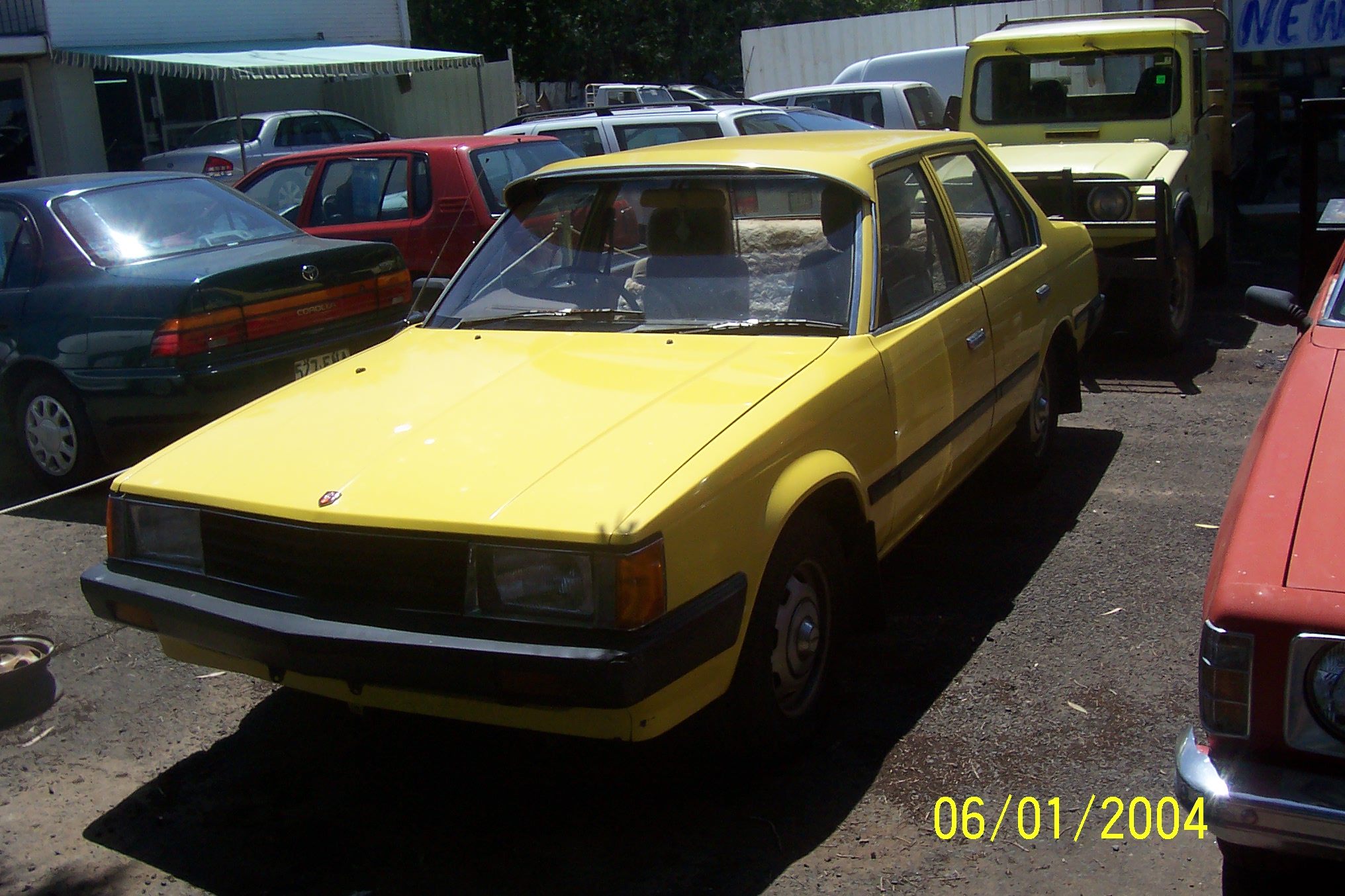

hey I'm new to this forum but have learnt alot from them in the past when fixing my 3 wheeler.. my newest project has been a stock 83 toyota corona with a 3 speed auto.. it has 148 000ks. it ended up out front of the wreckers from a deceased estate... by the time i got it 6 months rego it had cost me about 900$.. the car drives perfect, the 3 speed lets it down but otherwise its great.. it likes doin 80ks before it sounds like its really drinking fuel.. my mate said he had an old turbo laying around i could have and now I'm looking for ideas.. heres my thoughts anyway.. let me know what u think...
