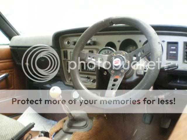

Race Wheel
Rev gauge, Oil press, Water Temp and Volt meter.
Battery Kill switch
Push button starter.

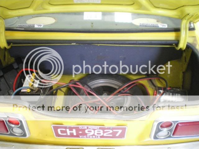

Battery relocated to the boot

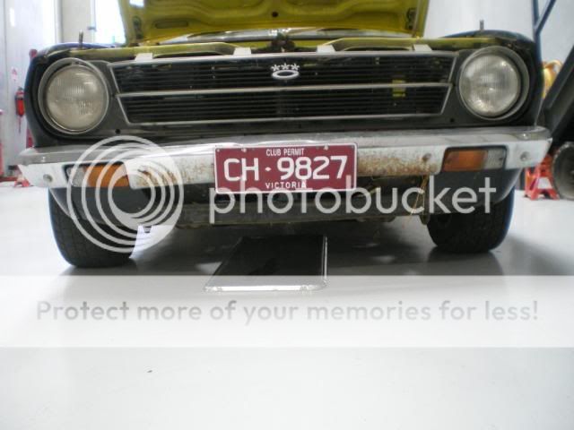

This car sat at my house for atleast 18 months and didn't move. So Ive decided to give it some life again. With starting my New business Grumpy Automotive Developments I thought this could be like a shop car that I work on and build up during spare time.
The bad pictures of how it looks now.
