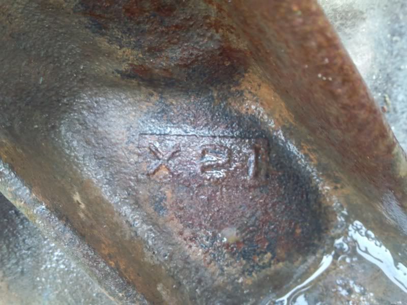

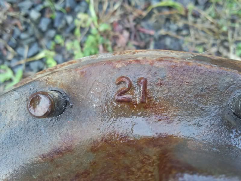

MattyZ Posted July 14, 2010 Report Posted July 14, 2010 Hey all i was looking on the diff from my ta22 and found these 2 numbers and was wondering what they meant one on the center around the bolt pattern has a stamped E then a bulging 21 picture below and on the center it has on a tag X 21 if anyone can shed some light on these cheers Quote
Trev Posted July 14, 2010 Report Posted July 14, 2010 On the Body plate... E is a 7.1" X is a 142mm 21 is 6.667 ratio. I don't know if this will be anything to go by. Quote
MattyZ Posted July 14, 2010 Author Report Posted July 14, 2010 On the Body plate... E is a 7.1" X is a 142mm 21 is 6.667 ratio. I don't know if this will be anything to go by. Cheers for that Quote
Trev Posted July 14, 2010 Report Posted July 14, 2010 I should of mentioned that E & X are the pinion size. Quote
