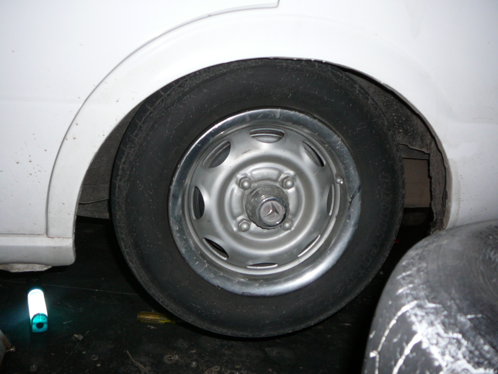

cheers 'e70van' i will look into it see how i go and heres a pic the wheels on it are 15" two peice dragways
