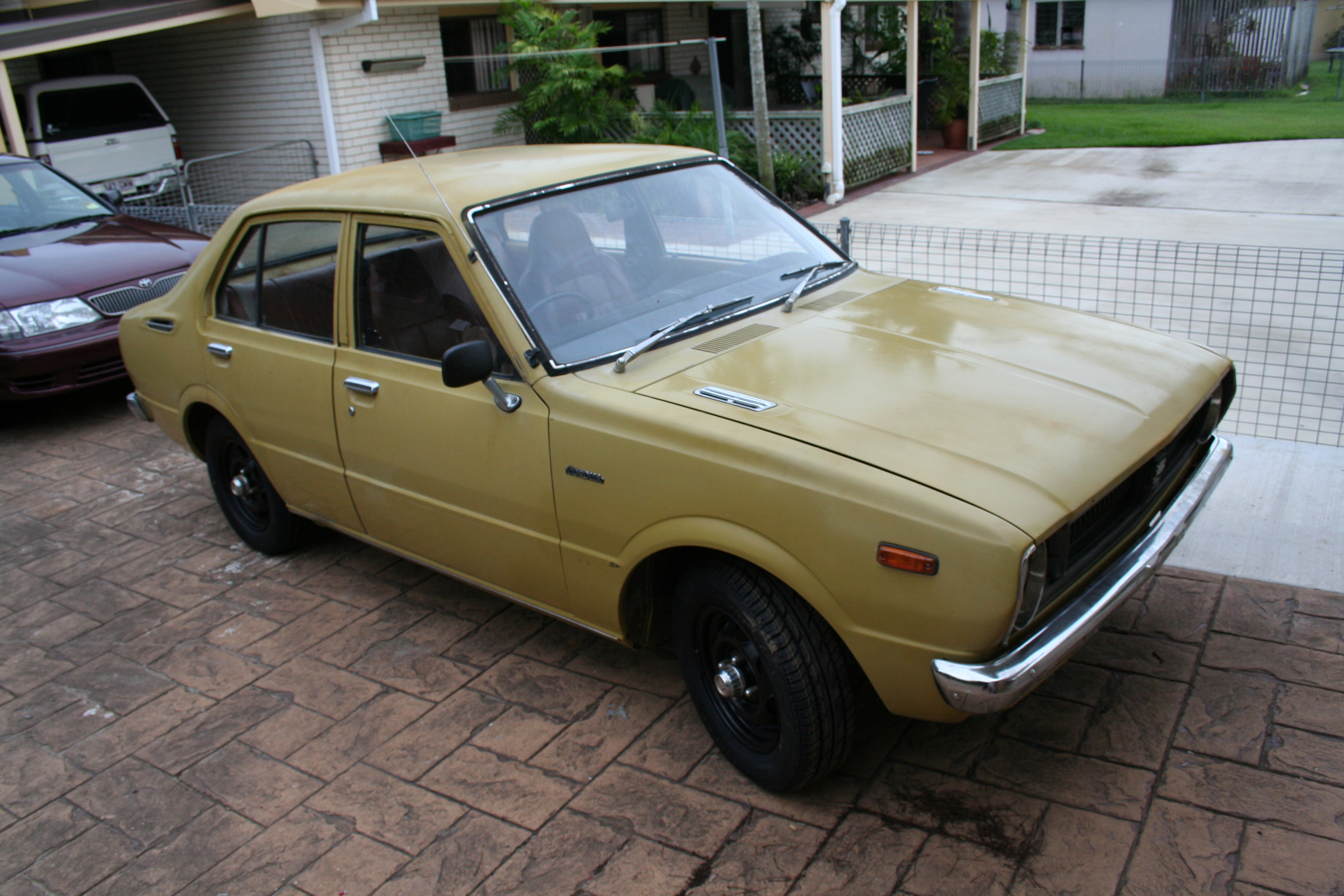

So the beast is getting there.

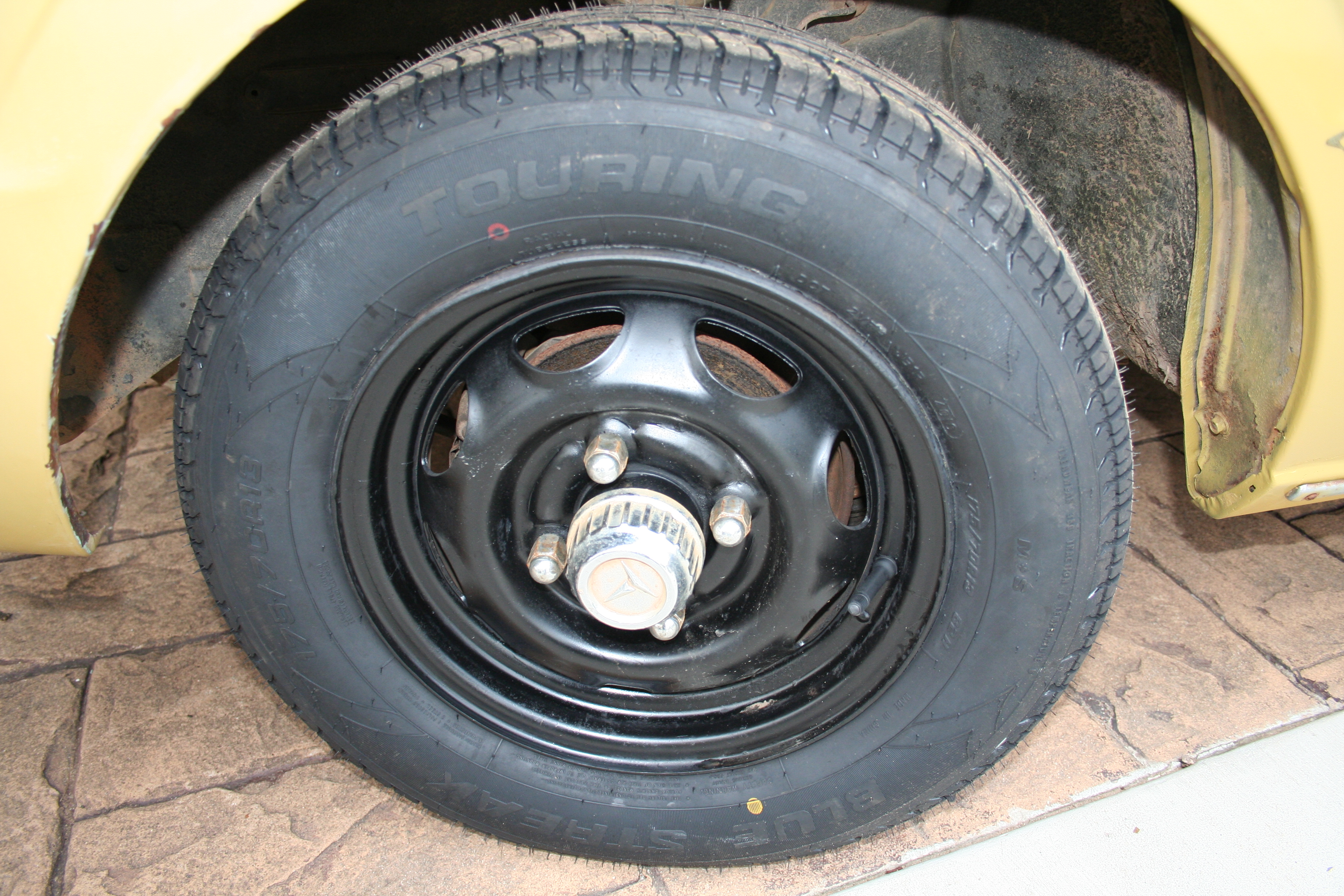

Painted the stocks black, They look fair mad now :cool:

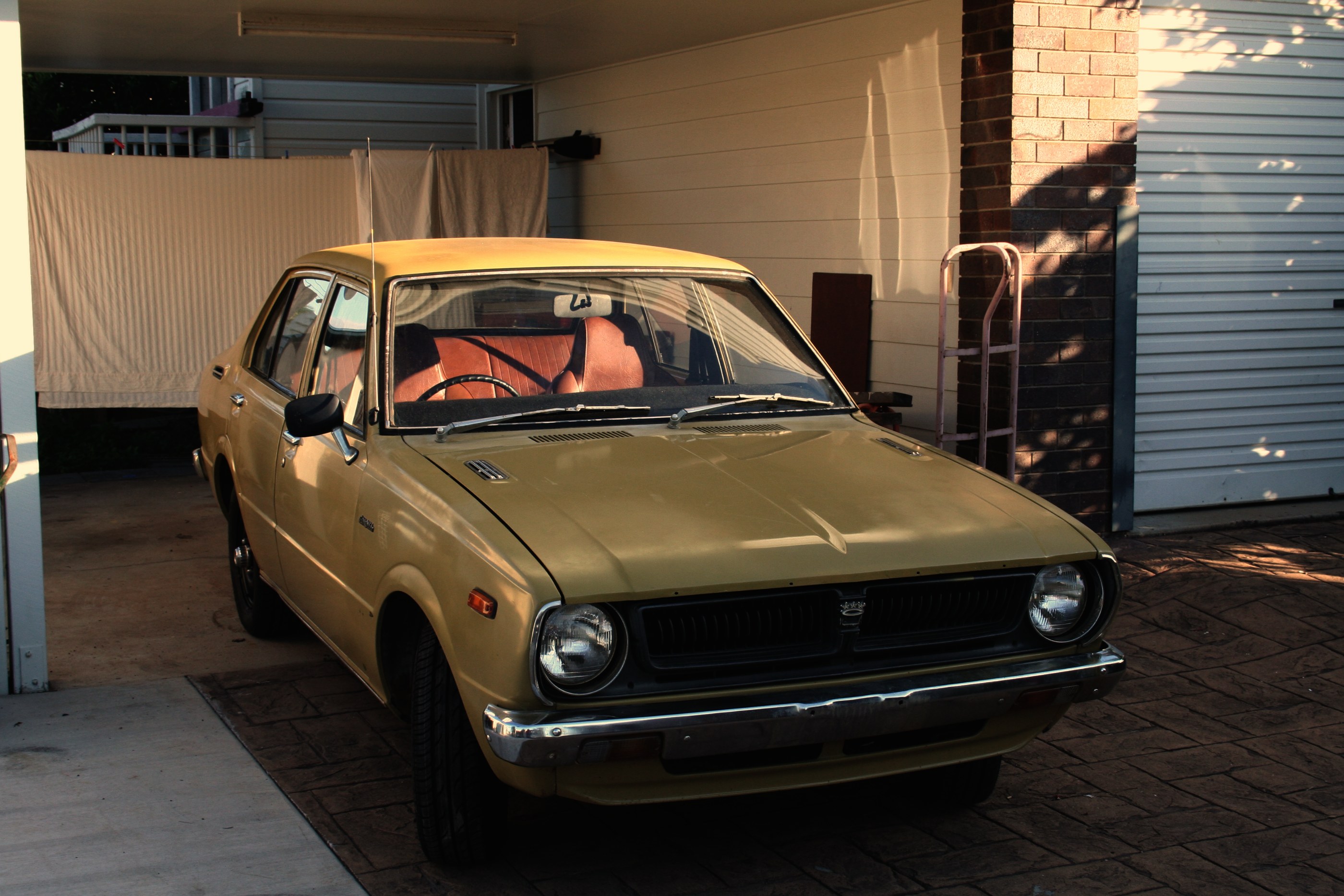

I Love my car, still gotta a lot that i can do with it, thinking about painting it? or do you reckon i should keep it original? I'm not too sure :/

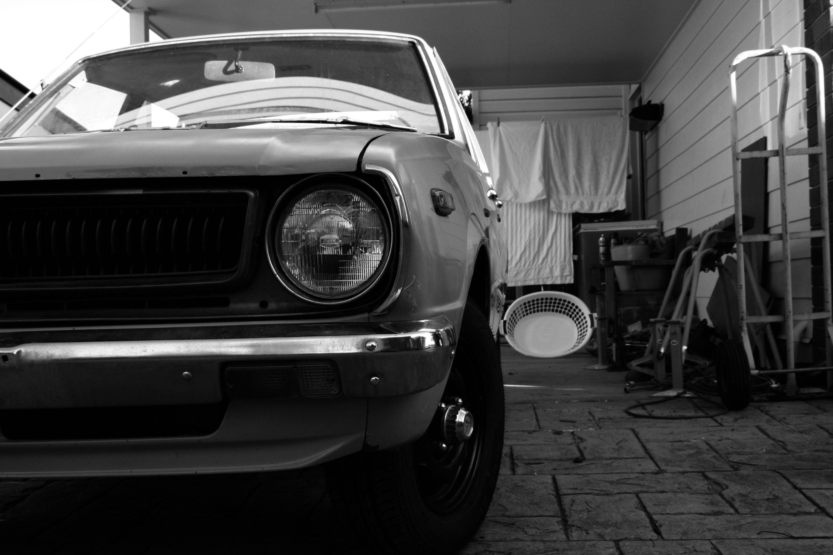

LIGHTS! :o :dance: haha ;)
