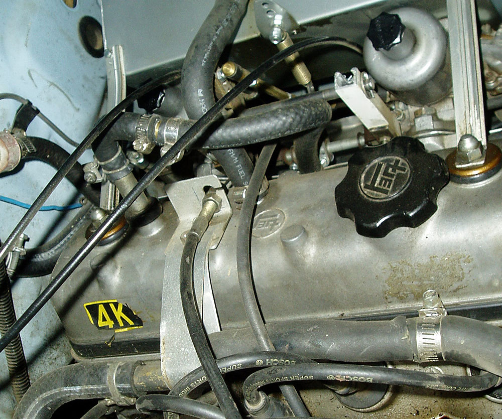

Do any of you guys with a K engine have pictures of a Weber 32/36 installed to see if I did everything correctly? Do you know what the screw behind the electric choke does? Did you use the old gas cable adapter or the one supplied with the Weber kit?

I used the holes in the tappet cover to mount a bracket. I already had a little alloy bracket holding the heater pipe off the dizzy, so I just added a right-angled bracket. You might have to have the cable in a different place with the Weber, but those are the holes to use.
