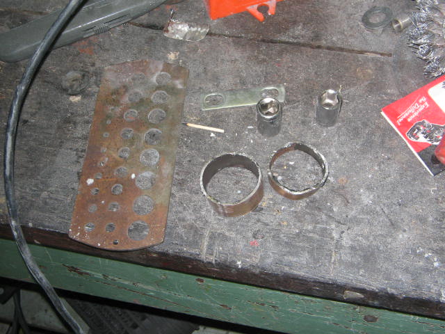

1 1/2" metal tubing

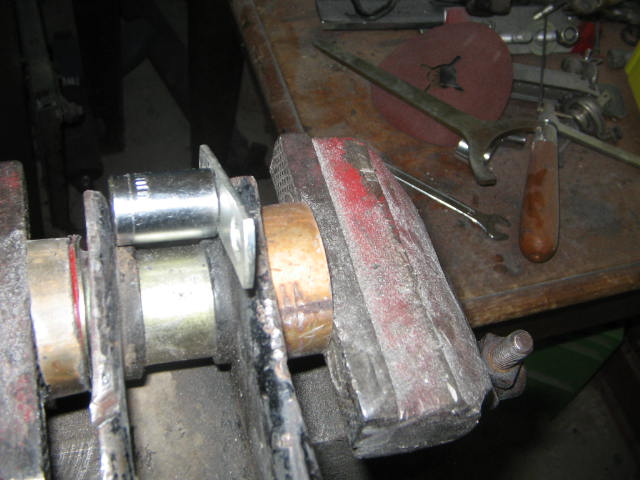

Now to get your new ones in. These are the items I used for mine. The metal tubing was my old exhaust I still had lying around; it is perfect for pressing in the bush.

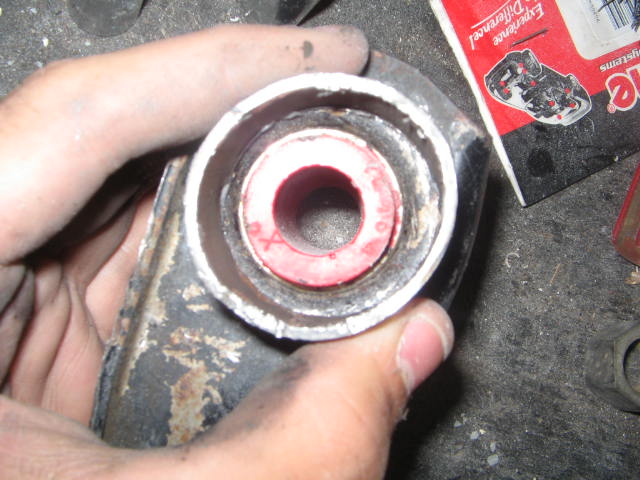

First push the new bush into the arm as far as it will go.
Next cut a section of your 1 1/2" piping so it covers the large end of the bush. Like so

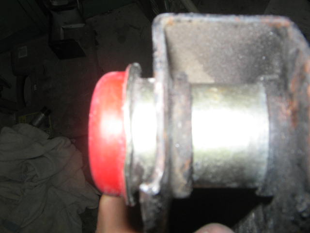

Next, place another longer piece of pipe on the other side of the arm, were the bush sticks out.

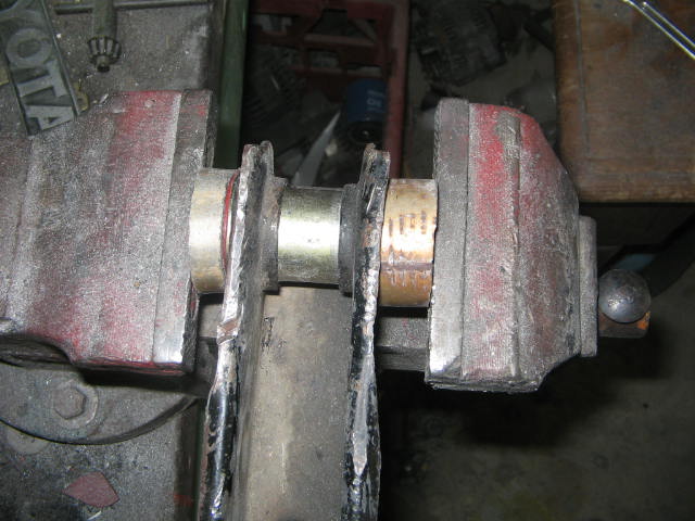

Now place this arrangement into the vice

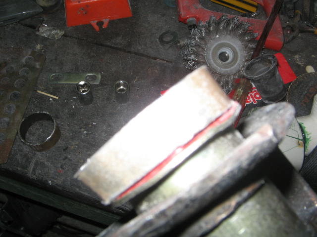

* Make sure the tube does not fowl the bush
Now pack the inside of the arm with metal to stop them flexing. When it flex it leads to much complication, as it will get harder and harder to push it in until you're vice brakes.......

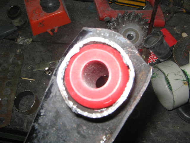

Now tighten up the vice until the bush is completely in.
There you go. Easy :P
