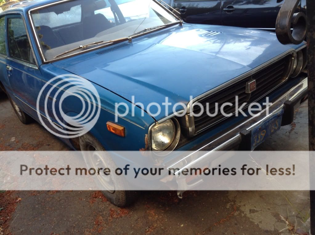

When I first bought it

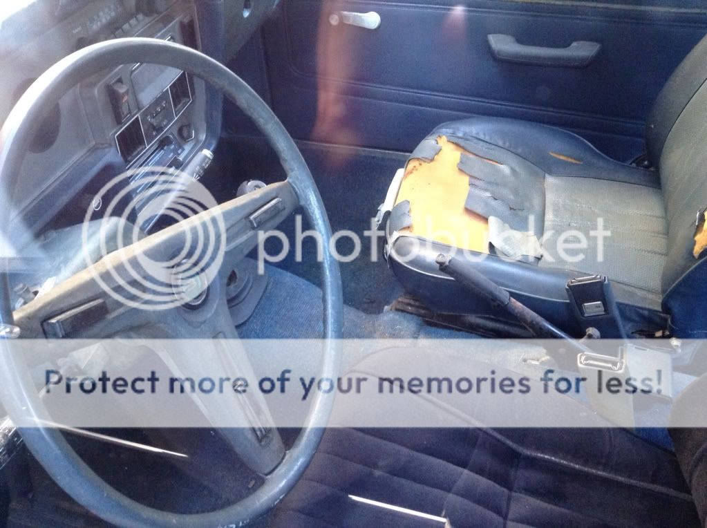

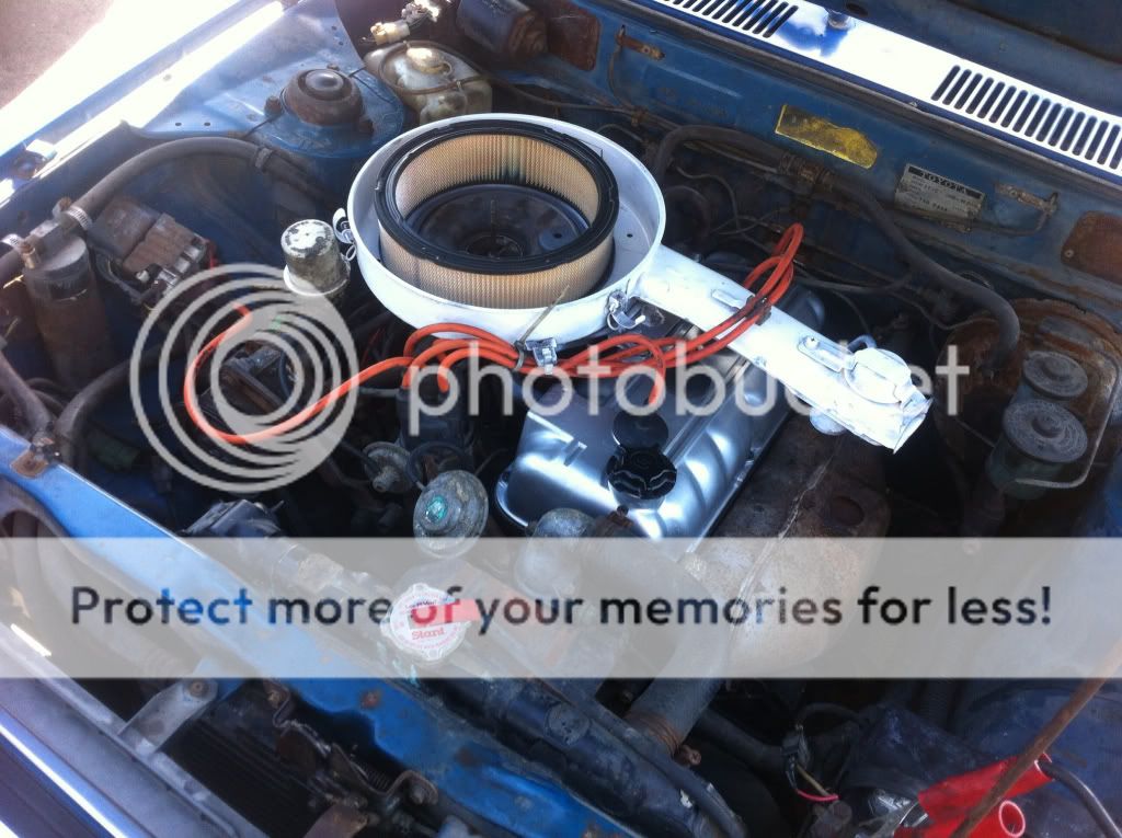

So all I did so far was sand down some rust spots and do a tune up... New wires plugs cap rotor fuel filter. I also took off the valve cover and cleaned then painted it along with the air cleaner... And for the interior I pulled 2 literally brand new te31 seats from the junkyard and sitting next to the corolla in the junkyard was a tercel with a grant steering wheel... Took my chances and took the wheel and boom! It fits perfectly haha... Also installed a new e brake and brake light sensor and e brake cover... Detailed the interior and cleaned up the inside (I know I need more pics)
I got the seats for $20 each and the steering wheel with hub for $7
I work for the state referee station (higher smog station) so luckily I can smog the corolla for free... Unfortunately the results were GROSS POLLUTER... Haha the previous owner claims he rebuilt the carb but idk... It's running super rich... I'll prolly have to modify the needle and seat... That's it for now... Oh the left front tire just went flat so I'm gonna see if I can repair it at work tomorrow... Thanks for looking guys!
Sweet! another TE31. Looks like a clean start. What are your plans? You have EGR, so its newer than mine. AC too!- nice.
Carb- I had the same issue with the original carb. I could make the car run perfect; so smooth that you could set a wrench on the valve cover and not be worried. The problem was that it was fine at idle, but once the RPM climbed it richened up. I scored a CA legal weber. If you figure out how to get the original carb going fill me in.

Carb- I had the same issue with the original carb. The problem was that it was fine at idle, but once the RPM climbed it richened up. I scored a CA legal weber. If you figure out how to get the original carb going fill me in.
My plans for it is to restore it as much as i can... I also want to lower it and maybe put new wheels on there.. I also want to try and drift it but I'm not sure if this motor has enough power to drift... But I'm not worried about that now... I'm more focused on getting the carb to run right so i can smog it. Where did you buy the weber carb from? I heard those are good... Do you think a weber carb would help with my rich condition?
A Weber will help with the richness. The only down side is that the smog legal Webers are no longer made, and are nearly impossible to find. I happened to find mine on Ebay mislabeled.If you went with another Weber, It will make the car run great, but they are not smog legal. Your plans are a lot like mine. Get it legal before major mods.

Wow... Yea I tried asking around today for places that do carbs and they said they don't carry weber carbs so yea... This sucks I wonder if I put a non legal weber carb on there if the smog people will be able to tell... I was thinking about rebuilding the carb but i don't wanna do all that work and find out it still runs rich... I tried adjusting the idle screw and when I hit the gas it just died on me,,, so I adjusted it back to the way it was. I'm kinda just stuck here at the carb part
Well ... if you have access to a letter / number punch kit you can make any Weber carb look like the one I have. Keep the stock air cleaner on top and pass the sniff test and you would be good to go.
