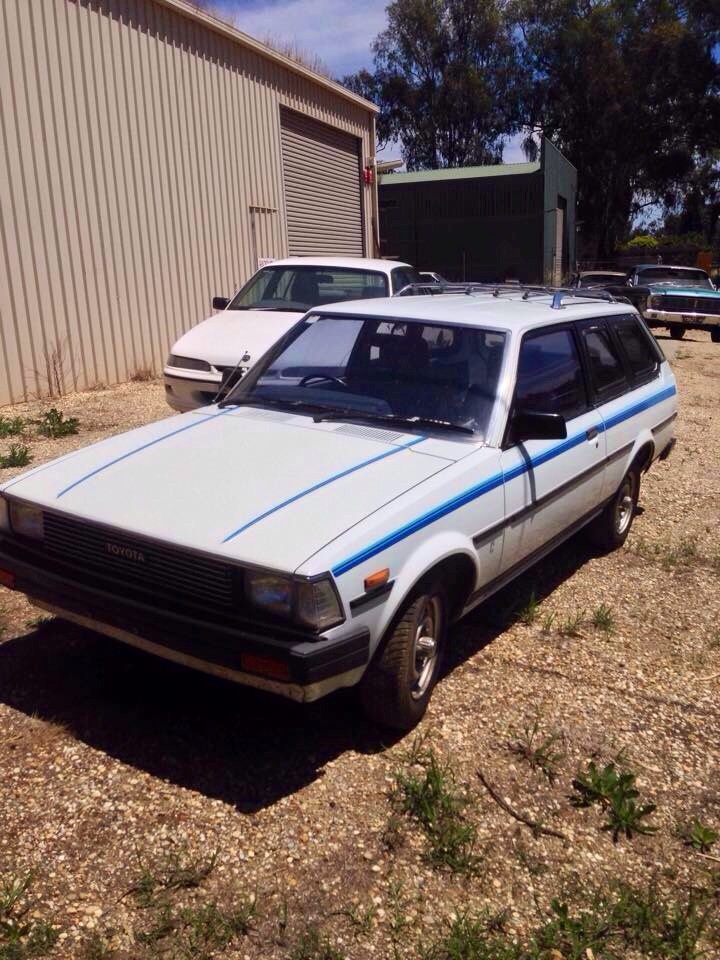

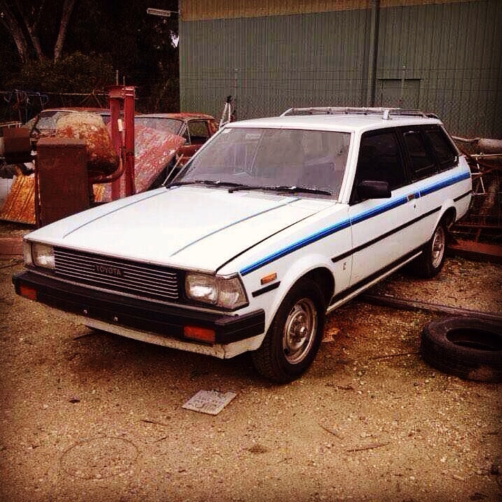

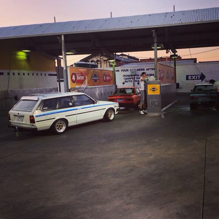

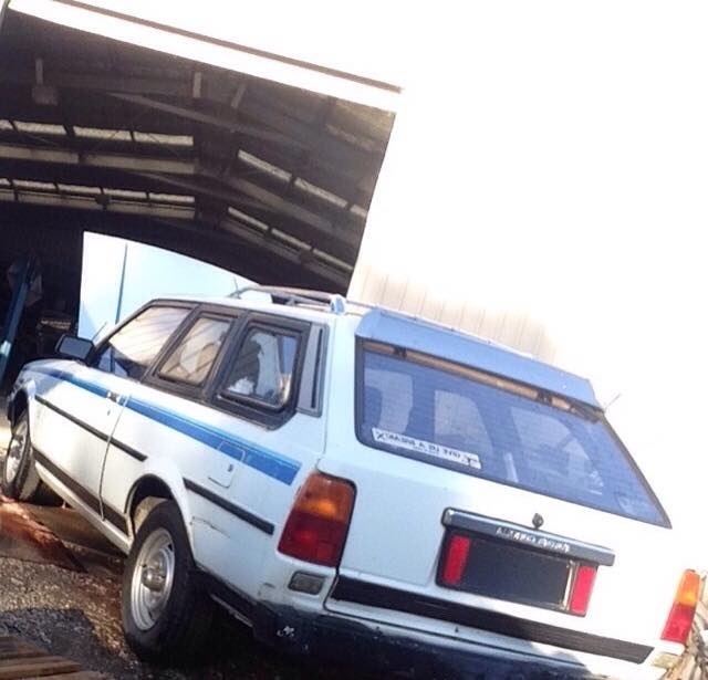

Recently aquired this gem from albury nsw sight unseen and drove it all the way home (ballarat Victoria) without it skipping a beat and went about getting it up to road worthy spec and making it my own.
And then after getting it road worthy fitted some reset leafs I had acquired and some choppies till I get my corona struts sorted and chucked on a set of ssr formula stars I had holding up my ke25

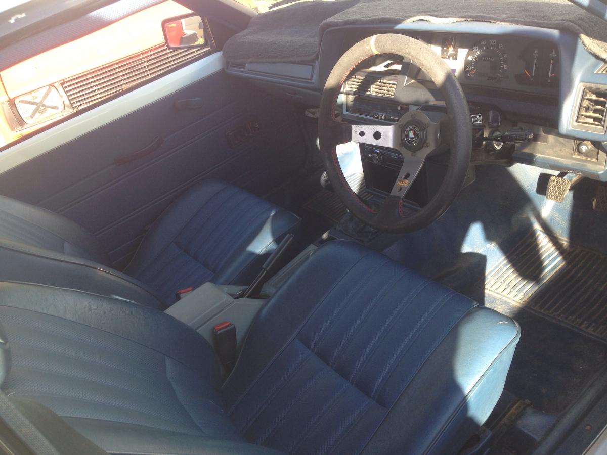

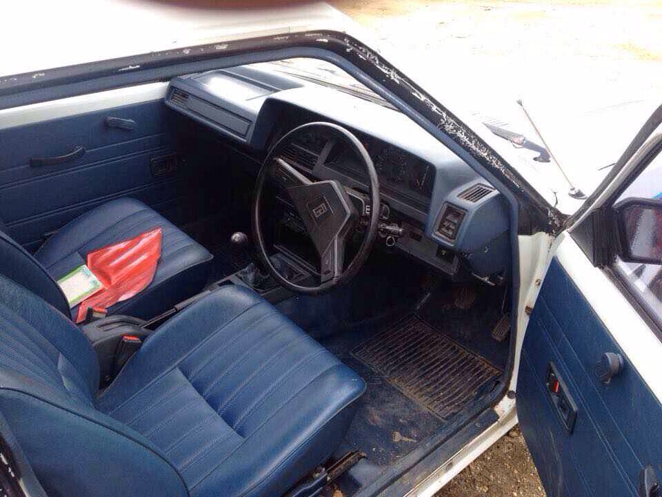

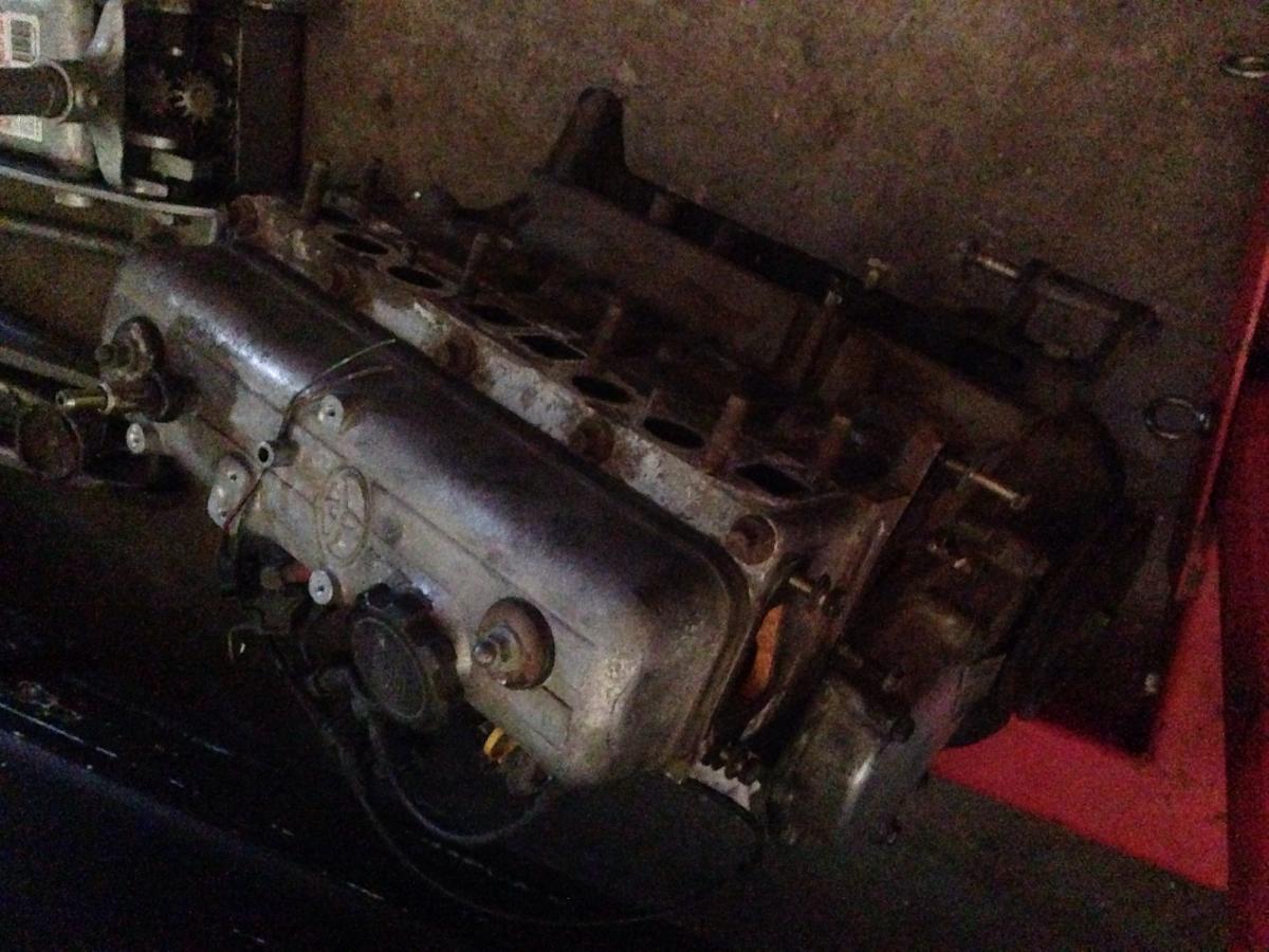

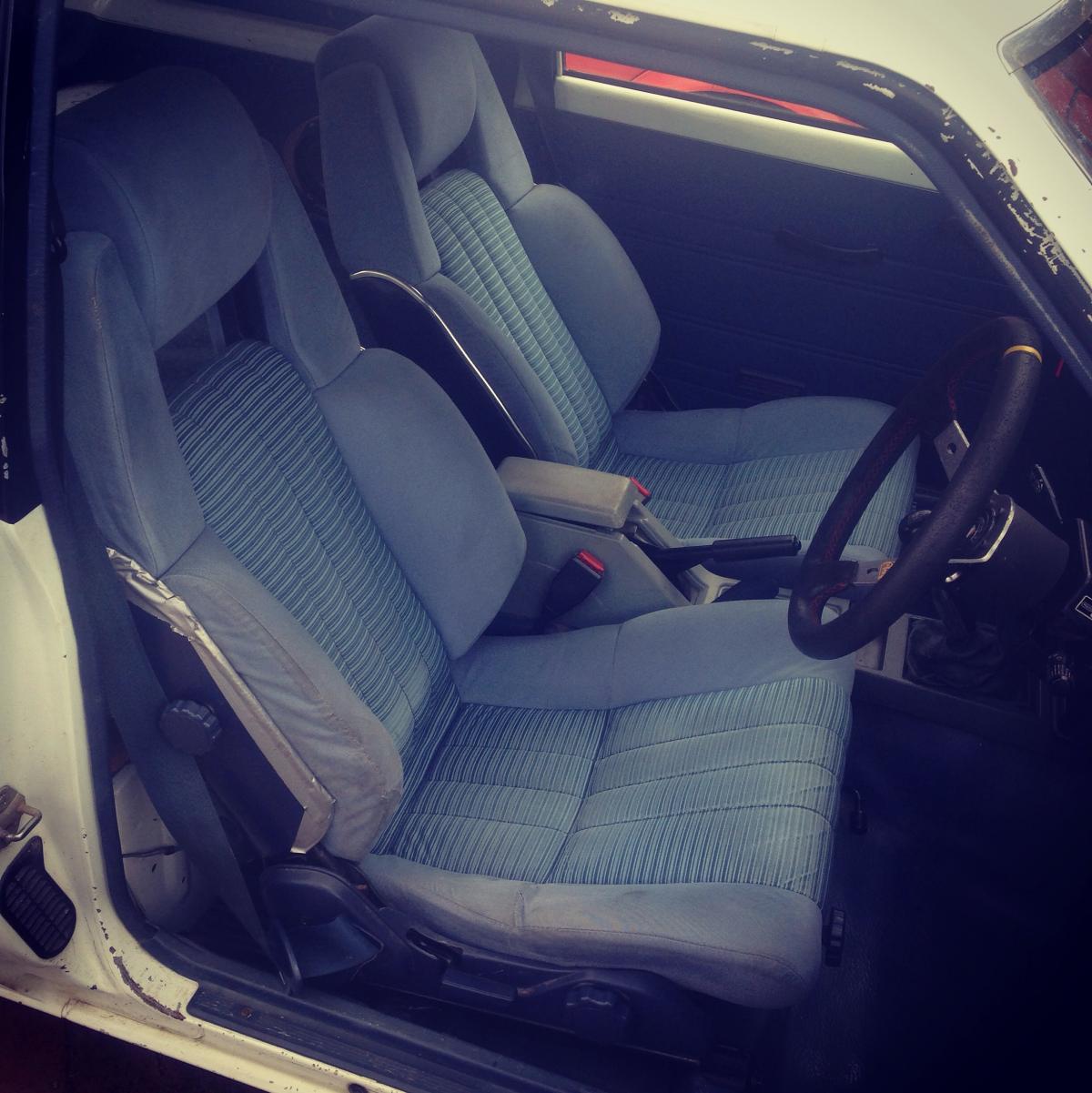

Next on the list of things to do is swap out the terrible standard vinyl seats for some velour ma61 items and mod the sump on this sucker and chuck her in

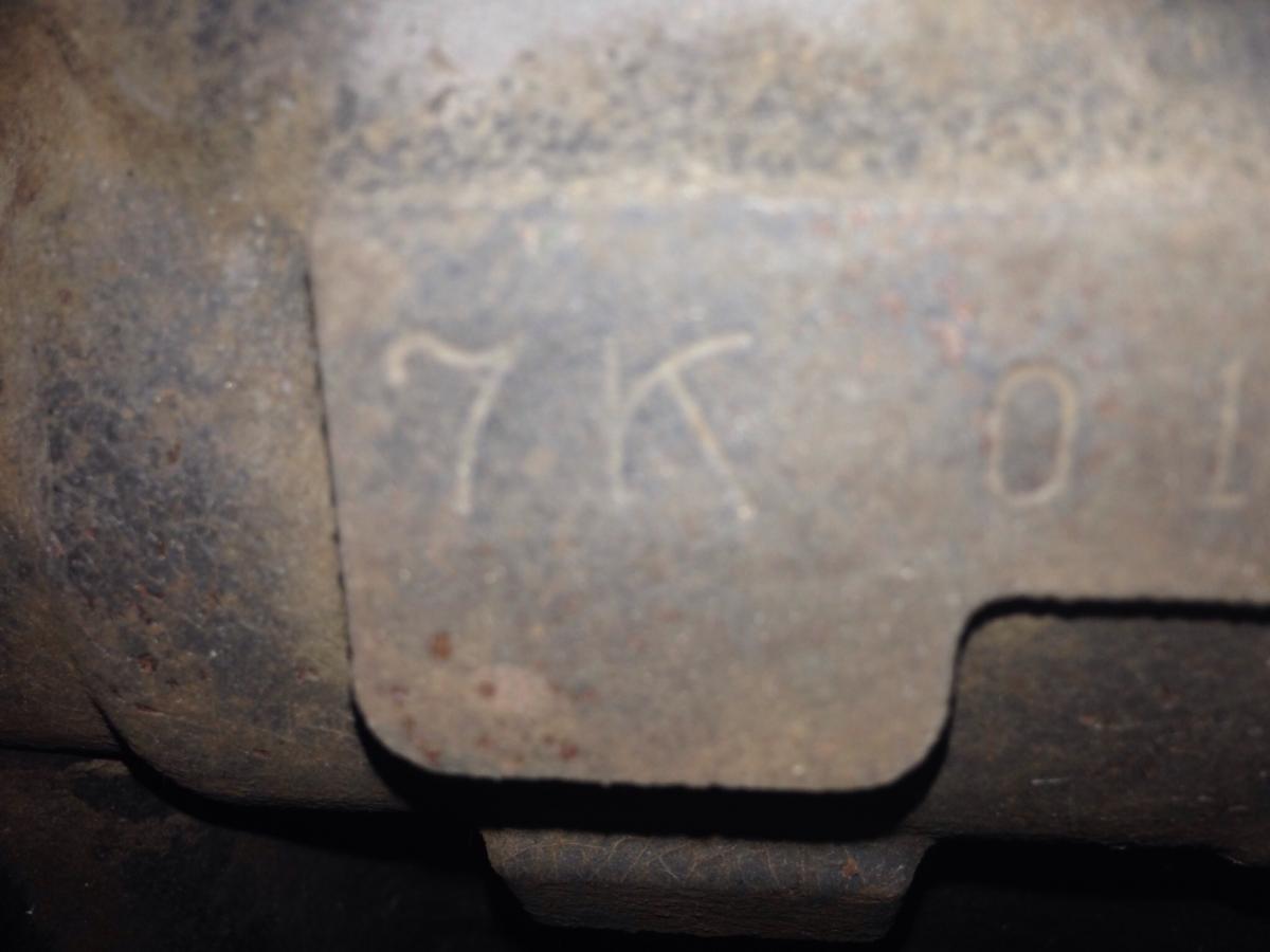

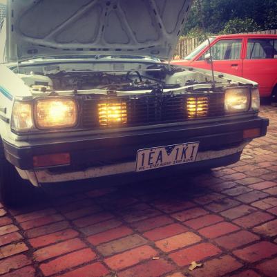

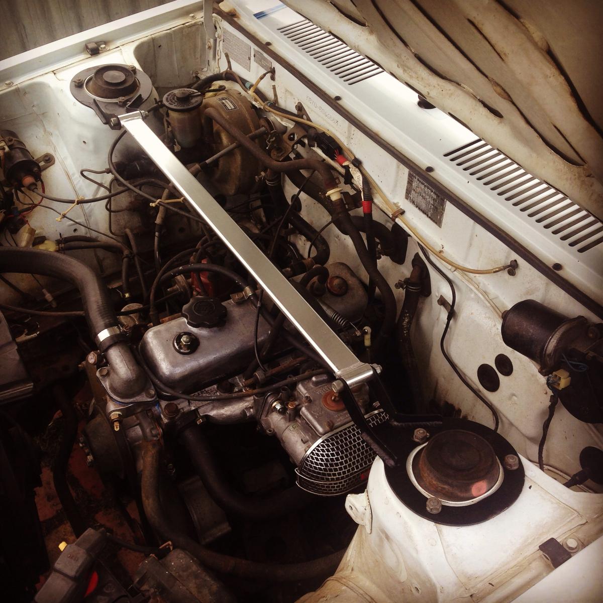

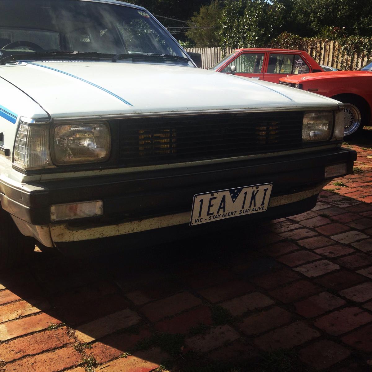

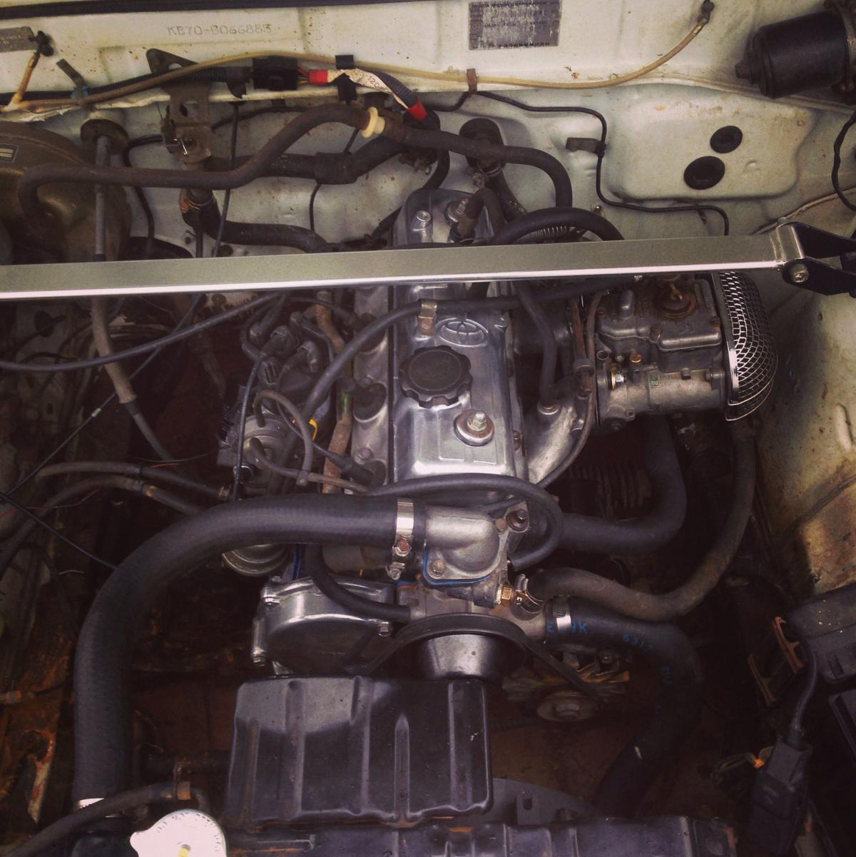

She's now 7k powered! I also had some genuine Toyota foggies kicking round in the shed so chucked them on aswell as some eBay clear bumper indicators. I managed to find some seat rails for the ma61 seats iv had sitting around so they went in too.
This thing is cool, I love the blue pinstripes. Hows it go with the 7k? Using k50 gearbox?
It goes great so much toque for a k motor haha I recently got the exhaust done so now has a nice 2" system with a high flow resi and muffler absolutely loving the sound of it it's making a great daily next on the list is some 4.1 diff gears to liven her up a little more I'm hoping to get them in before the weekend as I'm hitting the 1/4 on Sunday for abit of fun! I replaced the whole front end with rt132 corona struts short stroke shocks, springs, brakes and lcas and a pajero master cylinder so she stops and turns now
