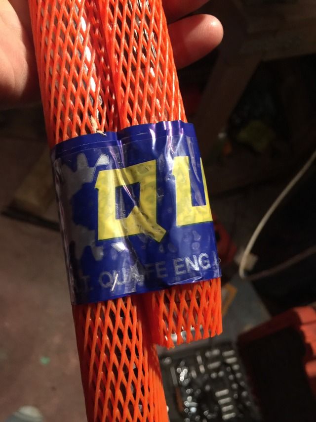

They other thing i did the night before my event on saturday was put in a quaife quick rack, this is one of the coolest mods i have done so far and makes such a huge difference, the steering is now 2 turns lock to lock rather than the standard 3.5 and it drives like an absolute go kart, check out the video below and see the minimal steering input compared to my previous videos, it is much much safer to drive hard.
The rack is a AE86 quaife quick rack and pinion from palmside.co.nz and was very easy to modify to go into the starlet rack, its very obvious when you put them next to each other but all it needs was i think 32mm off the long side of the rack to make it the same length as the starlet rack, then drill a new hole and tap it in the end for the rack end to screw into and your sorted.org.nz. I got a new bearing for the pinion rather that try deal with swapping the old one over.

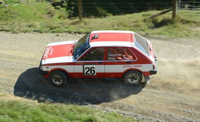

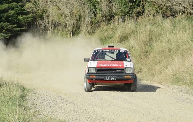

Saturdays sprint was a 4.9km gravel sprint on Tararua road, run by the Danniverke car club. It was good to have Rhys there in the KE20 to have something to aim for and bench mark myself against. The car was struggling with gearing again, 2nd gear was to slow in road speed and high in the revs for a lot of the flowing stuff but the car was bogging and not revving in 3rd, it needs either a 5.1 diff and ignore first gear or a close ratio box quite bad, watching rhys's video i can see how the box helps so much (apart from getting off the line). I was super stoked to be close to him in my first run, then actually got about 4 seconds on him in the second run but he put down a solid 3rd run and got me by 3 seconds. I'm really happy to be close to him like that tho and it shows the changes to the car have helped, also stoked that the both of us took down a couple of 4age powered cars in our little 4K's.
well here's a few photos courtesy of Jeff Wells, ill buy some final res shots off him at some stage.
