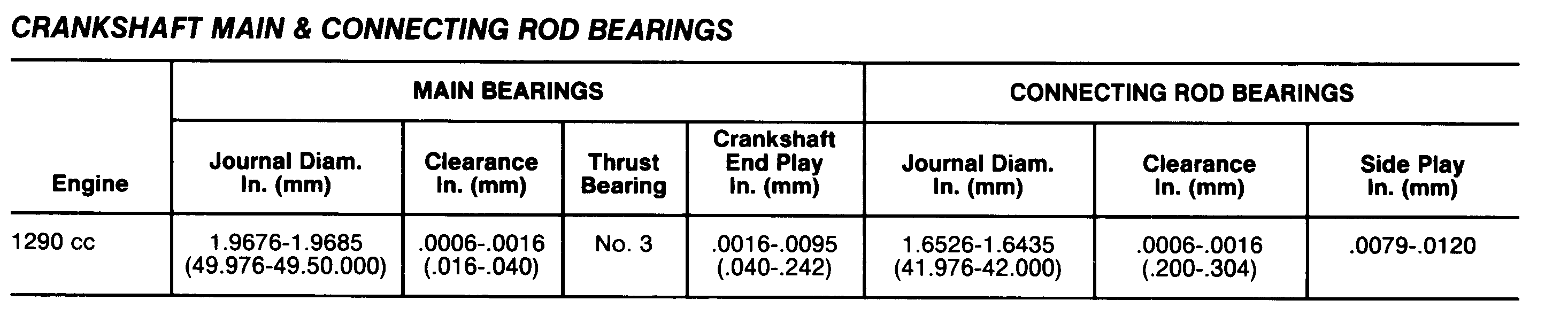

however not everything will be this loose, the mains are probably fine, the big one is the conrod bearings.
This engine has an insanely loose conrod clearance figure, some docs state 0.1mm and some state 0.3!! look at this! that would be enough for me to wiggle it around with my hand in the sump and clearly feel it.
I suspect that is where my pressure is going, but they do this for a reason, they want oil to exit and spray out the side of the journal to the piston squirters to keep cylinder wall temps down.
It also allows for this is why 4ks go forever.
note that our conrod journal is smaller than our main journal, so you would think the clearances would be smaller, but no, toyota are up to sumthing with this engine.
Normaly, as arule of thumb you add clearance for every increase in size of journal.
I guess rules of thumb shouldn't come in to play with engineering. theres obviously some reason for it.
