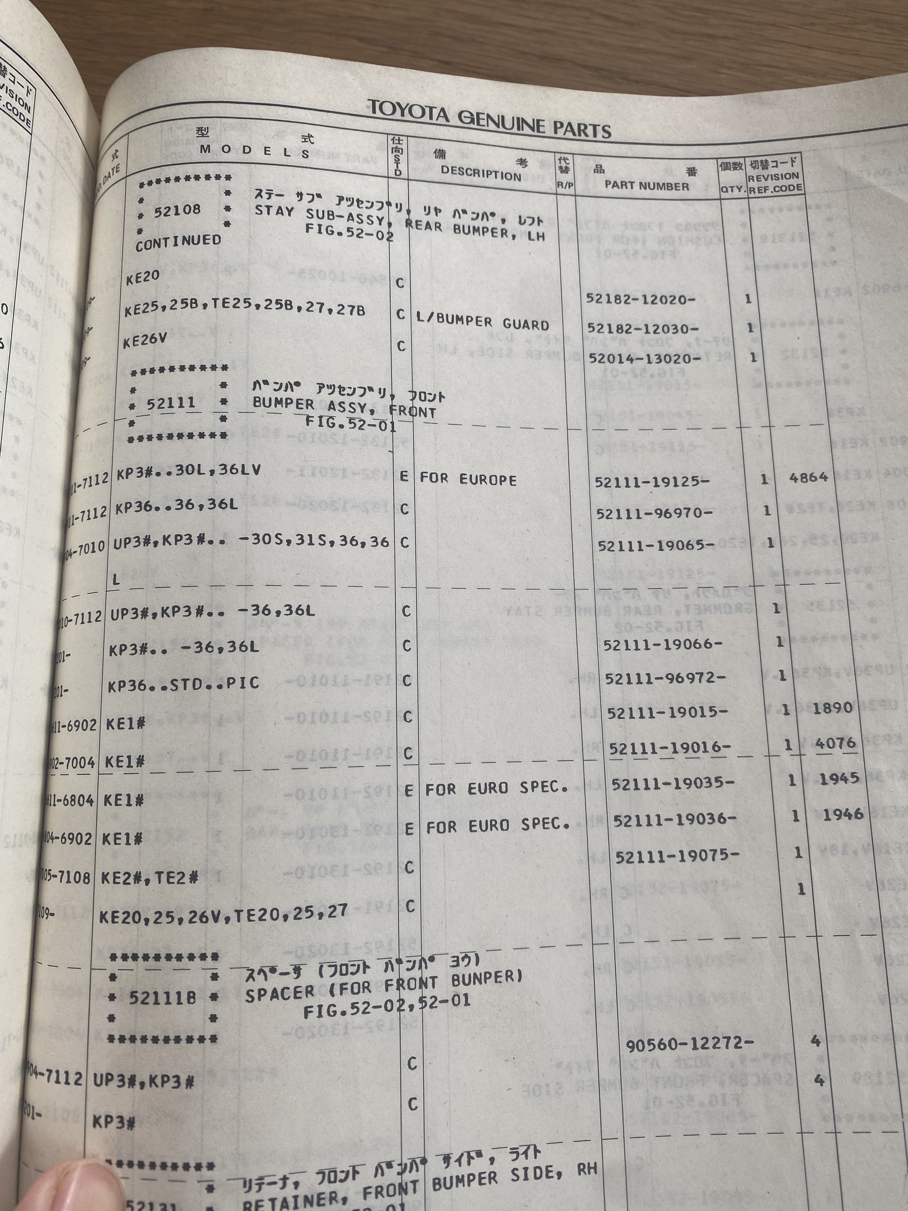

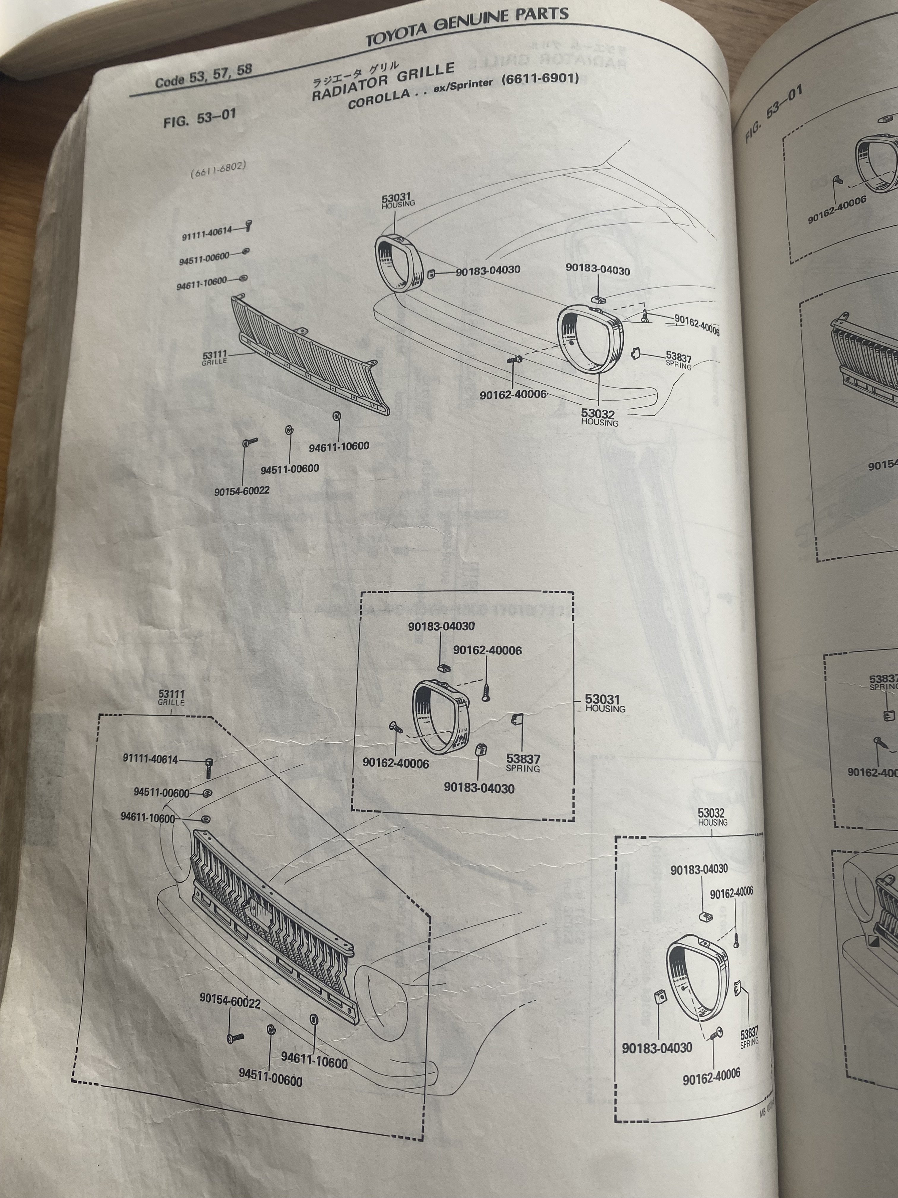

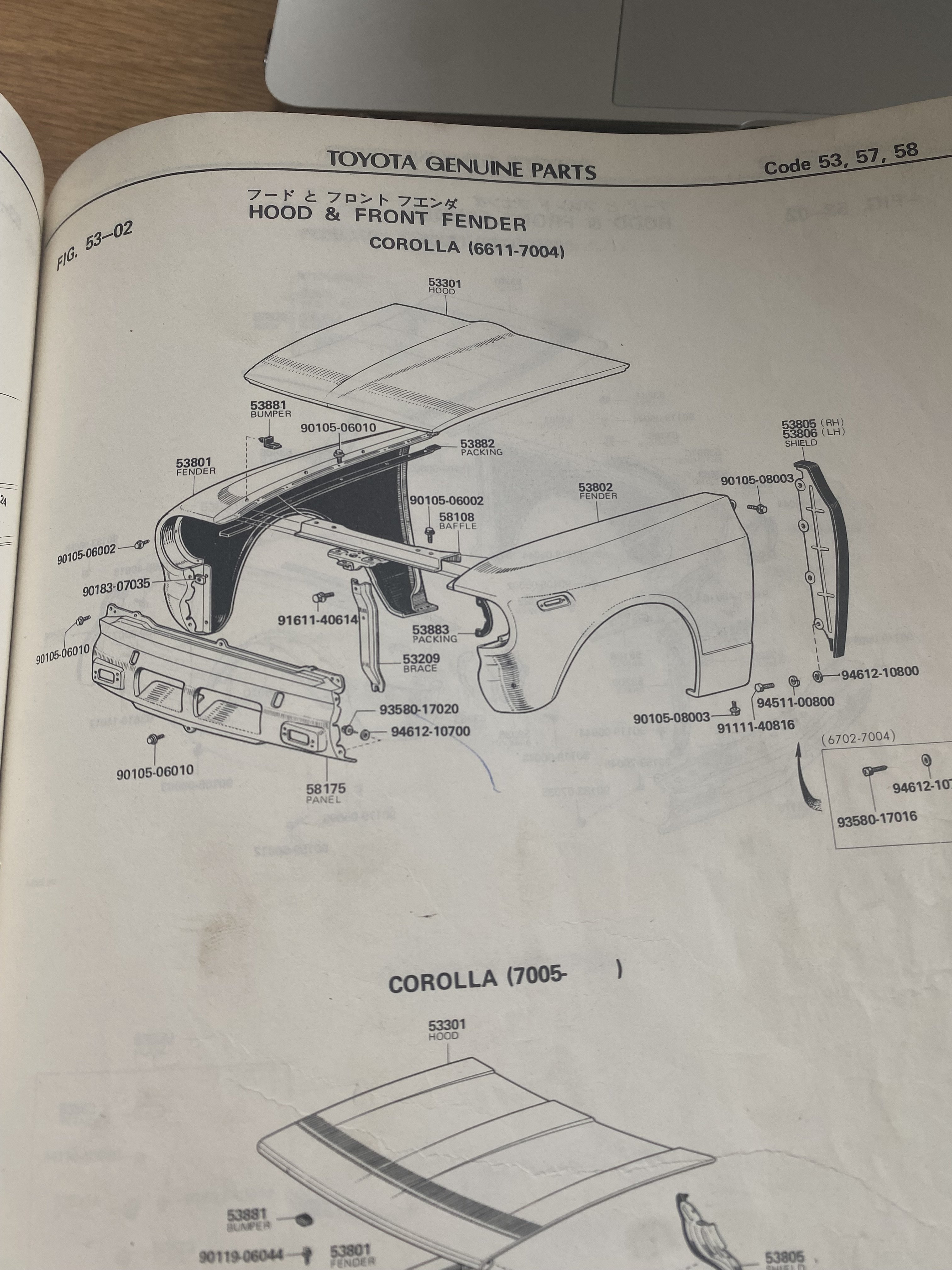

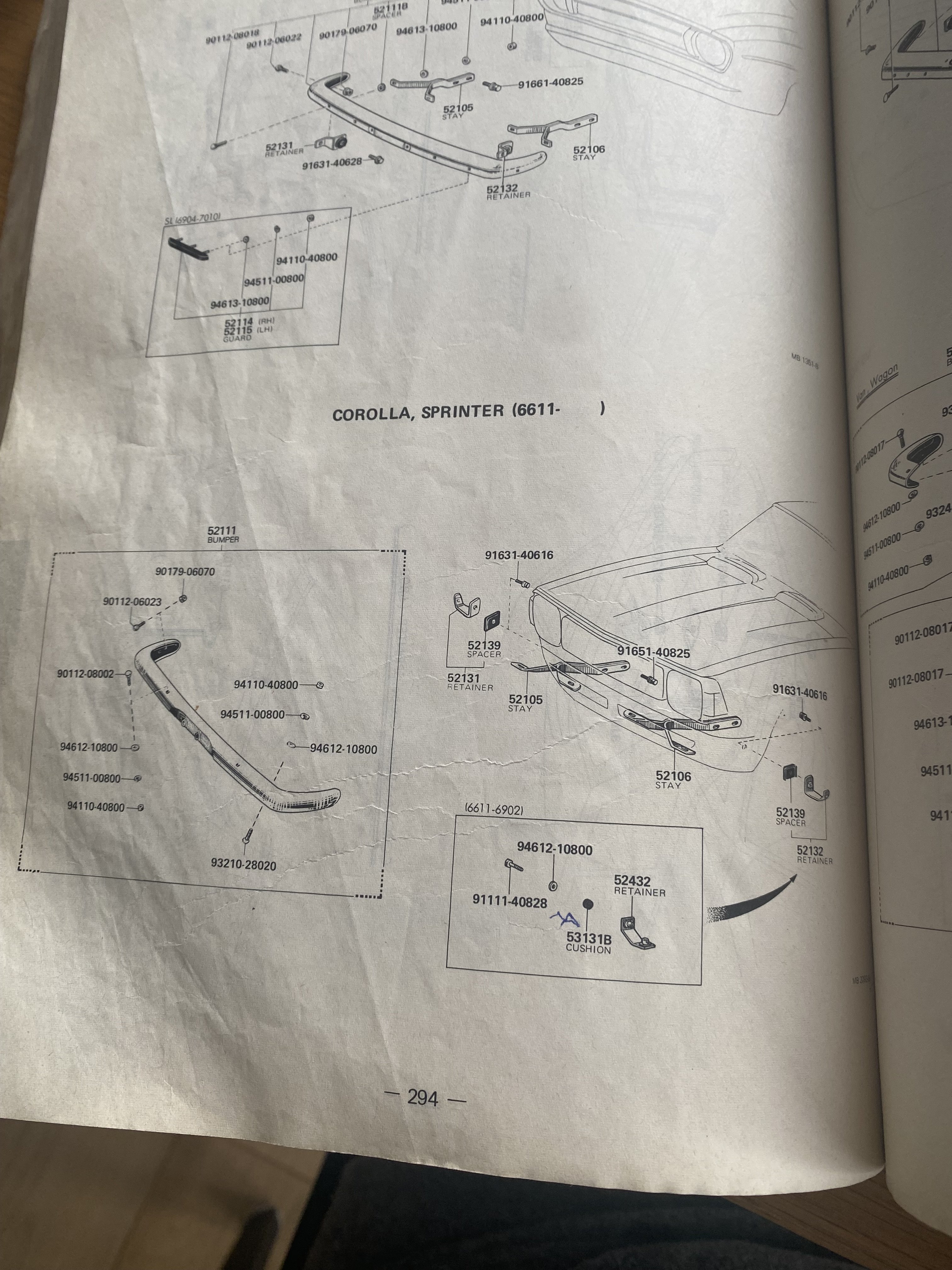

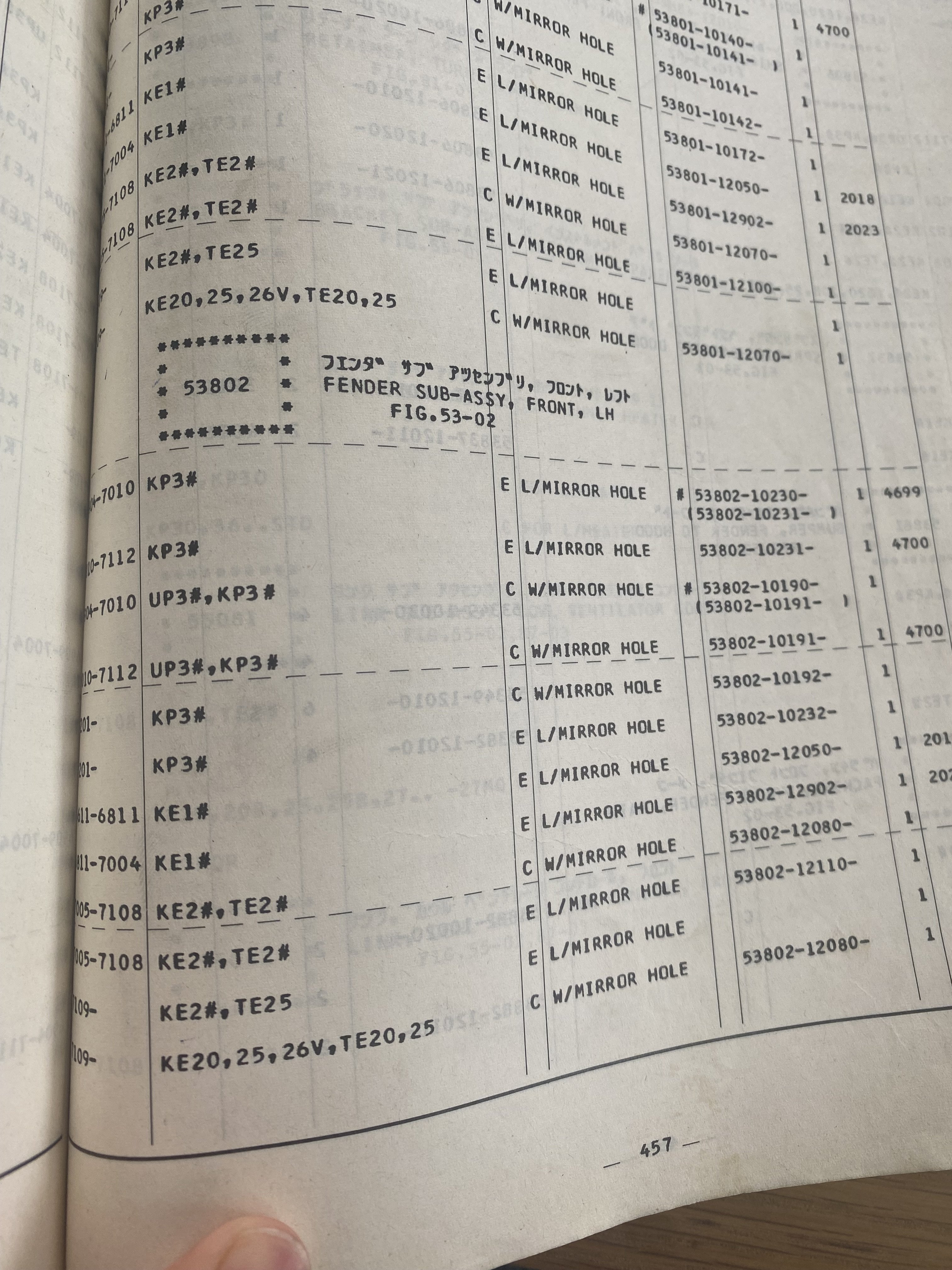

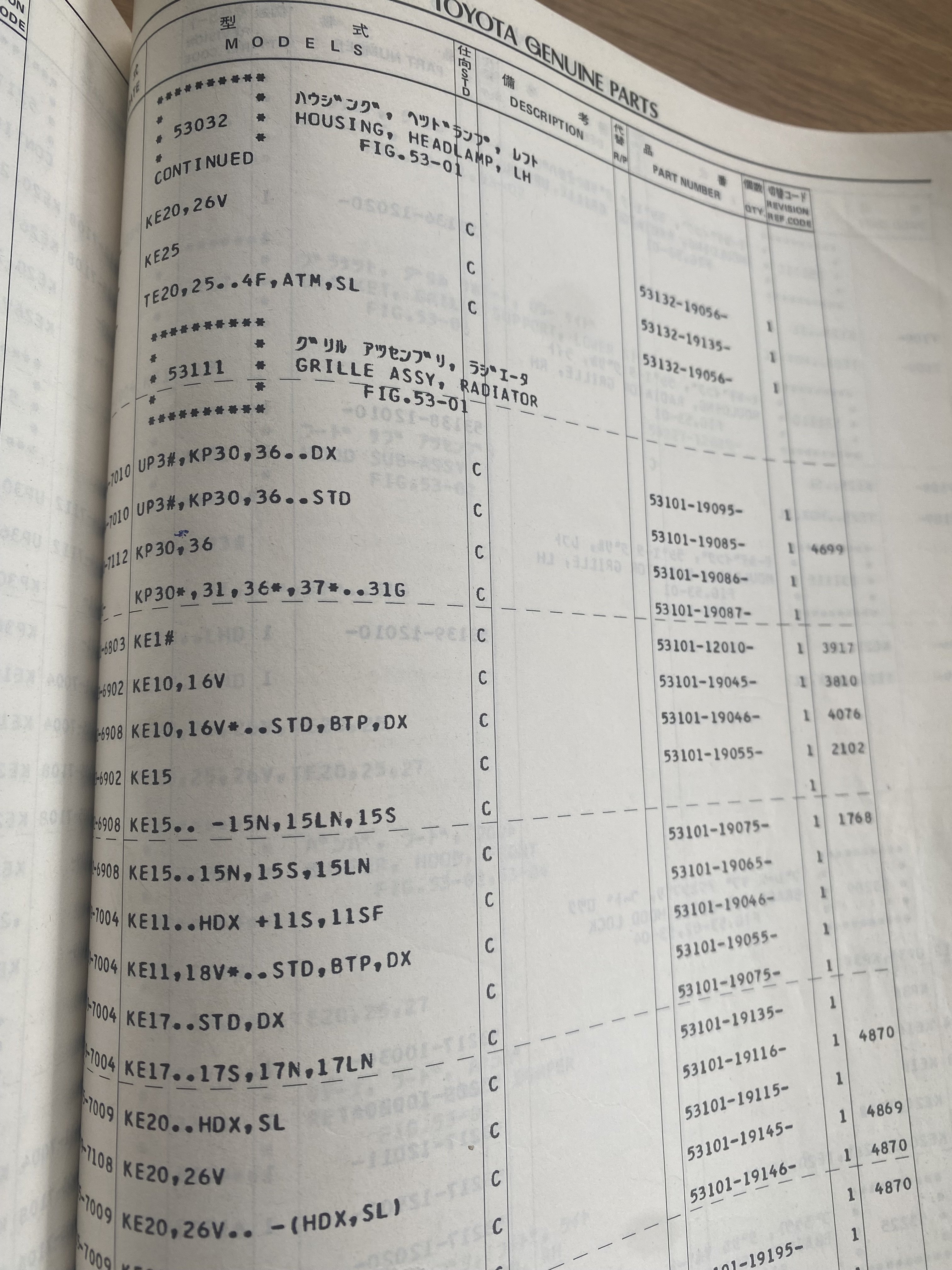

Note the change in specification after certain dates.
Don't forget you will need bumper irons.
Don't assume the pictured grille is correct for your model, but does at least indicate the various other bits of hardware required.
Note the reference to "euro spec" for the front bumper.  I have no idea how they differ.  But you are unlikely to find them anyway.
